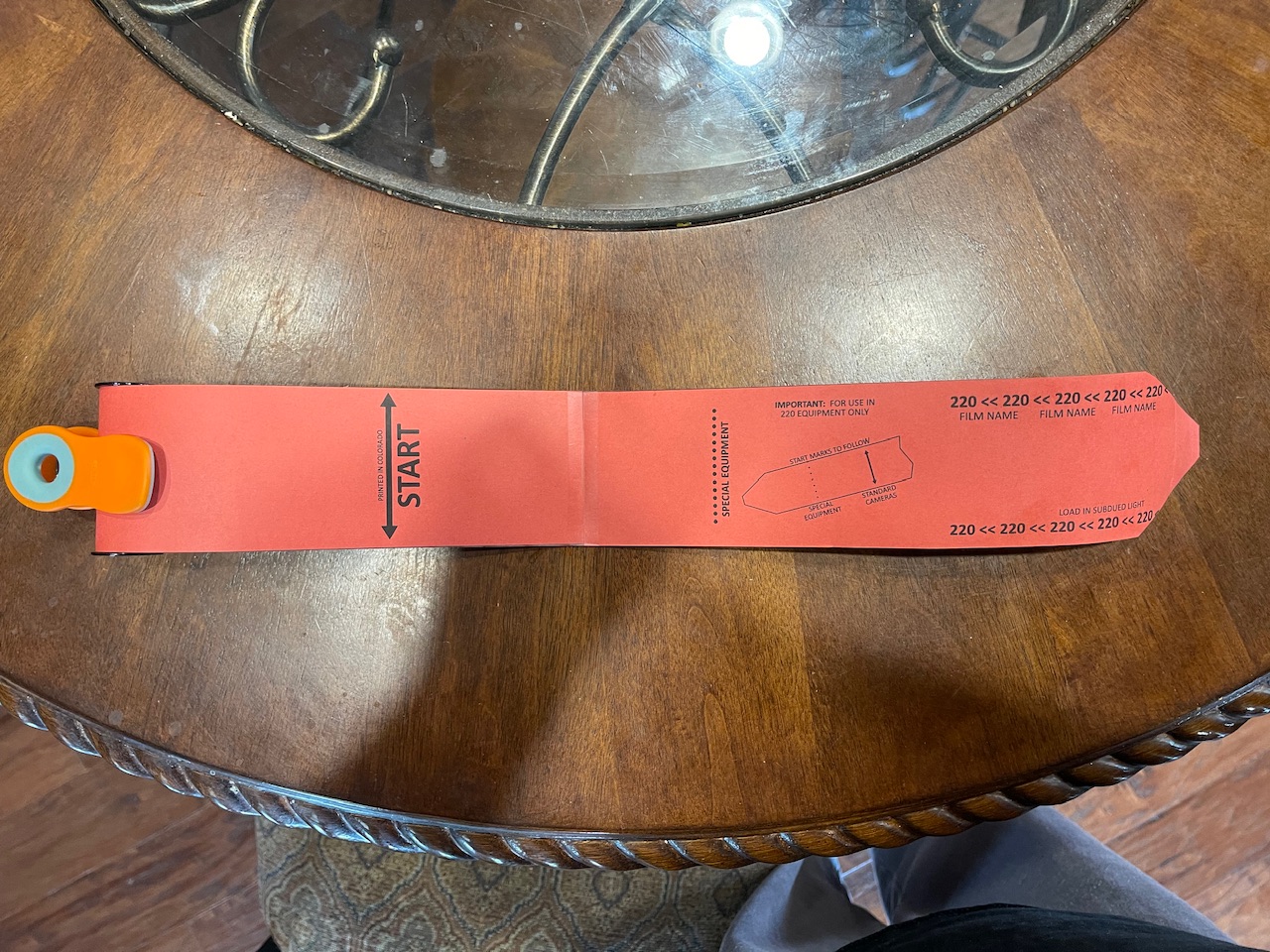

Are you putting inkjet ink on the parts that will contact the film, or only on the ends? My concern would be a reaction between the inkjet ink and the film itself, as the former is less stable than something such as acrylic paint.
+1 - inkjet frame numbers would be an invitation to wrapper offset issues!

If I figure out a way to slit the paper, then I’d love to sell paper in widths that could accommodate that. I couldn’t print anything on the paper, as my printer can’t do long rolls, and as mentioned inkjet ink wouldn’t work well in this case.
Nope, that’s one reason why I feel comfortable making 220 paper like this, there’s no ink in contact with the film. That, and I can print it onto a single sheet of paper, cut it into 3 strips the right width, and tape the 2 strips that make up the leader together since that join doesn’t need to be light-tight.
With the 220 format this problem is minimized.
So far, Epson Ecotank black ink does not exhibit this problem when fully dry on this paper. Test started in December.

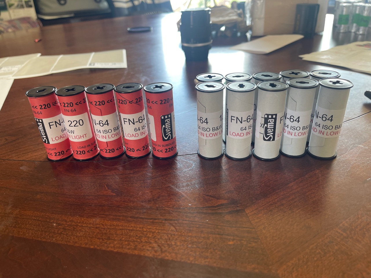

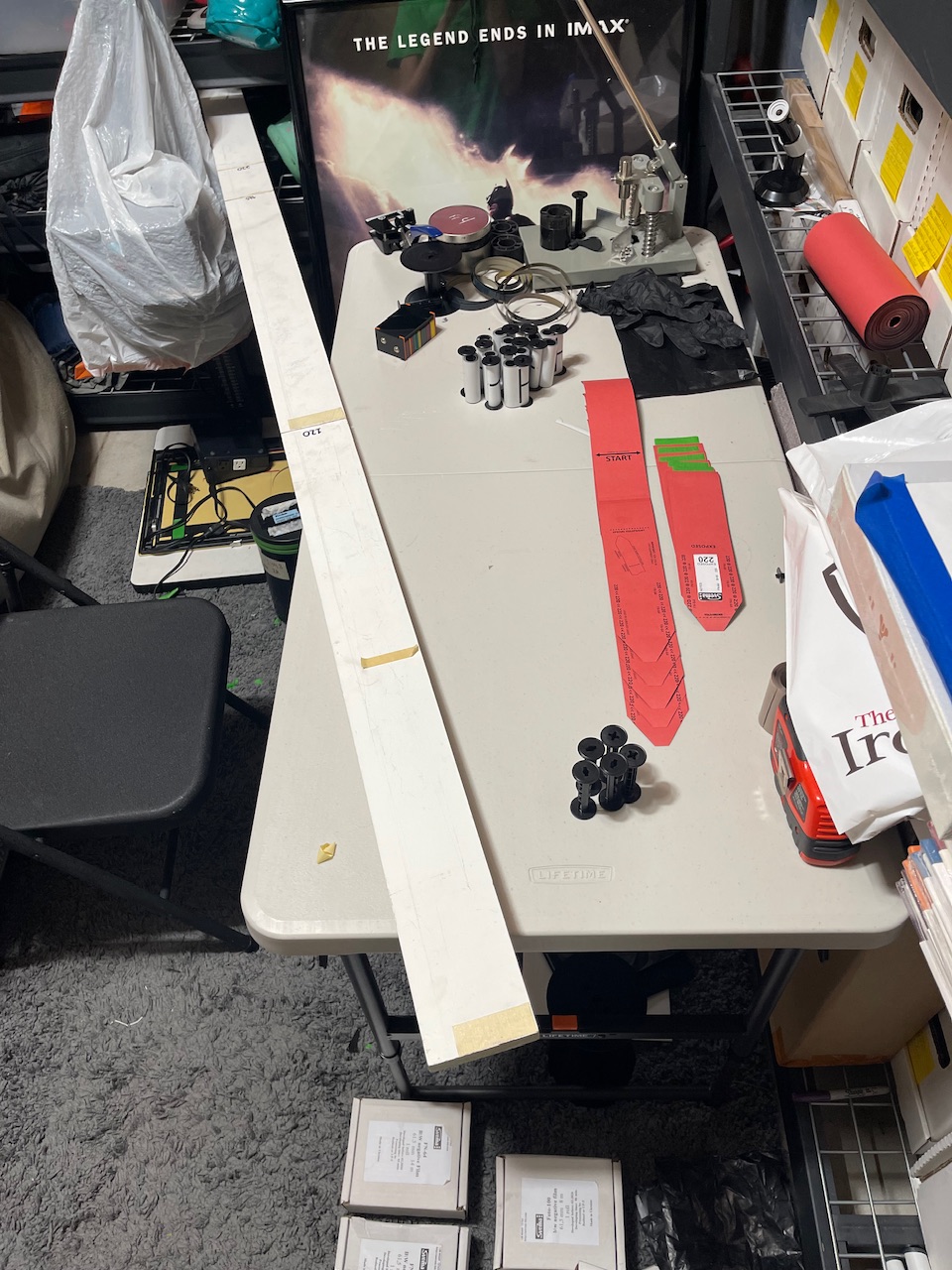

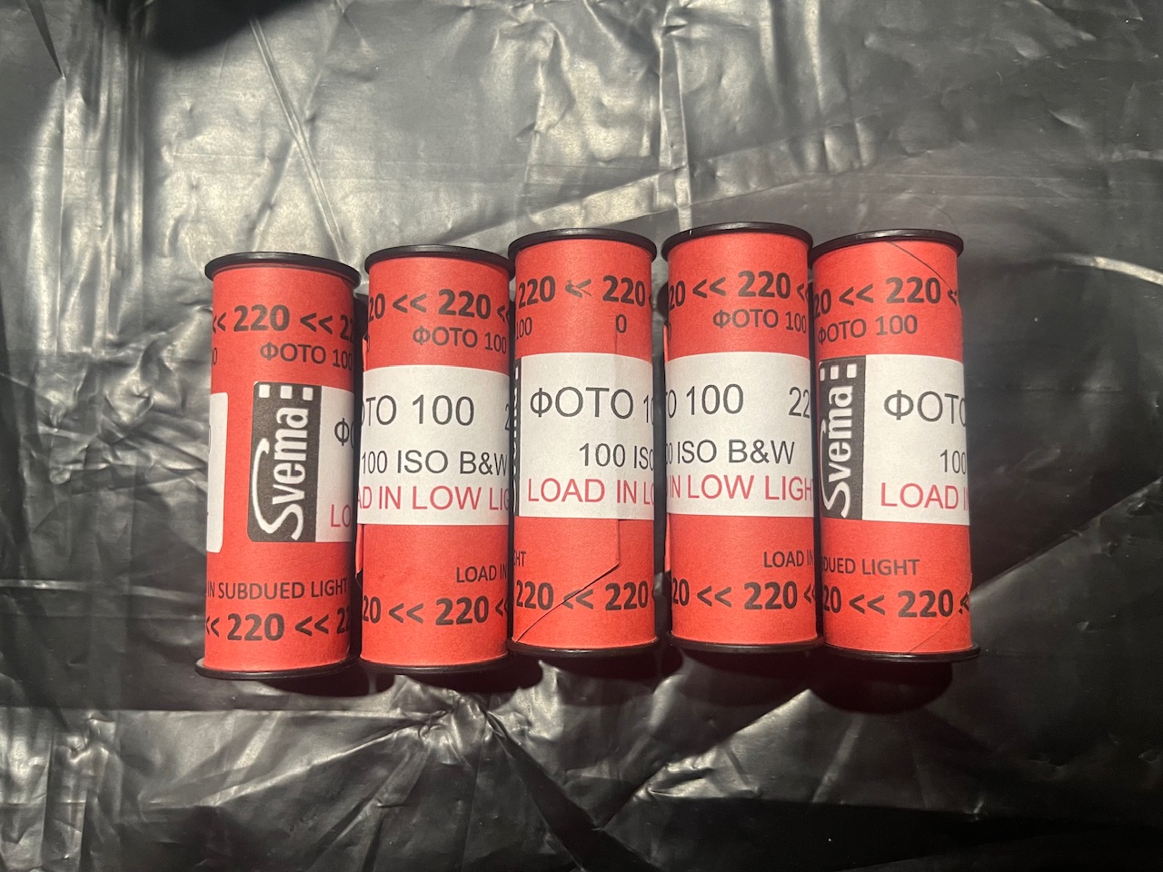

Made some film with the red backing paper today, 5 220 rolls. The 120 is still rolled on recycled paper but I have had great luck with the 220 papers I’ve made so far.
