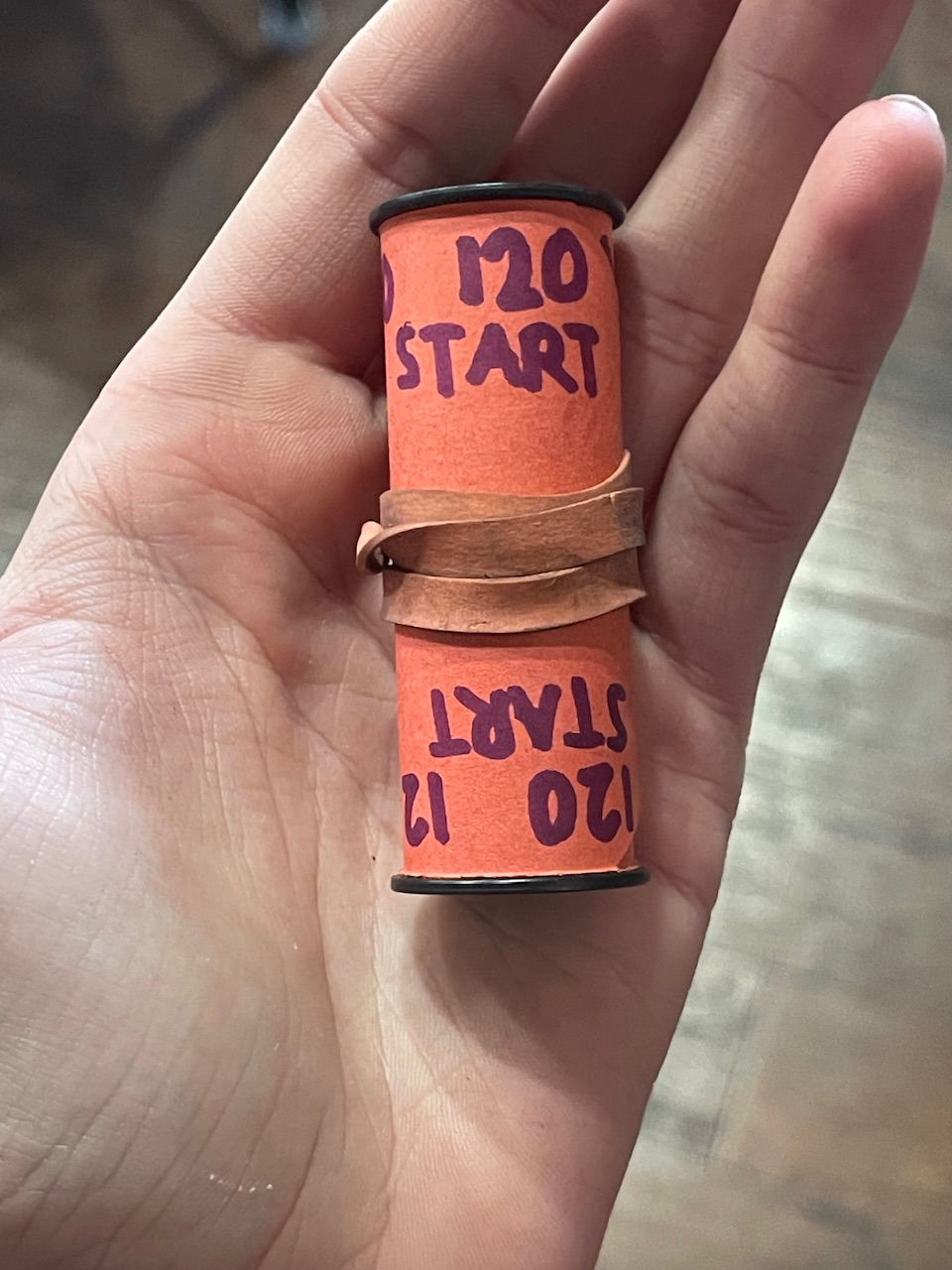

Paper backed roll film made with backing paper cut at home.

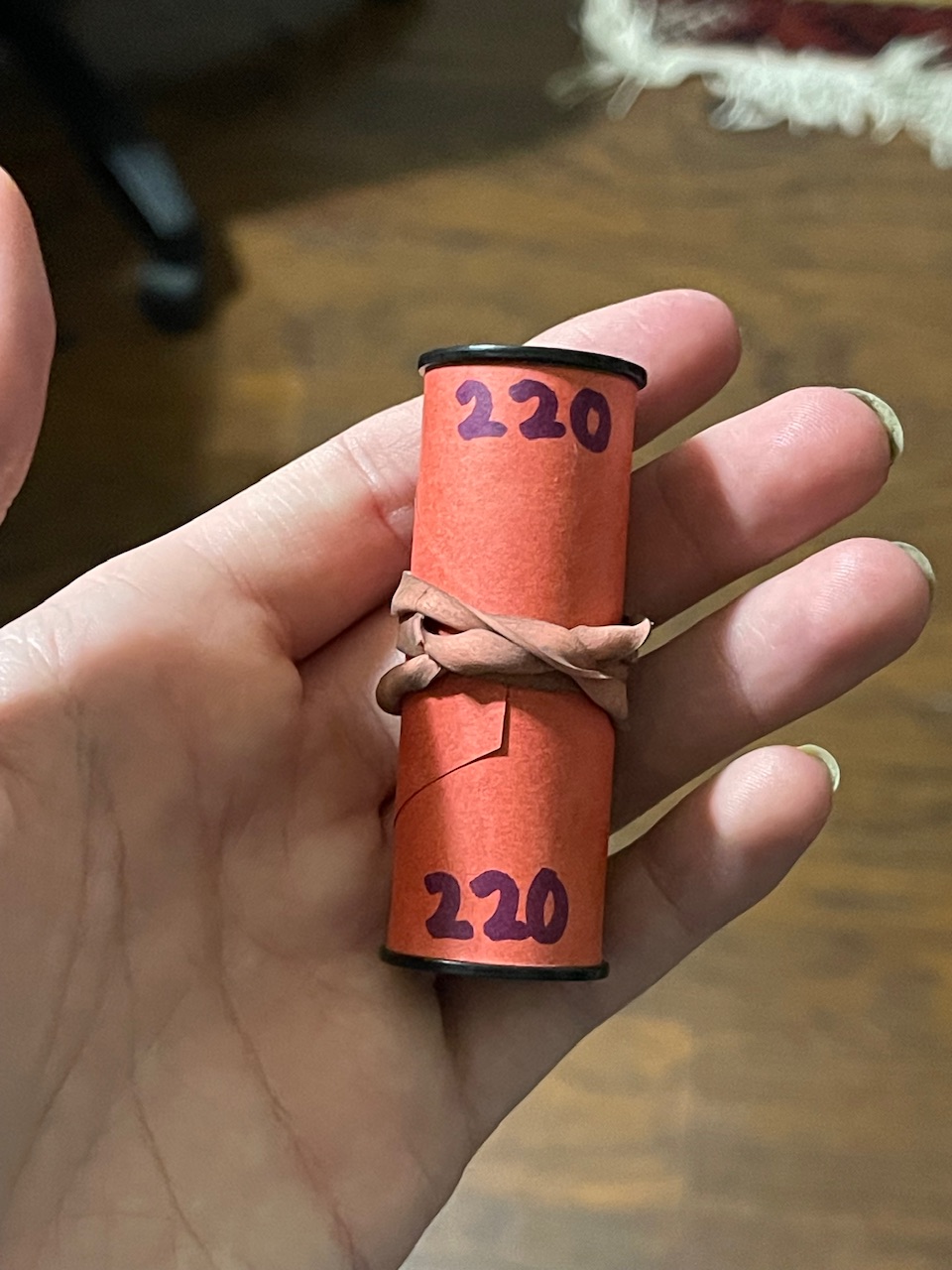

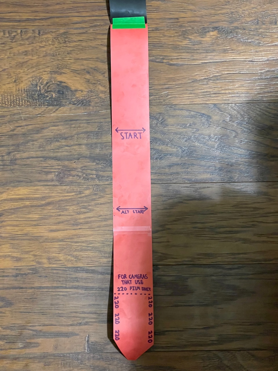

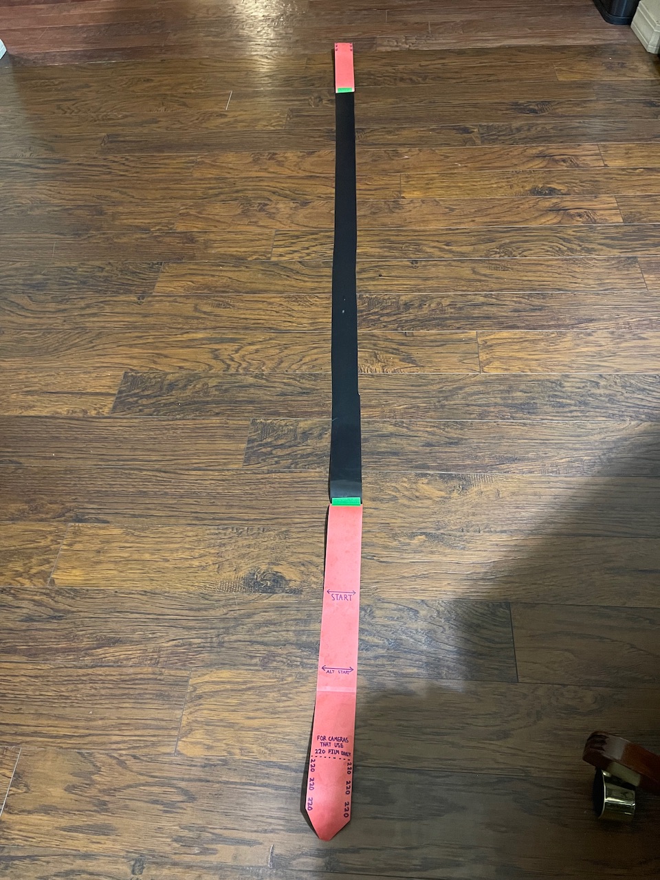

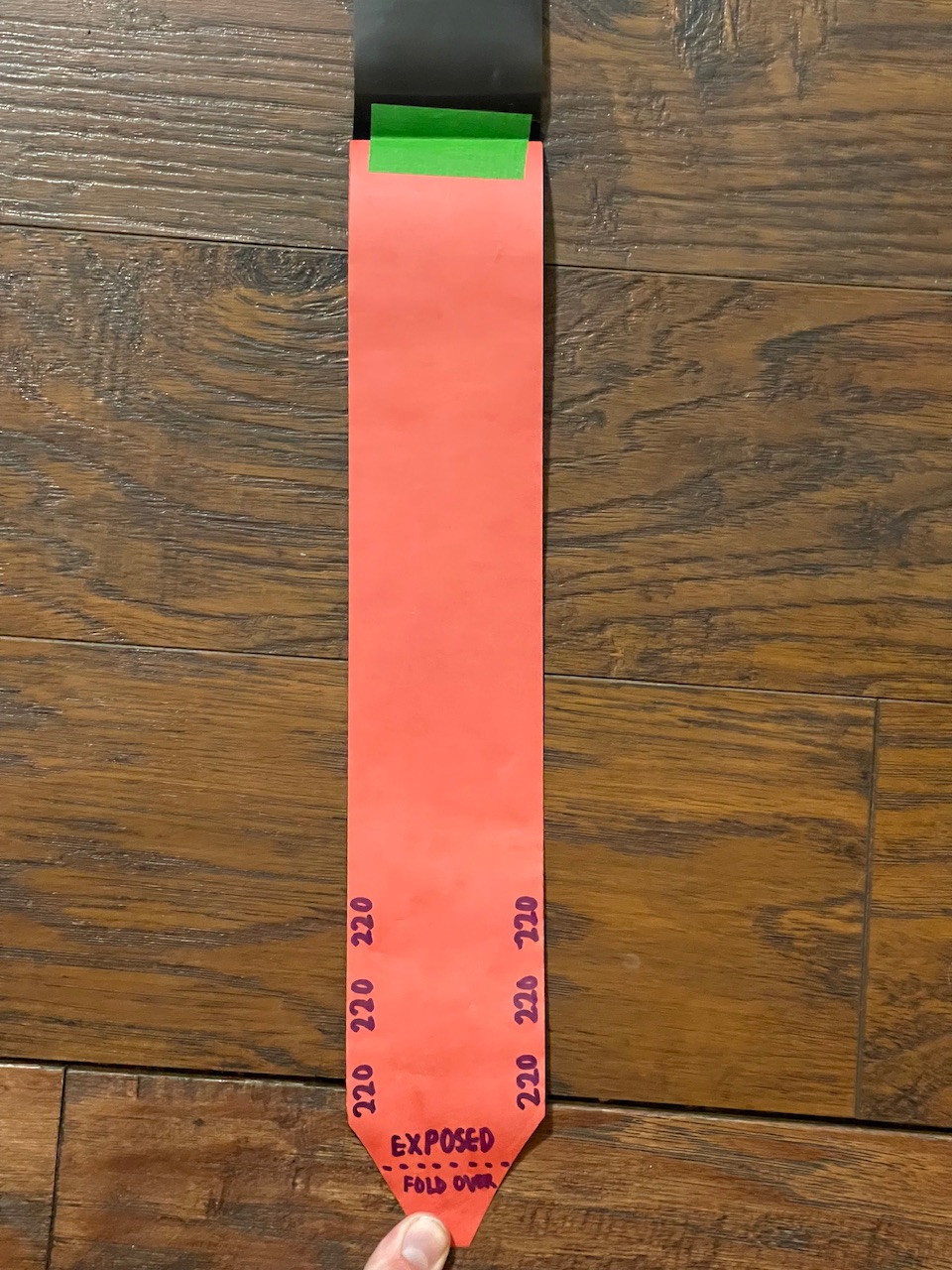

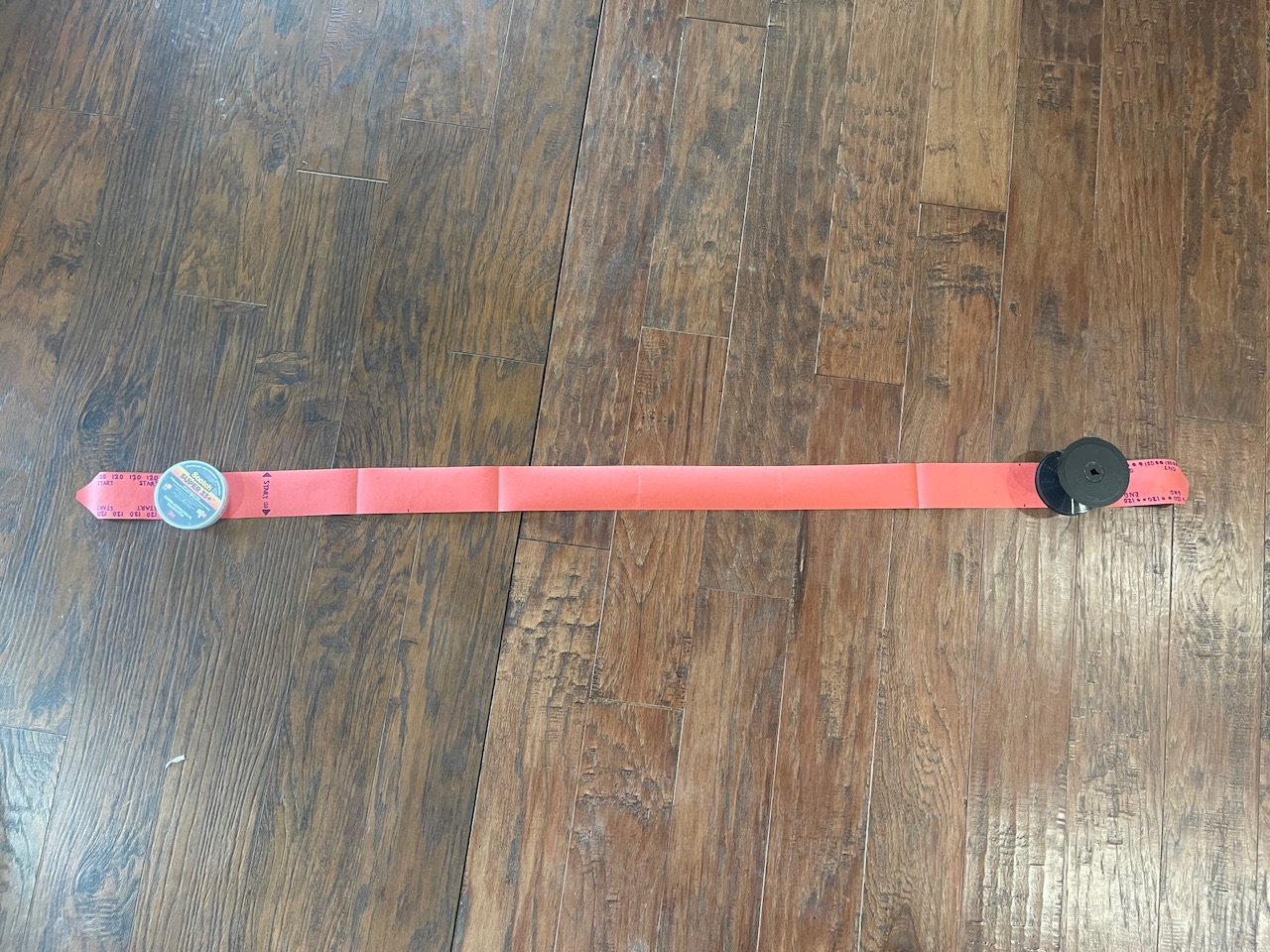

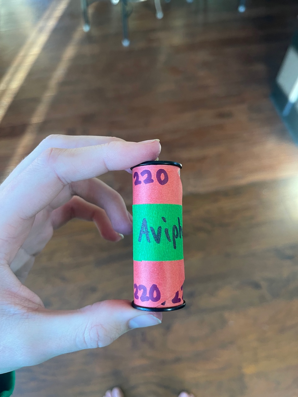

I made some 220 leaders and trailers tonight, I cut them on my rototrim since the lengths are much shorter and the one join between lengths doesn’t need to be light tight… maybe I’ll get around to putting real film in it at some point, but I’m not really in the mood to go in the darkroom tonight. Too tired. But in theory this should work just as well if not better than the 120 I made.
Do you believe that masking tape will hold the film in place at 220 format?
No need to even put it on both sides, masking tape is essentially what is used at the factory. Just a single piece works fine. I have used it for every MF roll I’ve ever made and it works great.
...which limits usefulness for old folders, TLRs and box cameras with a film advance window, but not the 120 cameras with geared advance. I'm curious what percentage of 120 film is shot on cameras that require frame numbers? I've got many 120 cameras from 6x4.5 to 6x12, and the only camera with a film advance window is a wooden pinhole camera that I haven't used in years. I know many will probably want to argue this, but I wouldn't bat an eye if all 120 film stopped having any printing except the start arrow (which isn't close to the emulsion.)
Even among "quality" cameras, there are still some out there that rely on the Frame 1 marking. A lot of older Rollecords were this way-you advance until you see 1 in the ruby window, then press a button to start the frame counter.
I regularly use Hasselblad "12" backs, which will work with any V system Hasselblad, and those also require manually starting the frame counter when you see frame 1 through the peephole in the back. Hasselblad made these until somewhere around 1969/1970, so there are plenty of them out there even though most people(myself included) prefer the later "Automatic" type backs.
I've had a few other cameras that worked like this. One particular Zeiss Super Ikonta that I stupidly sold a few years ago did. For some reason I'm thinking it was a model 636/16 but don't hold me to that-it was a 6x6 format camera, coupled rangefinder, f/2.8 Tessar in a Synchro-Compur shutter(and with the weird quirk of the automatic frame counter only going to 11-there was a way to get it to shoot a 12th frame, but about half the time it was right at the edge or off the end for me, so I would only chance it on one I didn't care about).
As the film goes around a sharp bend in a back like Hasselblad or Bronica, with no tape on the back, the film can peel away from the masking tape in 220. It can't happen in 120, really, but very easily in 220, since the film is more rigid than the tape.
You risk gumming up a back by not putting tape on the reverse of the 220 film.
I’ve been doing this for almost 3 years now, probably used around 20 rolls of 220 myself and sold something like 75, if it was an issue I would have heard of it by now.
Mass produced rolls used almost the exact same tape, and only put it on one side of the roll, as specified in the ISO document. Masking tape is good because as the film is rolled up it is put under pressure, which sets the adhesive and makes it into a pretty solid join. But, it also comes away clean from the film during processing with a little effort.
Pretty much the only difference between what I do and what the big manufacturers did in terms of tape is that they had an automated machine that put the tape on there for them.

If it hasn't been an issue, that's great. As long as the cuts are square and the tape is well-aligned, it probably never will be an issue.
And masking tape is a great choice.
