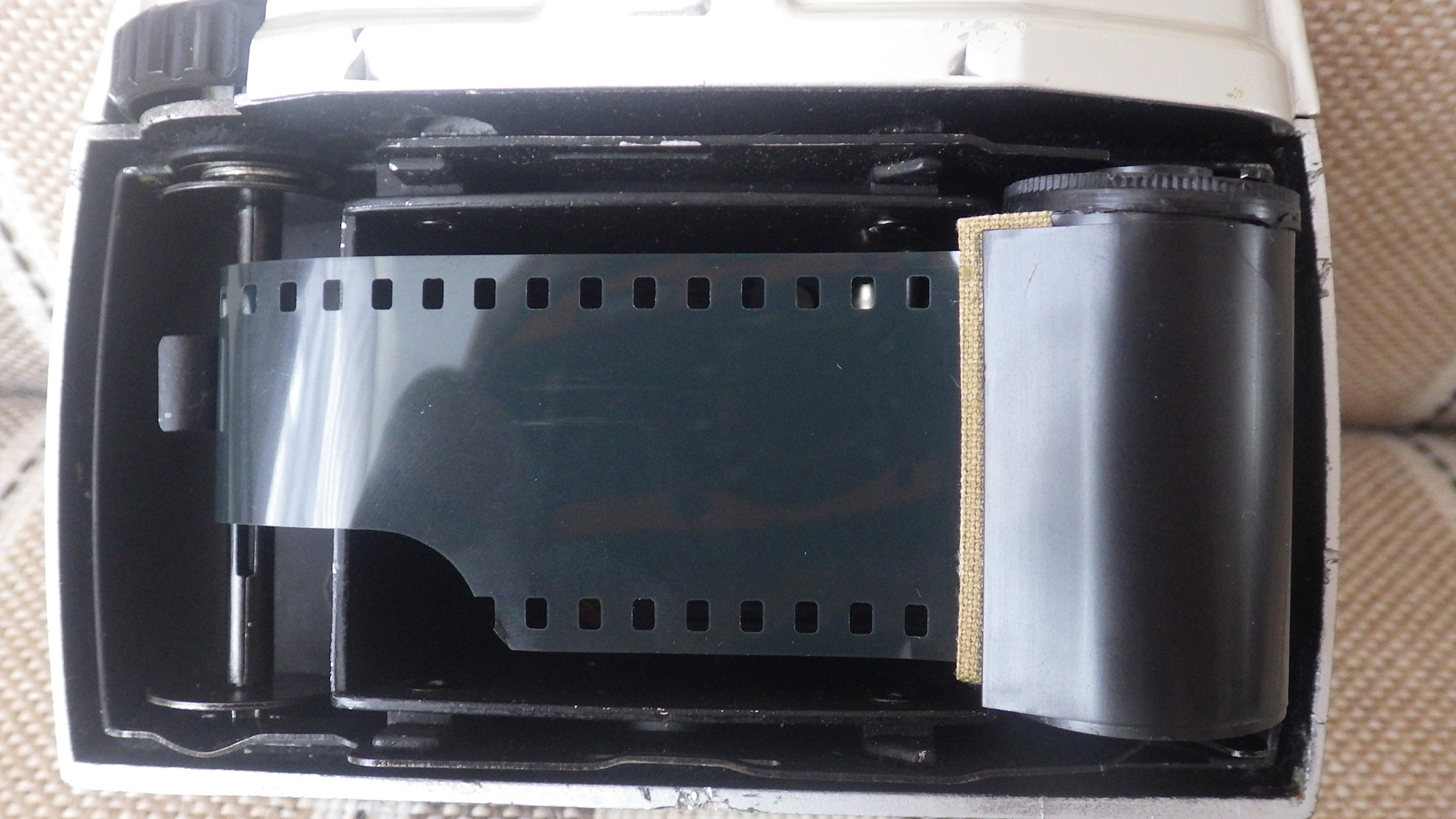

I've done this with a Certo Super Sport Dolly. It wasn't my own idea; I read somebody at Flickr saying he'd done it with this, because the cassette fitted easily. It's not an extremely wide frame; 58x24mm; and of course it's only panoramic in that sense. It's no wider a view than the camera would take on a 120 film, just cropped top and bottom. But it was fun all the same.
All I did was cut two pieces of wooden dowel to pack the supply end and hold the cassette in the middle of the frame. I taped the end of the film to the take-up spool. I guessed the frame-spacing. I put two layers of black tape over the red window. With no rewind, I unloaded the camera in my black bag straight into the tank.
Here are a few frames:
