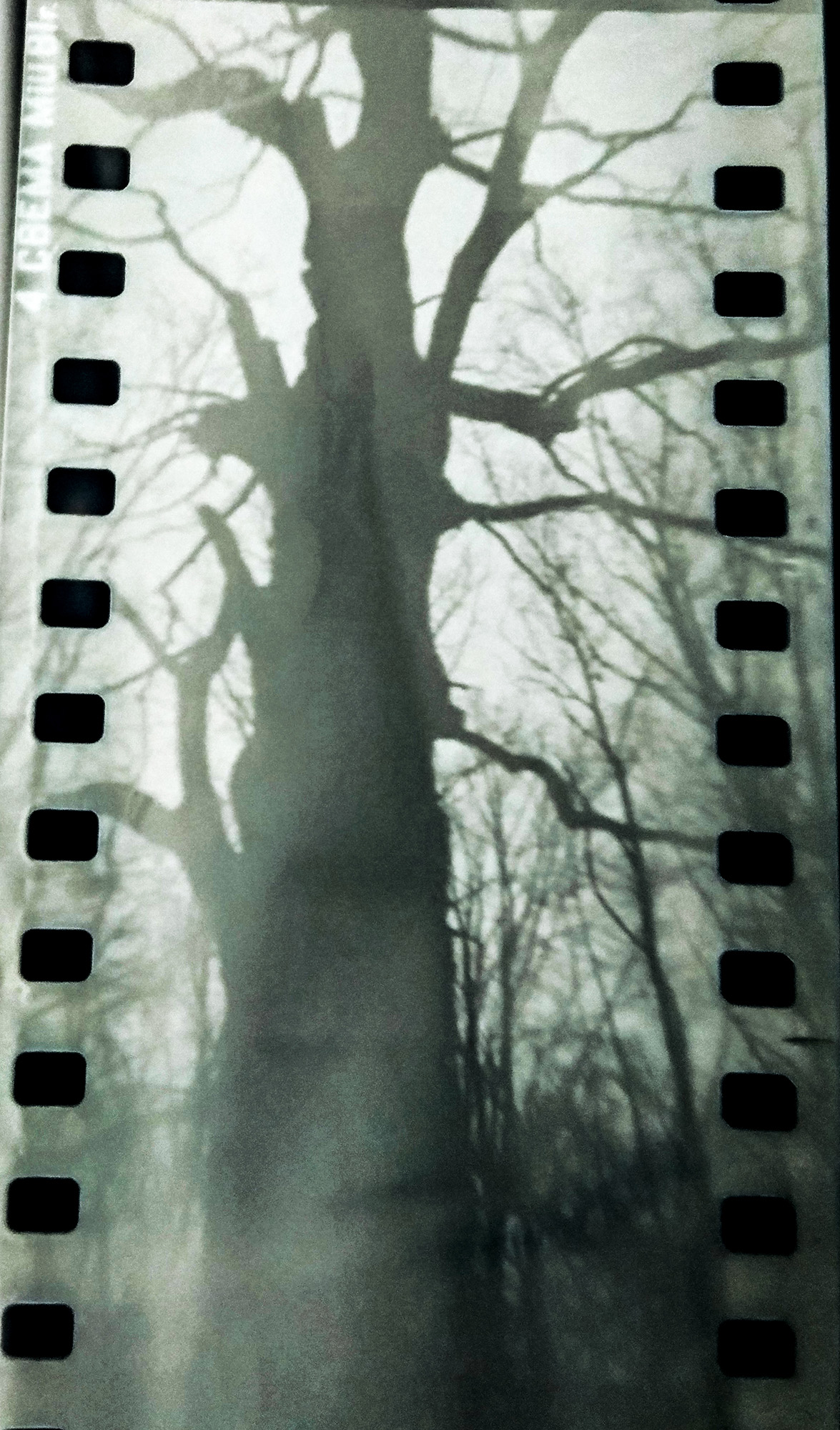

It is no different from simple framing. This is a simple cropping, unless it is possible with the image on the perforation. Many point-and-shoot cameras are equipped with such a pseudo-panorama function, they simply close the shutters at the top and bottom. My photo was taken on a 127 camera, it does not require adapters for 35mm. This is not a scan, just a photo of a negative on a mobile phone.

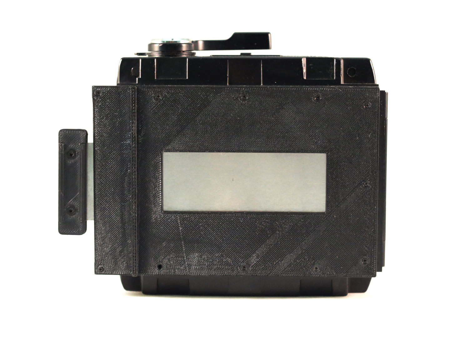

Film curl might be a worry for me, especially with older film that's been spooled for awhile. I do shoot a lot of 35mm panos in my RB67 Pro SD and now use a 3d-printed gate on the front of the back that replaces the 6x7 gate and only exposes about 26mm x 68mm of film and keeps it flat. This seems to work the best for me, and in conjuction with a mask for the viewfinder, allows for easy composition and shooting in pano format. The different film stocks available in 35mm, especially slow films like SVEMA MZ3, makes this a fun way to shoot panos. Of course when I need something larger with more detail I'll drag out my GX617.
Do you have a link for the .stl file(s) for that? I've been meaning to design one, but...
I cheated and bought one already made from these guys:
The wording in the included part of their ad seems worrying...
Yeah I saw that, its weird. Its not on the page. Must be in the SEO data in the page. Someone didn't do a good job when they created it. That said the film gate I bought from them is good and viagra free.
My only problem with it is the "limp" flimsy darkslide. The thickness is correct but the material seems floppier than the stock RB67 darkslide. It's sometimes hard to insert and get aligned properly. I may cut a new one from an older RB67 dark slide.
