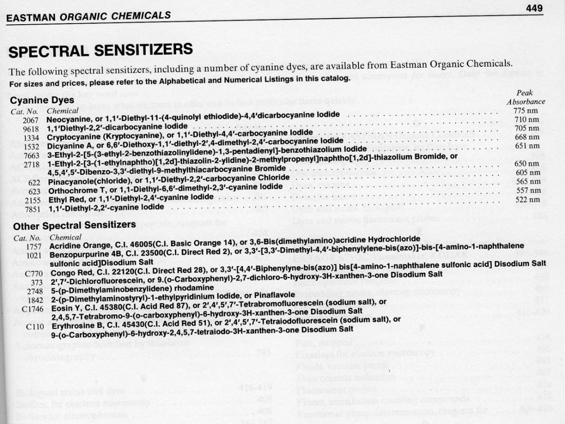

Well, take a look at the Kodak dye list I posted here previously.
Do you remember which thread title that was in? I can't find anything on this site with searches, even though I can find stuff on the rest of the internet, with Mr. Peabody and Sherman's help, all the way back to the beginning of the internet...
Here it is again
What the heck. I can just take up more of Sean's disk storage with another upload. Note, there are two IR dyes at the head of the list.
I have tried to get information on these, but cannot. If you can, let me know. All Easman Organic Chemical numbers in Rochester are shut down, or refer you to Tennesee Eastman, but TE knows nothing about these dyes. The EOC building is there but the parking lot is empty. The plant behind it appears to be functioning.
PE
[SPACE]
I have tried to get information on these, but cannot. If you can, let me know.PE
