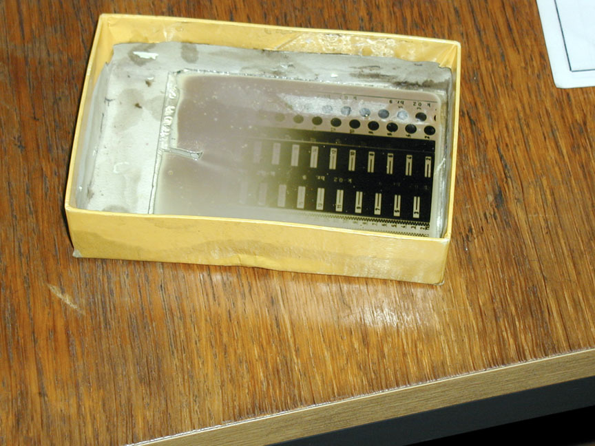

Hi Ray - I did watch them do this. Every 10 minutes or so, they would coat a glass plate with emulsion, expose it with a projection system. and develop (but not fix it). They would bring the plate into the emulsion chemist's office in a box and she would evaluate it quickly after removing the lid in full office light. She whould inspect it for fogging, and color change. Of course, since it wasn't fixed out, she had to work quickly. I'm not sure how long the process took to do, but the important thing was the record of samples 10 minutes apart which were done as the emulsion was sensitizing. Take a look at the attached file.

Jim, what size plate are we looking at?
I was wondering about
how long and completely
the emulsion was allowed to set.
Interesting chart- do you have a close up of it, or know where its from?

Hi Ray - the plate size was 4 x 5". Not sure how long it took the gel to set or if the plate was chilled, but I imagine that it was. Obviously, you want to develop the image as soon as possible after coating it so the emulsion doesn't continue to evolve. The chart was a glass plate (I think) that was placed in a very old looking projector - black wrinkle finish. But the projector looked to be very well made and the projected image was sharp. I don't know what they developed the plate in, but I doubt it was pyro.

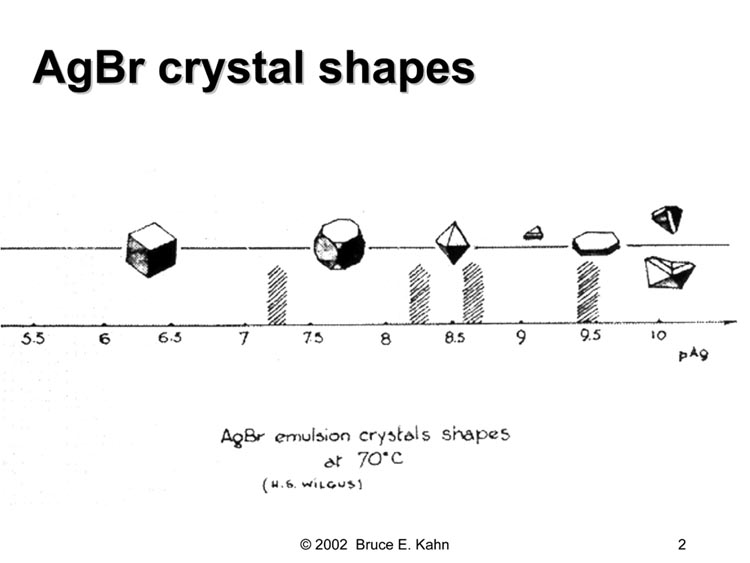

I asked about the Steigmann sensitizer in a thread called 'Sulfur and Gold sensitation'. Ron was kind enough to supply some guidelines on sulfur and gold content that is closer to a 3:1 ratio, rather than Steigmann's 8:1
To Quote Ron's reply:
The data below assumes the use of KAuCl4 and Na2S2O3.H2O for sensitization:
The data are stated as gold/sulfur in milligrams / mole of silver
1/3 for 1.0 micron grains
5/15 for 0.5 micron grains
35/100 for 0.1 micron grains

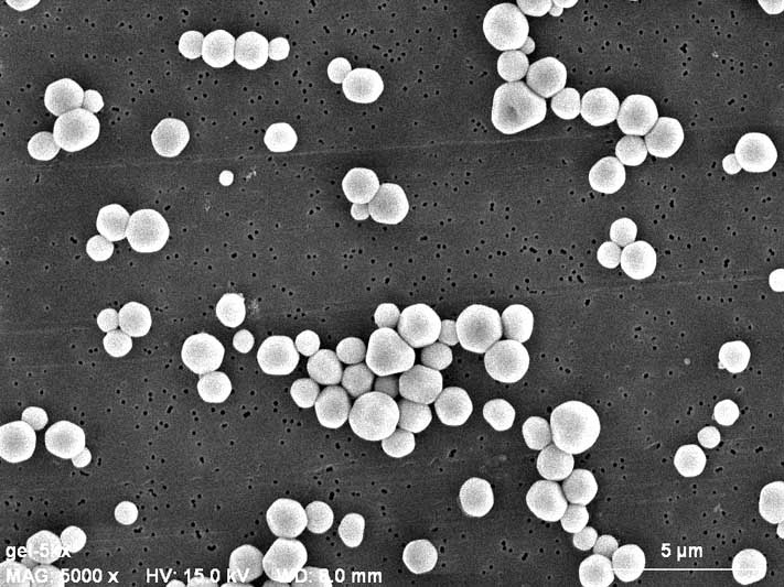

The attached chart shows the relationship to the vAg and the crystal habit that is formed. From this, you can see that my crystals in the second attachment are made at a vAg value between 7.5 and 8. The extreme rounding is due to the ammonia used to digest (grow) the crystals, and if taken much further the crystals would be nearly spherical.
PE
He also attached two jpg's with some good info.
Hope this helps.
Joe

my crystals in the second attachment...
Joe
Ron, It is 4 something here- I just woke up...
Are the crystals in the second jpg ones you actually precippitated for these experiments, or is the photograph just taken from a similar emulsion?
Ray
Ray
That is one of my emulsions Ray.
