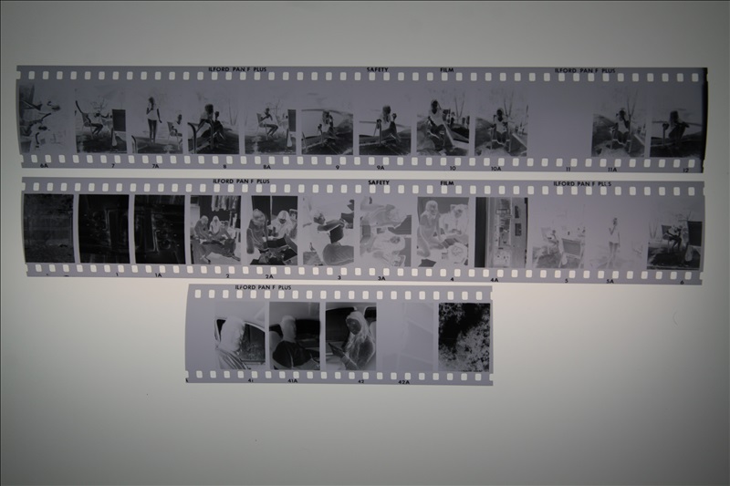

I bought a bulk roll of Pan F+ a while back, and just finished my second roll. Nothing special or exciting, roll was a combination test of the camera (Olympus Pen FT), a couple of lenses (25mm and 38mm), a cheap old Sunpak 131 flash, and of the film itself.
Anyway, the first roll I shot, I developed in D-76 at 1+3, and that's how I had my developing times set in my tablet (I use the 'Darkroom Timer' app), so 15 mins in the D-76. This is with 5 inversions every 30 secs. Load the Paterson, grab the chems, and off to the kitchen I go to develop. At about 13 minutes, I realize I used stock D-76 instead of the 1+3 dilution. Uh-oh.......
For stock D-76, developing time is only 6.5 minutes, so I was at least at double the correct time.
To my surprise, the roll came out great! A little on the contrasty side, but I tend to like more contrast. But I guess what surprised me the most was the (almost) complete lack of grain, even after a 600dpi scan at 750%. It's half frame, so I went to 5x7" for the enlargement size, since if the grain is really bad, I can always reduce the enlargement size.
On the light box:
attachment.php
and an unedited scan (I believe it's OOF because of the scanning):
attachment.php

I forgot a camera was loaded for a year, then shot the last six frames
developed the next week, but can't see any real difference in last years frames and this years.
Was not what I expected. And not what I'd recommend.
Bulk with 05 expiry.

I started a roll, shot 4-5 frames, left it, came back to it 9 months later, developed it, and bam, first few shots were thin

We've been through this. It's easy to blame people's camera/exposure/development, etc. When it happens to you, though, then you get it. I covered every base when it happened to me a year or more ago. I had let the film sit three or four months before developing it and got next to nothing on the roll. This was when we still had an attentive Ilford representative among us. He invited me to send the film and all the relevant data to Ilford for inspection. The technician confirmed that I did nothing wrong, and said the film was occasionally subject to "latent image regression." I was compensated several rolls of film as a result. Very nice, though I was in no hurry to use the replacement Pan F that was among the film they sent.
