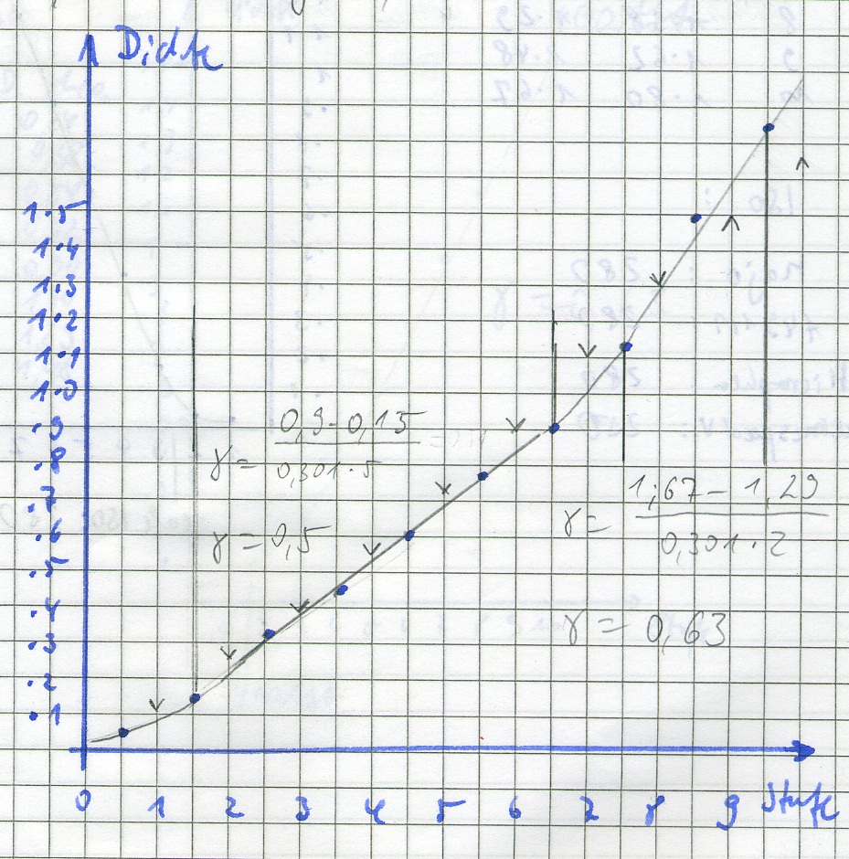

I measured a HD curve for Pan F+. The film was developed in Rodinal 1+50, 16° C, 10 minutes at continuous agitation. The curve shows:
- points: that are my measuring points. Because i tested the film with 50 ASA in mind, but it reaches only 35, my points are now between the zones
- triangles. That are the ideal values, taken from Lamprecht/Woodhouse
- the curve has two sections with different gamma. The film tends to speed up beyond zone 7, but not to an impractical degree.
- the lower part of the curve with lower local contrast is very short.
It could be a choice to increase the developing time by around 10-20% or lower the dilution. Then the zones 2 .. 7 would come into a higher gamma and mid tones stout out better. Highlights would came to a gamma of around 0.7. This is not too high, but some problems may raise. They can be easy overcome with flashing the paper.
The film is fine grained but sharp. 11x14 prints (30x40 in German) do not show any grain at normal viewing distance (0,5m).
