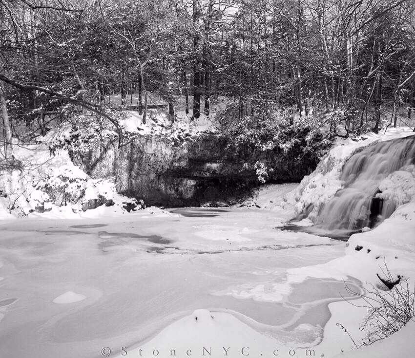

FP4+ in Rodinal 4x5 sheet

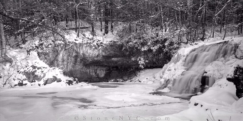

PanF+ in Rodinal 6x12 pano back (same camera and lens and exposure [minus adjustment for different ASA])
