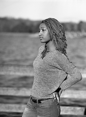

The film was actually shot at 32iso so that's why I developed at 7min instead of 6min like the chart says for 25.
Anyway, here are the results, shot at 32iso and developed in D76 1:1 for 7min
11830987306_0ab8efffae.jpg 11830840556_779269eb22_z.jpg 11829719534_acf29b1808_z.jpg
Now here are a few shot at 50iso and developed in Legacy Pro LMax Dev (TMax Clone) at 4min
11445402613_836778d969_z.jpg 11444751665_9b21444486_z.jpg 11444804934_93df2e9a85_z.jpg
This is all on 120 film btw. Shot on a Pentax 645.
I got this Pan F+ expired for pretty cheap on ebay just to test out. I'll probably end up going back to TMax and TriX though.
View attachment 79850 View attachment 79851 View attachment 79852
View attachment 79853 View attachment 79854 View attachment 79855
Great exposure on the first model, good balance of tones between her skin, clothing, and background. It's really hard to balance white on a dark skinned model, but you also did fairly well on the second girl as well.
I'm sad you didn't appreciate the PanF+ though, it's one of my favorites for models.
i have several rolls of Pan F+ left so I may decide differently. It's a great film, just kinda contrasty and it has to be the right light. If I do keep using it I'll probably keep shooting between 25-32 iso and dev in D76 1:1. I really liked the results from that. I find that delta 100 or tmax 100 is just as sharp, if not sharper and is not as hard to expose properly. I do want to try pan F+ in 35mm though.
