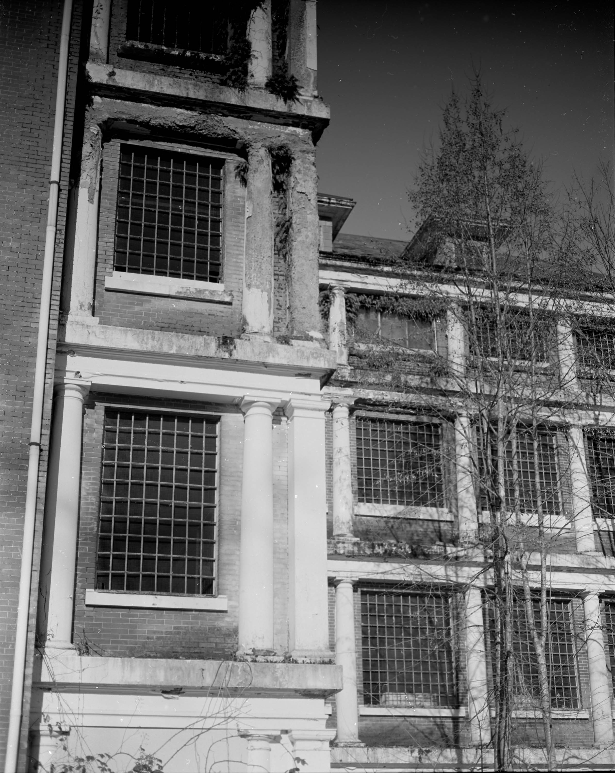

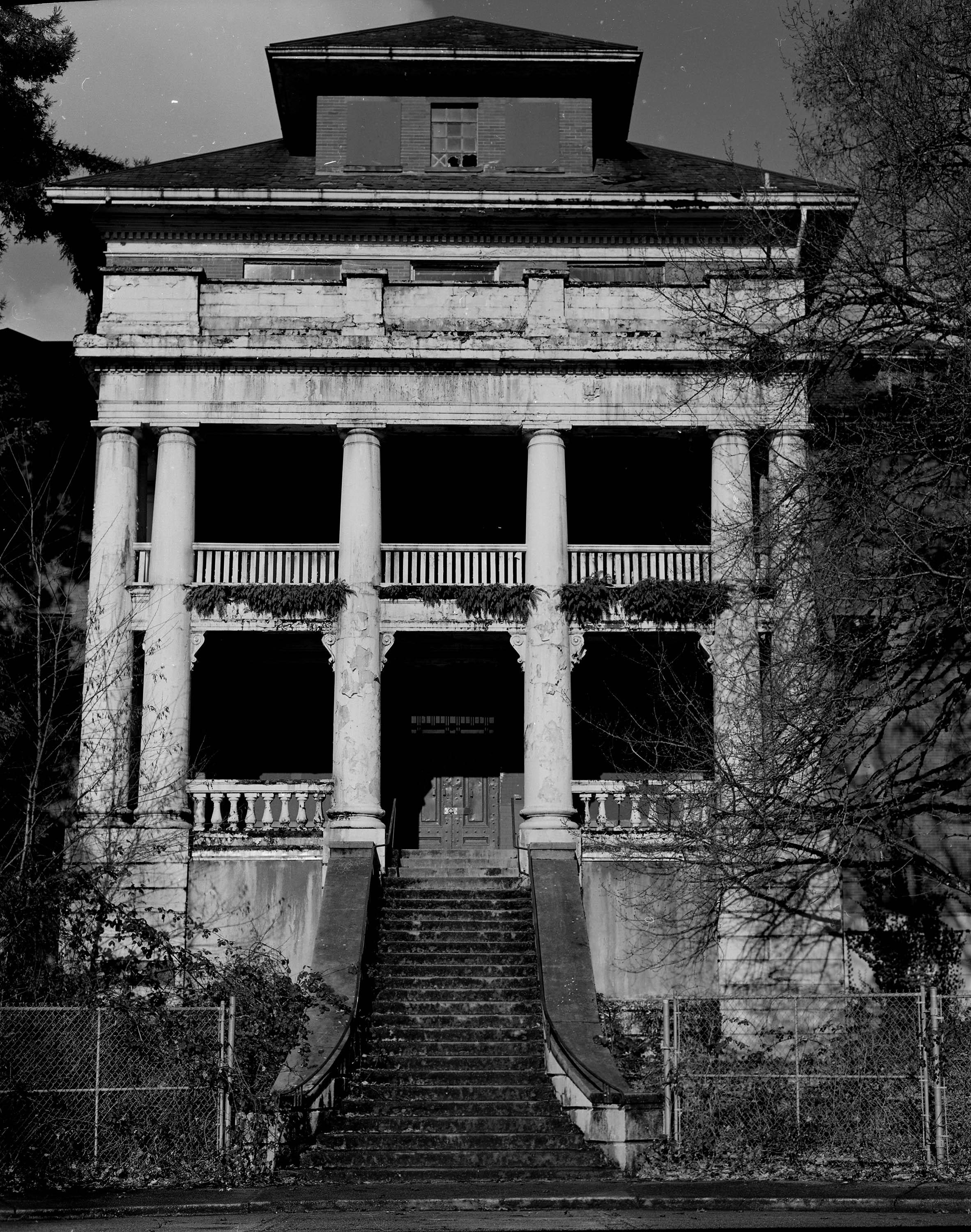

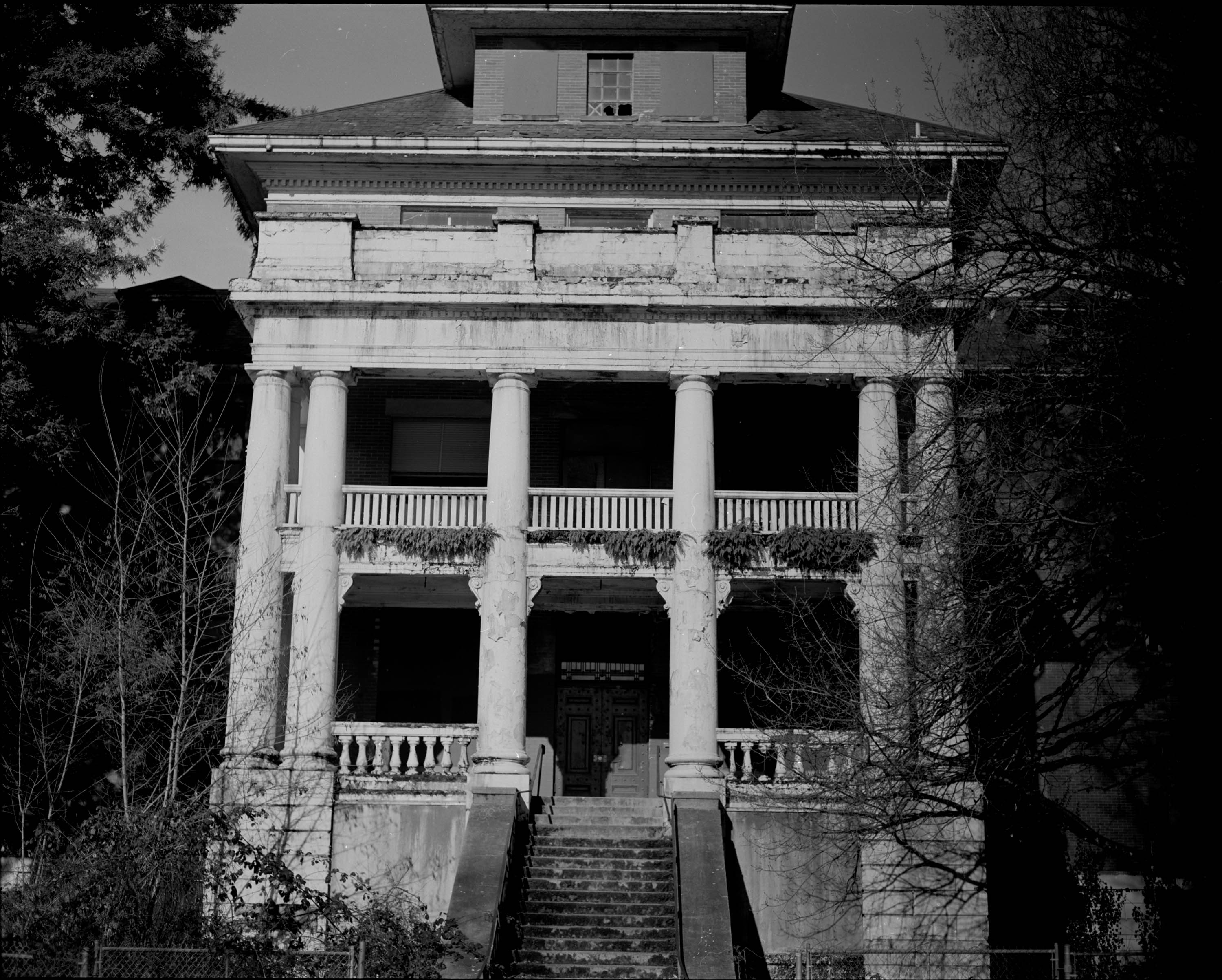

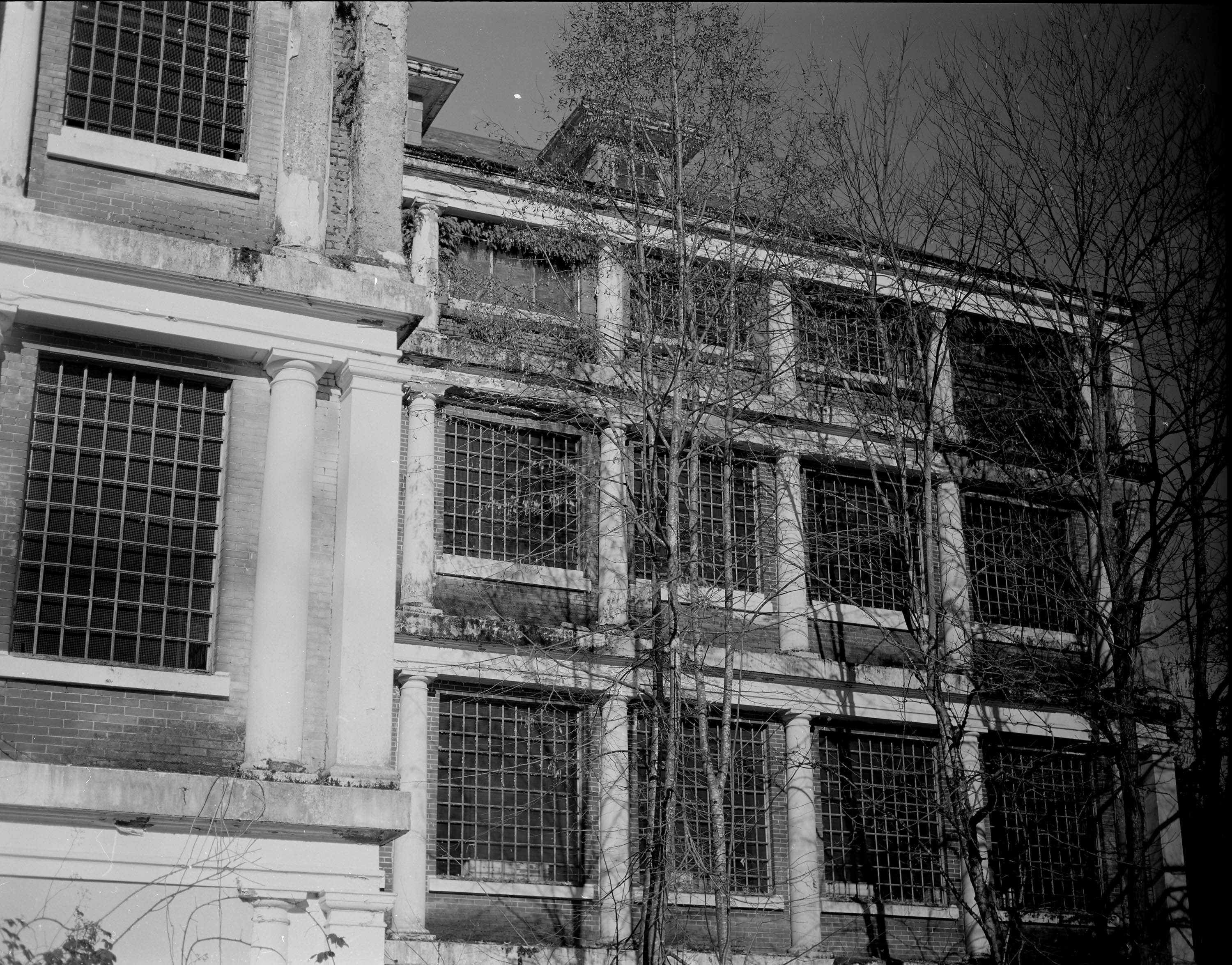

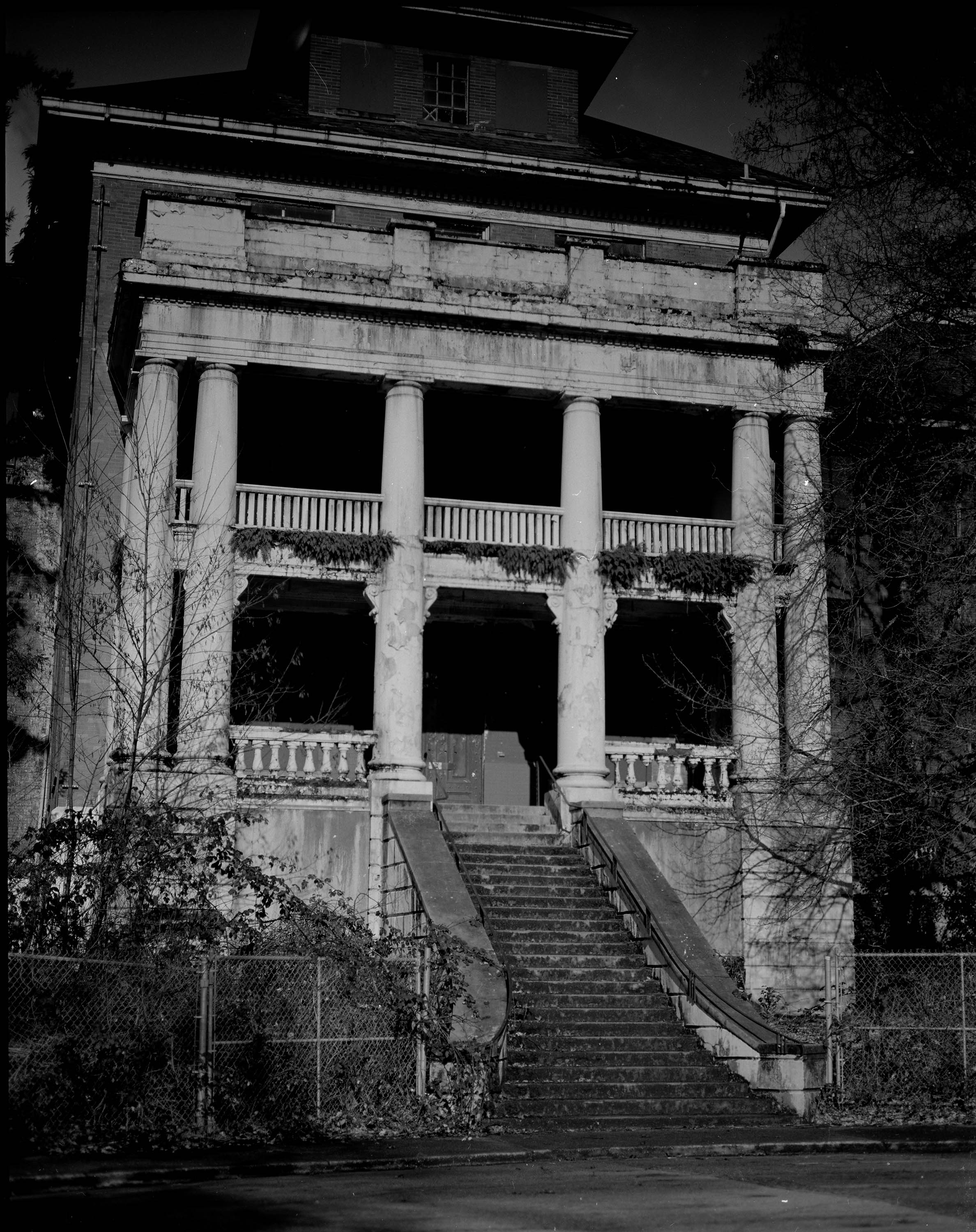

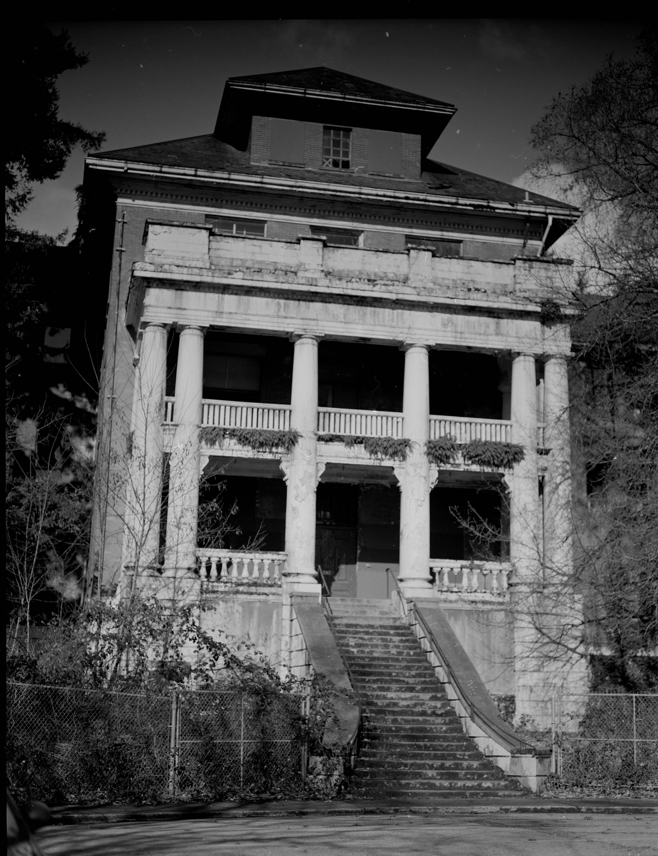

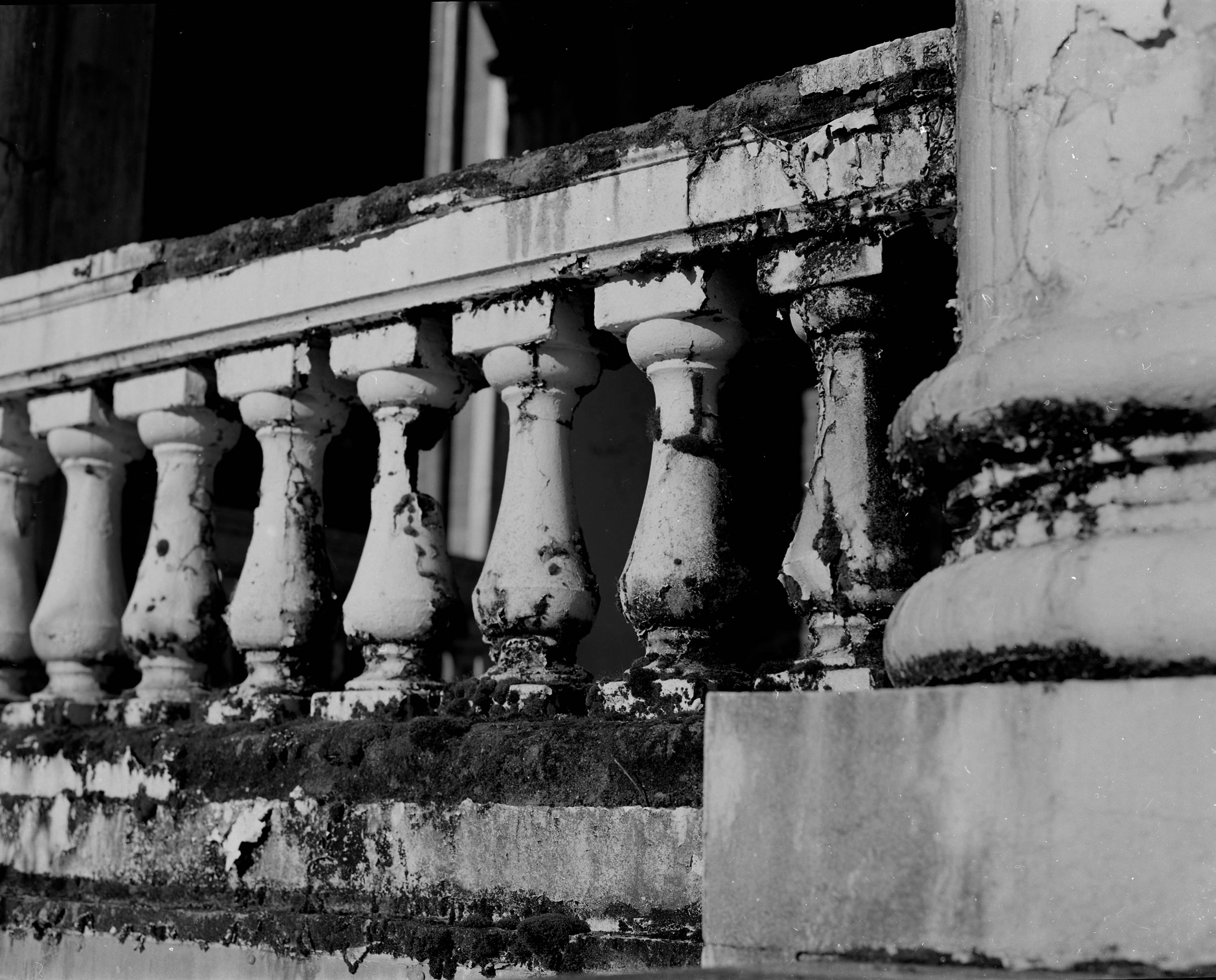

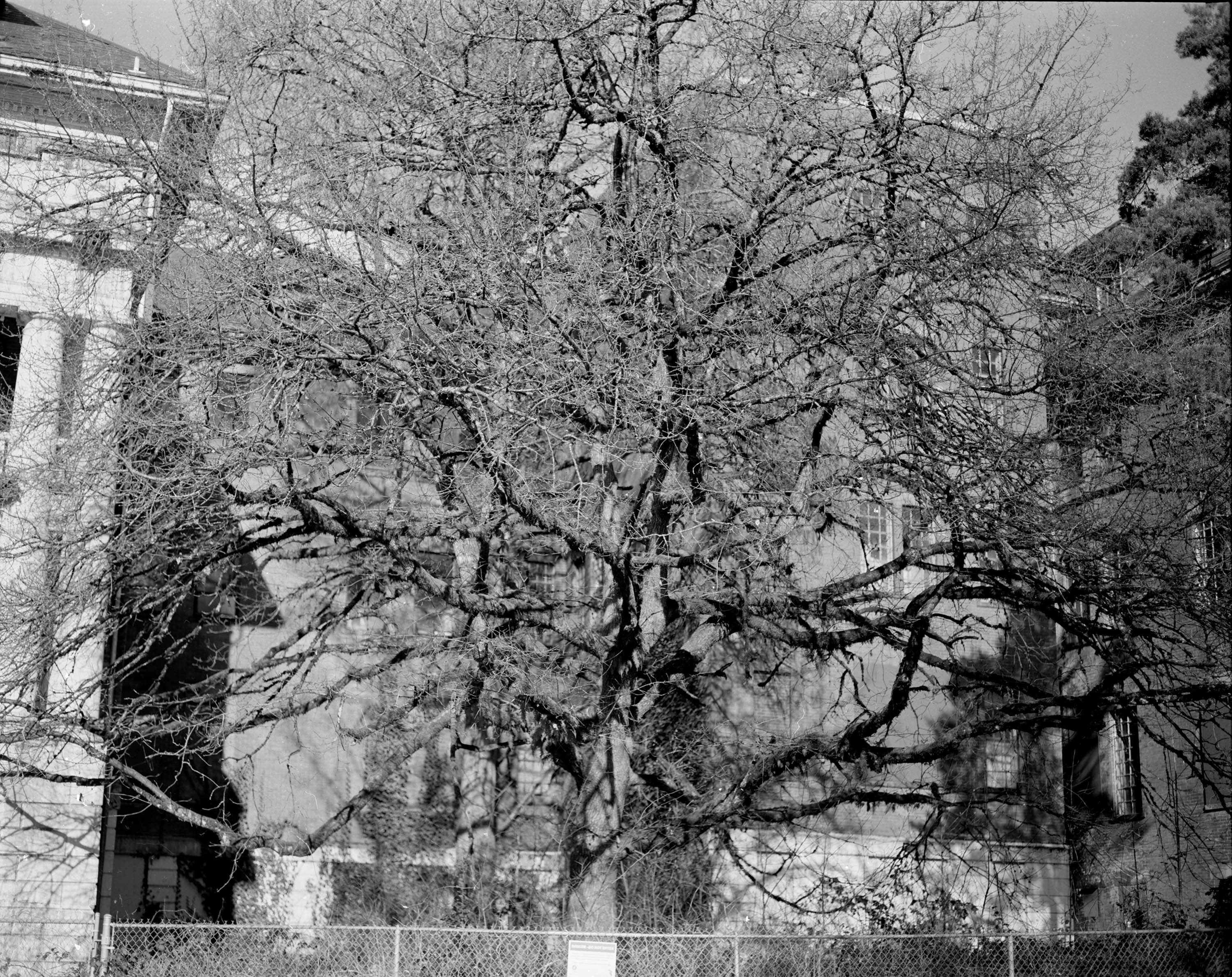

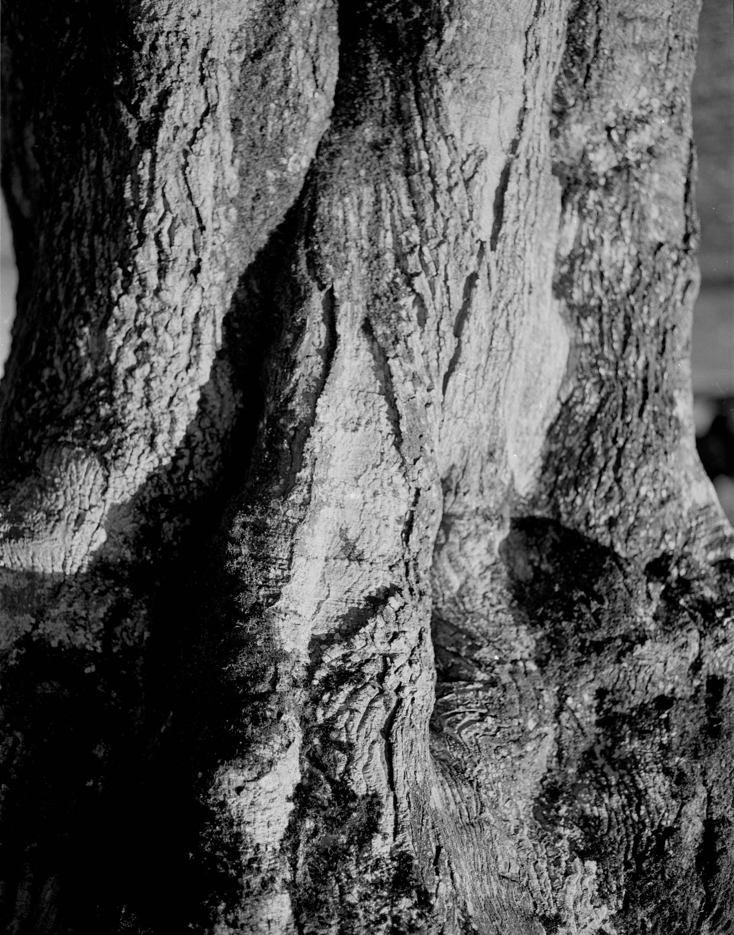

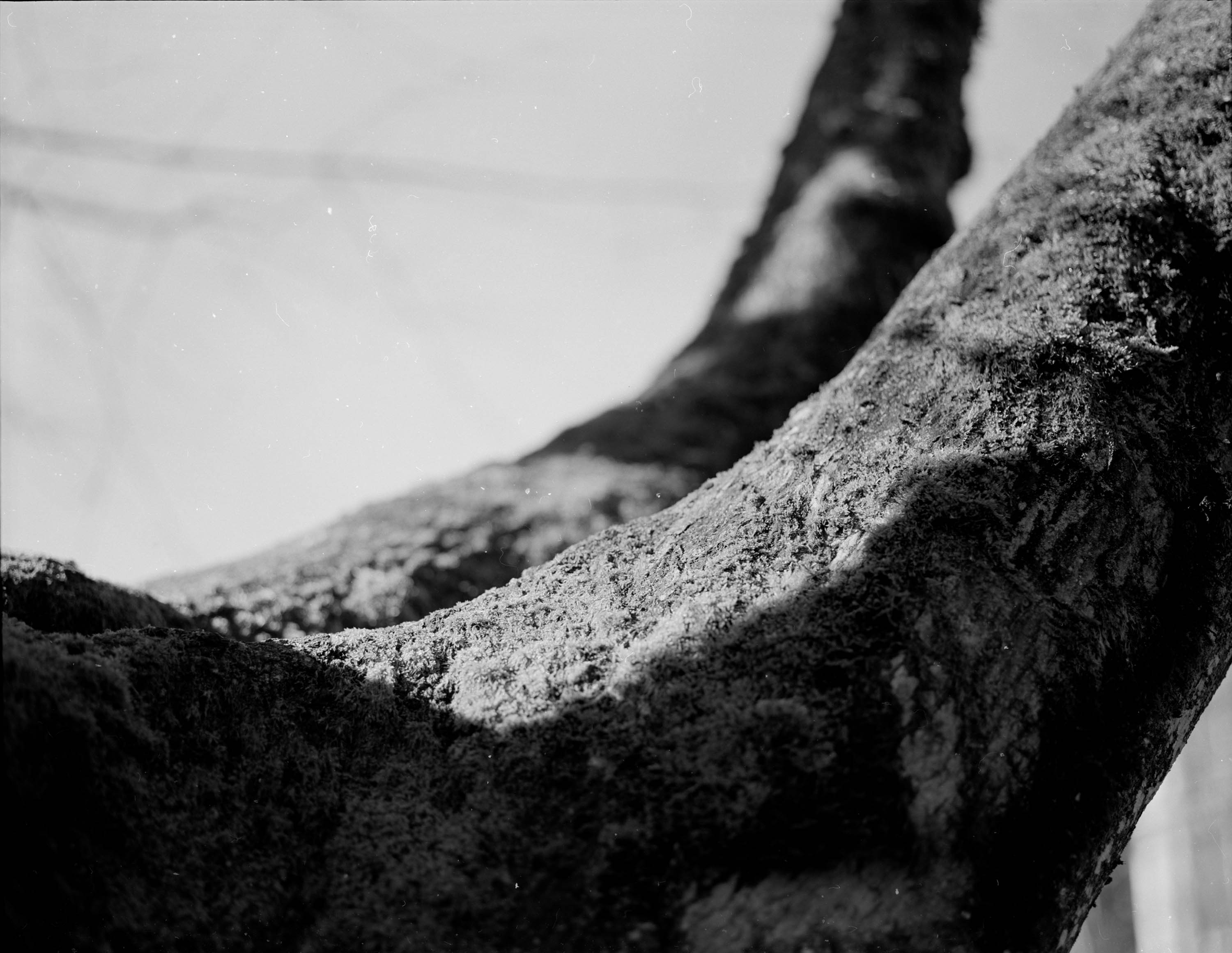

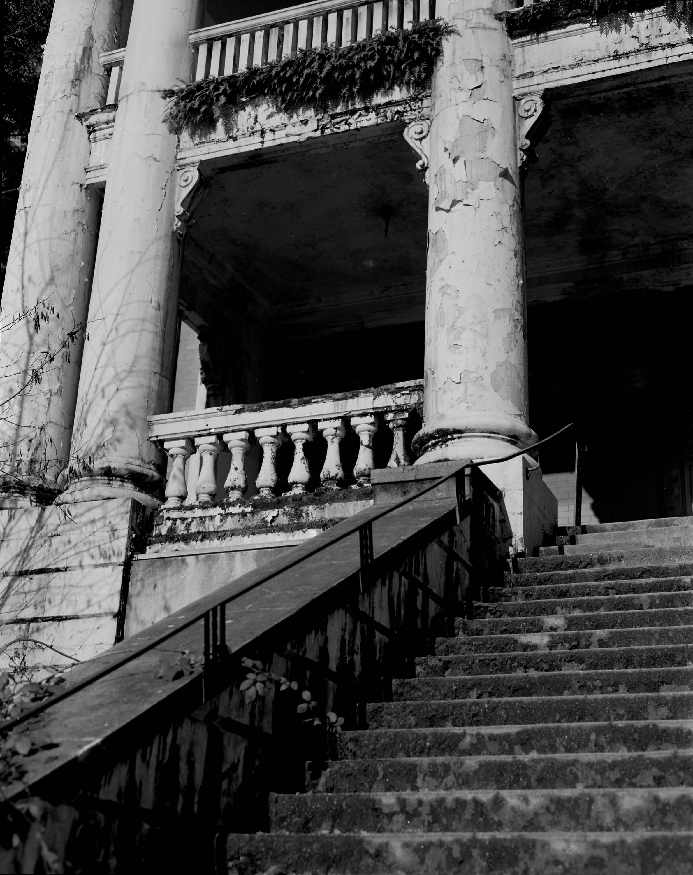

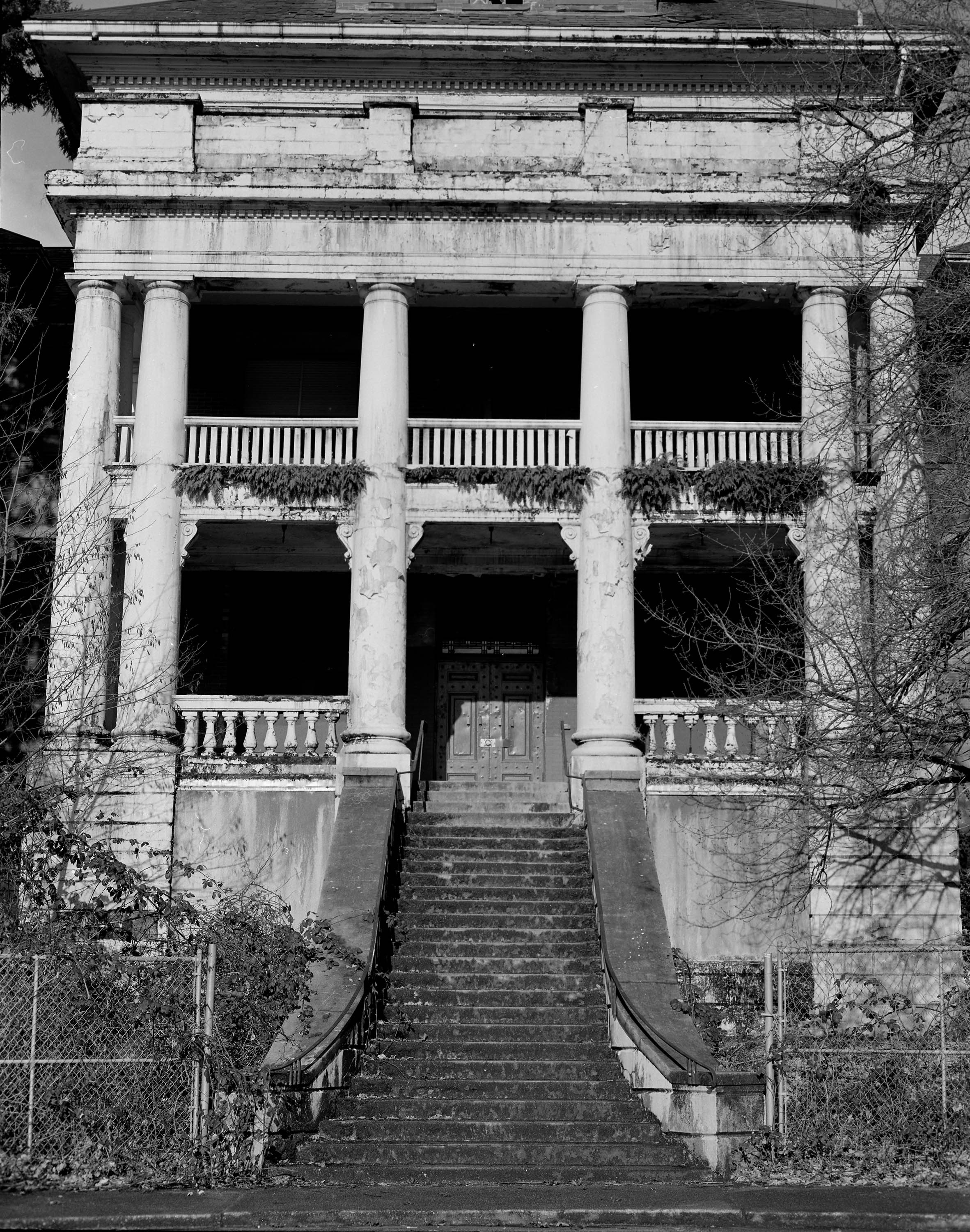

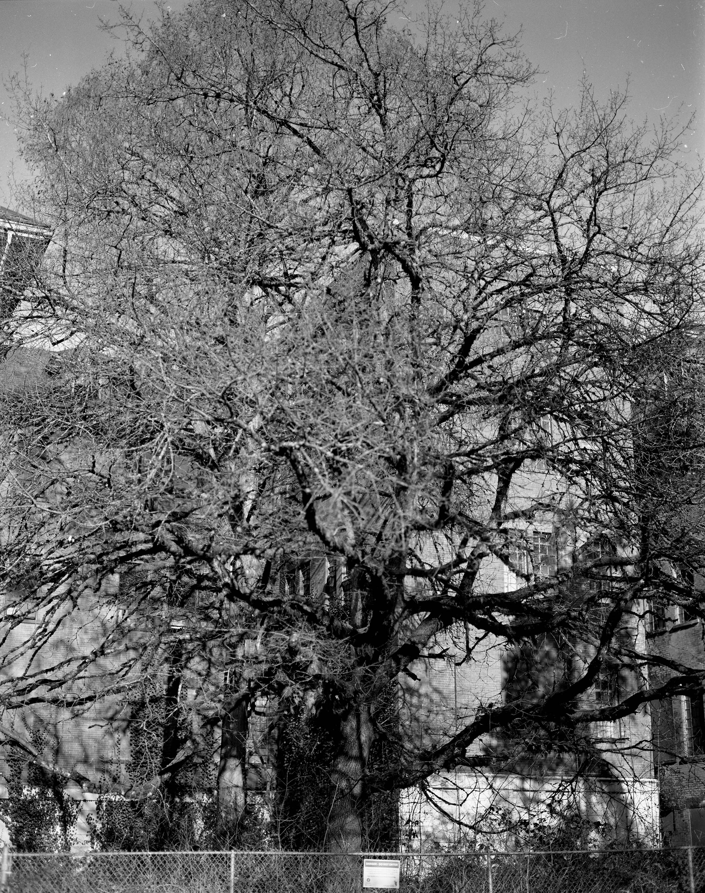

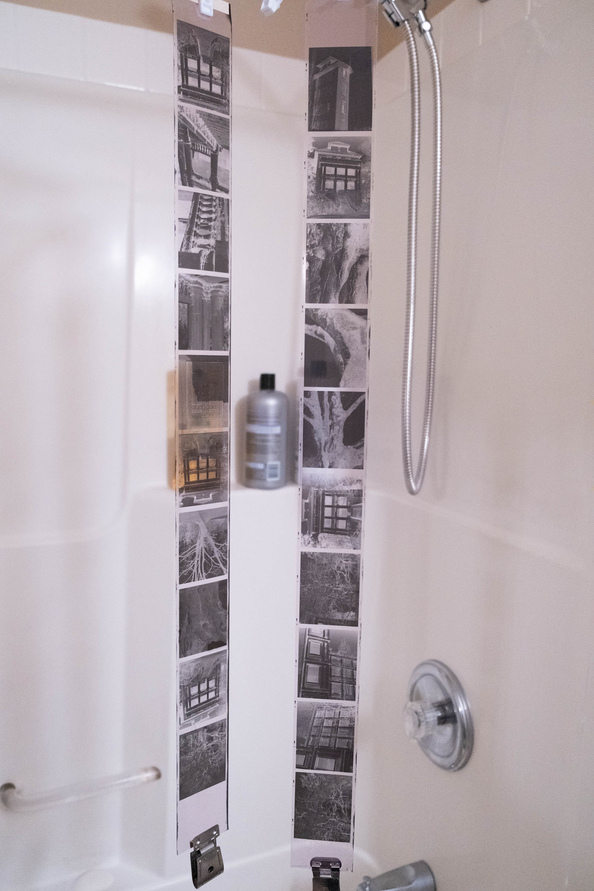

So we did our shoot at Riverview in Coquitlam today with Andy and Matt there. I shot my Pan F at 25 ISO. The sun was out, but it wasn't a strong sun. The light was quite nice today. A bit softer. I developed my 2 rolls of 120 in Xtol 1:3 for 10.5 minutes and they turned out great. I'll have to scan them up to see how the contrast faired. Both Andy and I did (and are doing) some videos on Pan F+ this week, so you guys can take a look.
Yeah. 8 is a bit early for me. I'd have to get up at 6:15 to make it at that time. I wasn't unhappy with how the light was today. The contrast of the buildings with white paint, etc would have been high anyway. I think only in overcast would it be more toned down.
The light/sun was strong enough that I have my first bit of "colour" for the year!
The sunlight at 8 was different than the sunlight when you arrived. It was more pinky yellow, and not as harsh, peeking through the cracks in the clouds. The shadows are much longer, too. The trees I like to photograph are more backlit and quite stunning.

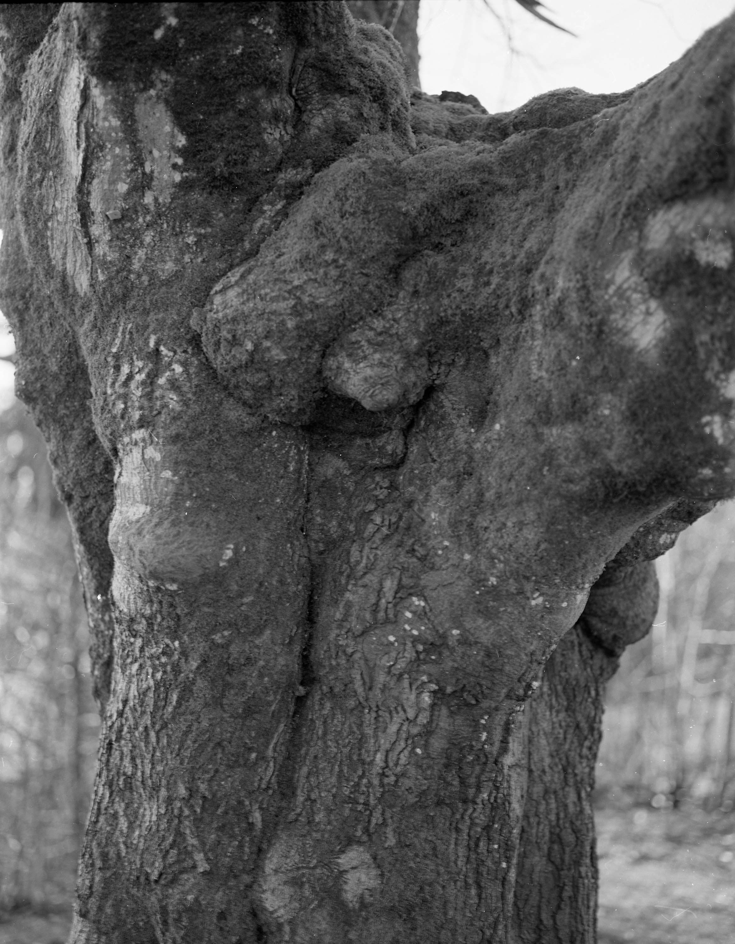

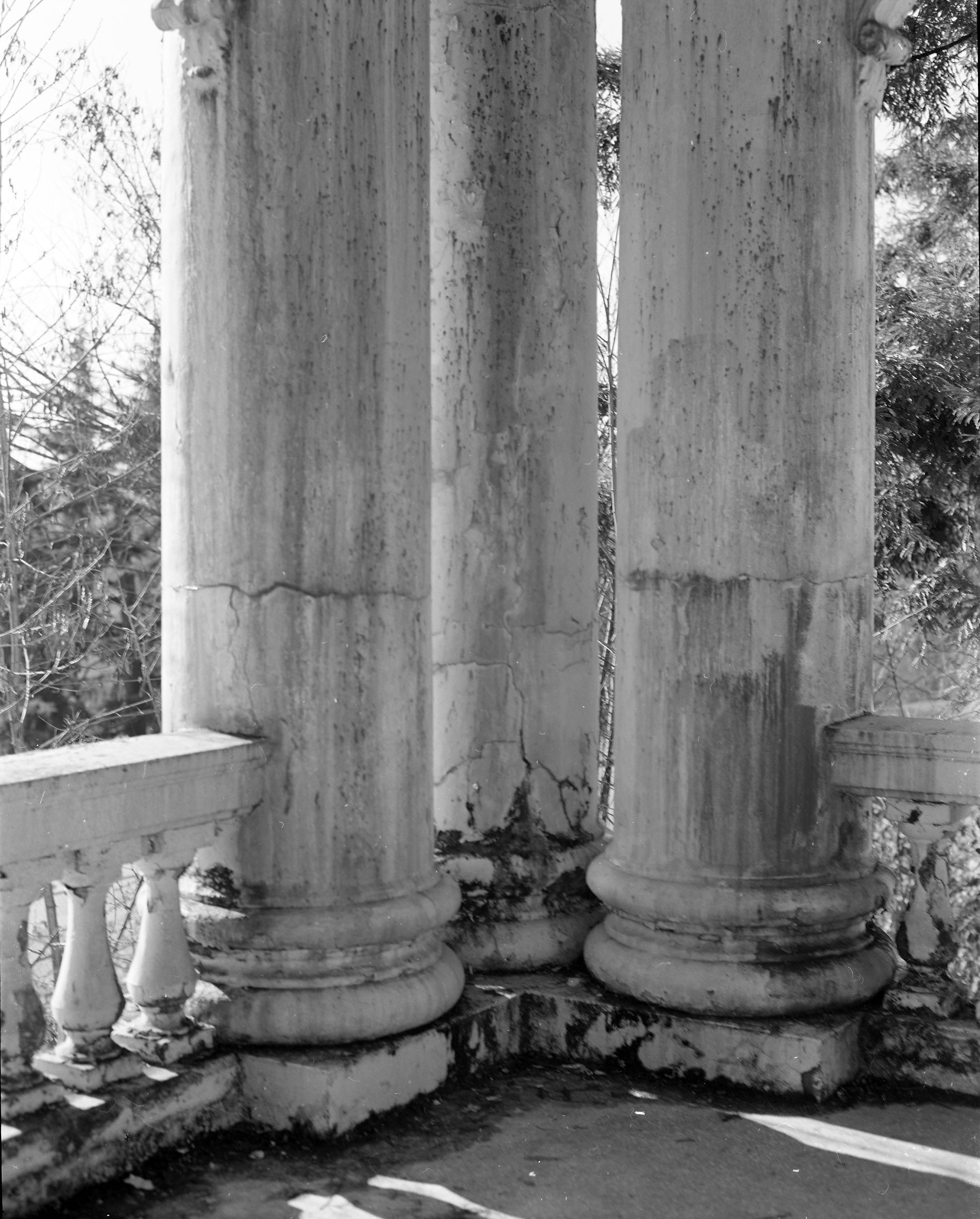

Here are some of my pics from last Monday. This was Pan F+ shot at 25 ISO and developed in Xtol 1:3 for 10.5 minutes. Im wondering if my shutter drag issue is starting to come back, as some shots were darker on one side in a few of them.
