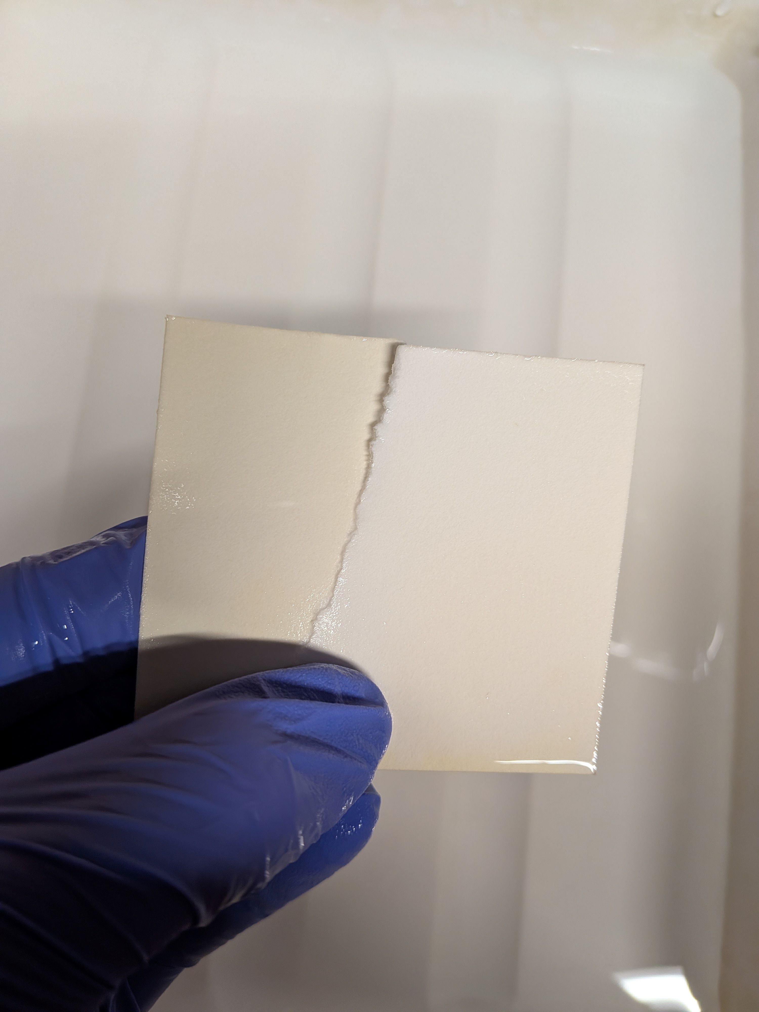

I've been having issues with palladium toner staining my paper once placed in the fixing bath. To rule out that this is not due to any of the steps in my process for Kallitypes, I performed the expirment below. I do want to stress that I ONLY put paper directly into the toner. No sensitizer, development, or clearing bath were used for my tests. The issue is exclusively with the toner, fixer, and paper.
1. Soak a piece of fresh paper in the palladium toner for 15 minutes
2. Rinse for 20 seconds
3. Cut paper in half
4. Fix half of paper for 2 minutes
5. Compare fixed paper with unfixed paper.
Palladium toner formula:
-1L water
-10g citric acid
-15 drops of Sodium Chloropalladite 15% solution
Fixer formula:
-1L water
-50g of sodium thiosulfate
Paper:
Legion Revere Platinum
As you can see in the attached image (where I am holding the paper), there is a very distinct yellow stain. This only appear after the paper enters the fixer and gets worse when the paper dries and is unsightly (see image of test strips). The stain is present on the front and back of the paper and almost looks like tea toning. It does not wash out once stained despite by best efforts.

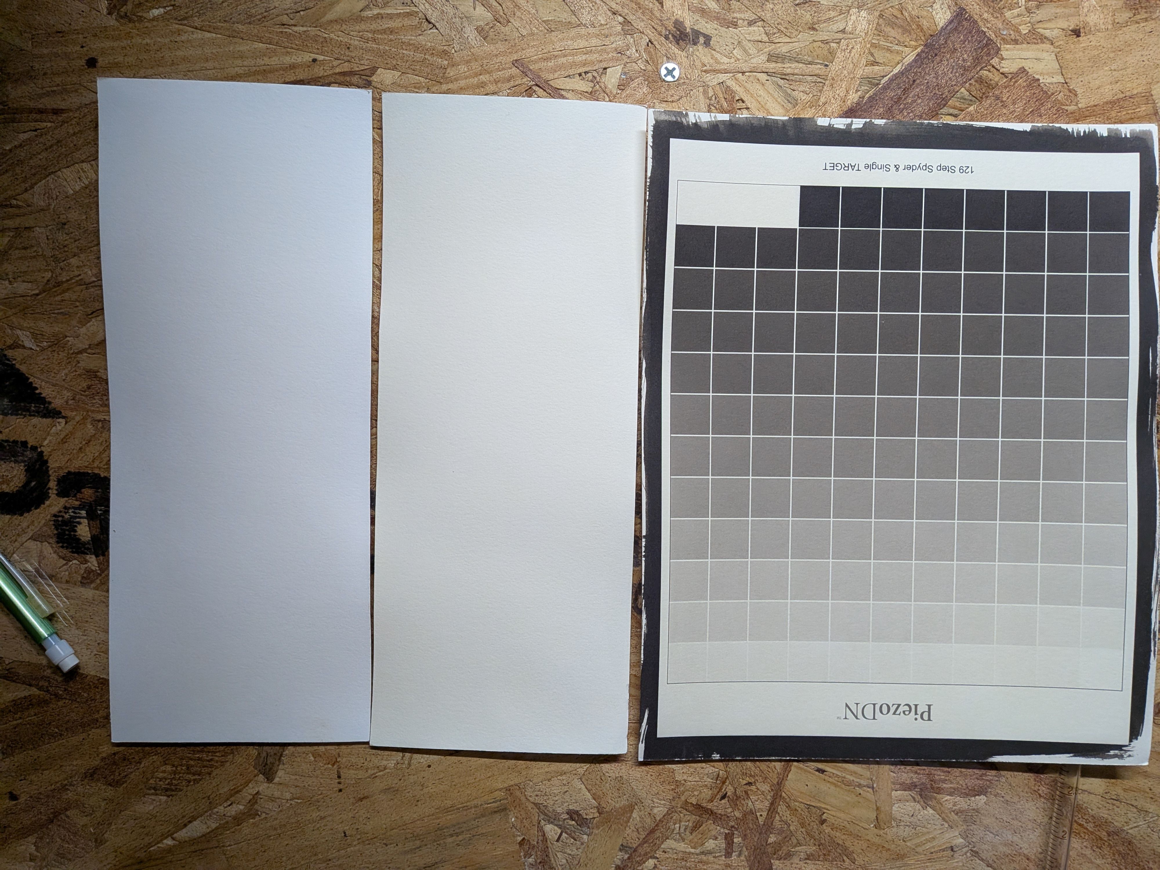

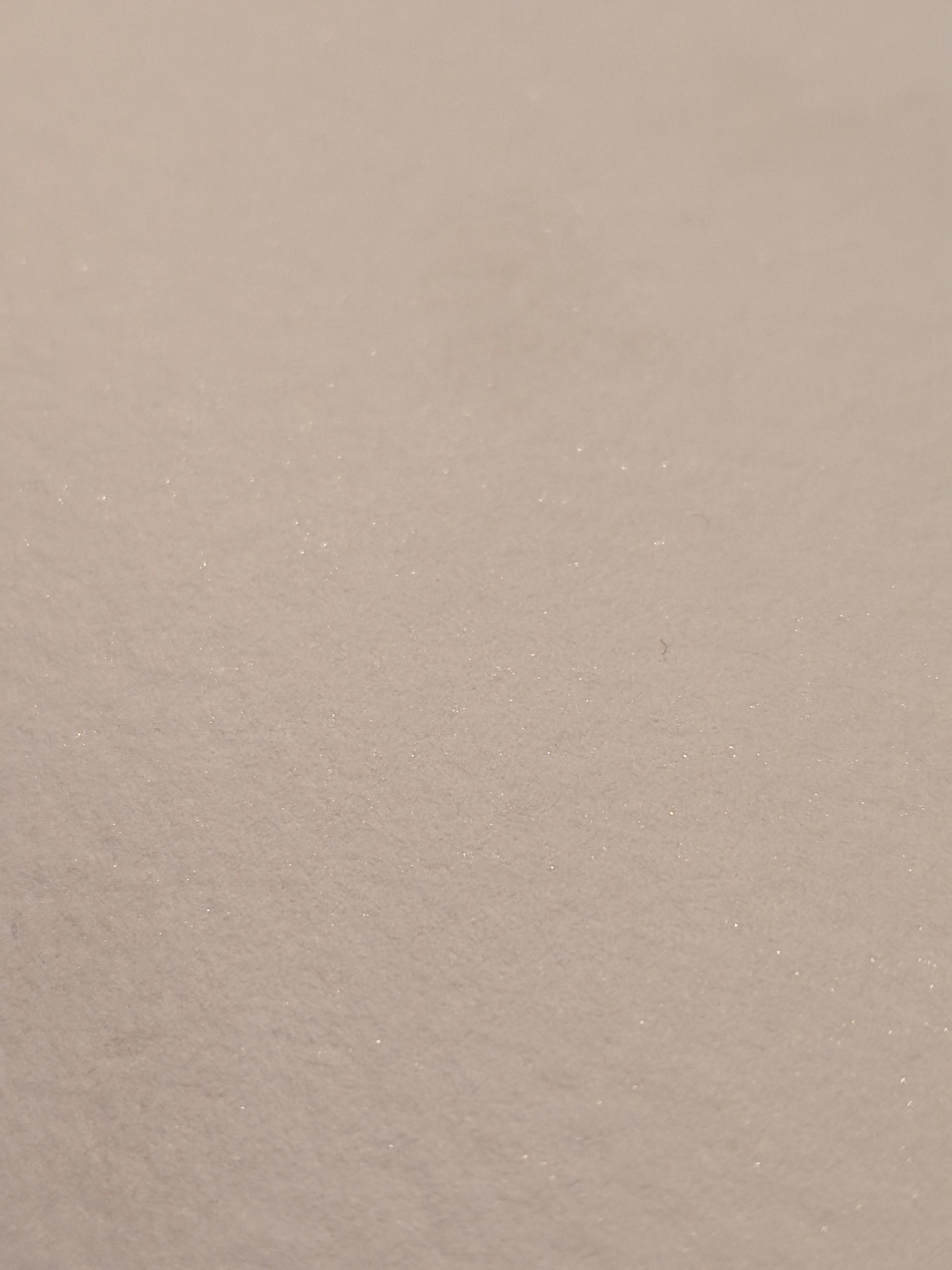

Another interesting discover. I was making some new calibration profiles for my Arches Aquarelle cold press paper and noticed that the sheet I palladium toned literally sparkles. Not just where the paper was coated with the sensitizer, but also the uncoated back side. Might lend credence to the stain being metallic palladium?
Almost looks like a very fine glitter at certain angles. Its kinda cool tbh.
I tried a few things and I could not fix (no pun intended) the staining issue with the palladium toner. I tried a few things such as acid baths before and after fixing, very long washes, etc, but to no avail.
My conclusion are still as such.
1. Palladium toner will stain paper
2. Time and strength of toner determines the level of stain
3. Paper choice determines the level of stain
4. Platinum toner does not stain
5. The palladium toner stain does not appear until the paper is placed in a sodium thiosulfate bath
The stain is not very strong with HPR paper which is what I think many folks use and may be why this issue is not widely reported.
I was also unable to reproduce the sparkly Arches Aquarelle paper phenomena despite by best efforts. I thought I knew the variables that lead to that result, but I'm definitely missing something from the equation. If I knew if the sparkly crystals were silver or palladium would help.

Watch the sparkles for tarnish. Palladium metal should keep it's sparkles. Expensive process 😎
