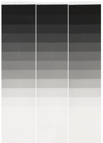

Decided to see what if any difference the easel colour has on B&W prints so....
I exposed a transmission grey scale in the enlarger neg carrier so as to favour the highlights (the logic being that that is where any fogging will show). The scan below is of the resulting three prints (MG-IV RC glossy). The 1st strip is with just the white easel surface, the second is with a sheet of matt black cartridge paper under the paper and the third, just for a laugh (I thought), is with the shiny side of some aluminium kitchen foil underneath the paper.
No difference. Not in the scan, but more importantly, not by inspecting them under a variety of lighting (i.e. from daylight, up to and including a 1kw security lamp). There is actually a very, very, slight hint of a suspicion of a suggestion of a possibility of extra density in the foil strip when viewed by transmitted light on the light box, but other than that, they are all identical.
Cheers, Bob.
Cheers, Bob.
The answer, as usual, is to test and find out. Thanks for doing that Bob!

Bob F.
Oct 4, 2004
3,977
London
I was a bit surprised myself, especially with the silver foil result which I though would be a "control" and show a clear difference!
I just did another quick check with a small light and my exposure meter and I find the paper attenuates the light by a surprising amount: just over 3 stops each way. So that makes a total of 6 stops less light hitting the emulsion from underneath even if you used a mirror under the paper... Which I guess, explains the results: minus 6 stops extra exposure is simply not going to show. That's using Ilford MG-IV RC, MG-IV fibre attenuates by 3.5 stops each way so would show even less effect. The MG-IV RC is the thinnest paper I have.
