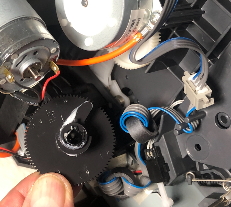

Since the printer is way past warranty, I decided to go snooping.
Took all the covers off by following this video:
...and found this:
...which I believe is the end of the 'drive shaft' for paper feeding.

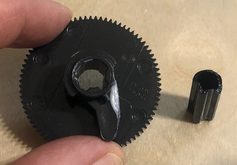

Here's the broken shaft end removed from the gear:
The saga continues. Will a solution be found before the ink nozzles start clogging up? Stay tuned!
Oh, that looks like it can be glued back together. Interesting!
I would tworry about the nozzles too much. They generally declog OK, but sometimes it takes some (a lot of) ink.

The motor with the cogged belt is fine. It's a gear under the take up wheel in the vertical feed area that broke.

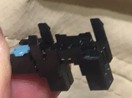

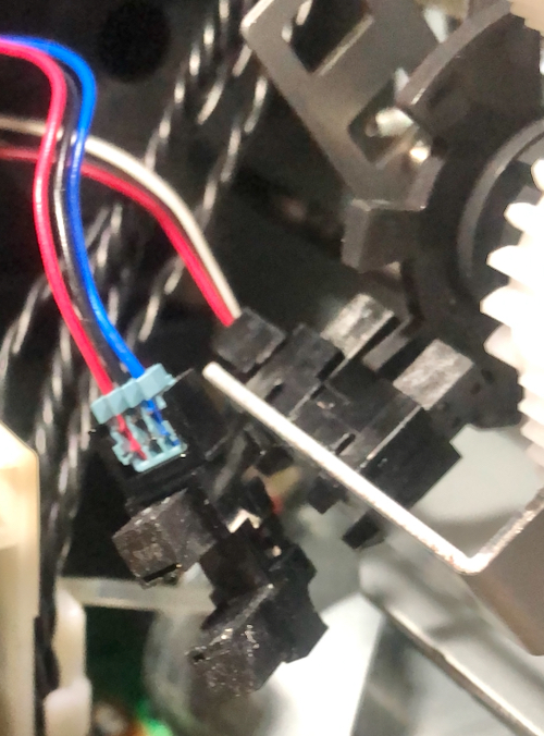

Began exploring how to take the paper feed assembly off, before deciding on whether to order a replacement.
While doing so I found a sensor (?) in the photo below dangling in midair. One of the four plastic 'barbs' had broken off. It goes into the two cutouts in the aluminum tab in photo #1's top right corner. This is on the opposite side of the printer from where the paper feed assembly shaft had broken.

Weird. Things must have been jumping in there!
Looks like the whole paper feed assembly will come out easily, and pretty sure the broken bit found today will be part of the new assembly because its wires go right into the green electrical connection board.
Pondering...order new paper feed assembly...or...find someone to print my negatives for me...or...
Ah, that looks like a decent explanation for your error. That dangling sensor would likely result in no readings from that one, while another sensor in the paper path would see motion, in which case the printer's firmware would decide something's not right.
The plastic on those molds gets brittle over time. Sometimes it doesn't take a lot of force at all for small parts to just snap. I had a similar thing happening on an Epson scanner; after 20+ years, the plastic just got too weak and even normal use broke the part.
I'd start by trying to fix this and remount the sensor where it's supposed to be using any convenient configuration of glue, tape and odd items found around the house. See how that goes, and hopefully buy yourself some time to decide where to go next.
Honestly, this looks like something that can be overcome.
Agree with you that a quick fix should be doable for the sensor, but there is also the broken shaft from post #4:
No success yet trying to glue that part ? The parts will have to be degreased thoroughly, but I'm sure they can be glued back together with an appropriate glue.
No, I haven't tried glueing it. If there was enough force to break the hollow thin walled roller shaft, I can't imagine a glued joint surviving long at all.
I did try inserting a somewhat form fitting 'splint' into the hollow broken off piece and the rest of the shaft, but there was too much sloppiness.
Will give it one more try, then...
