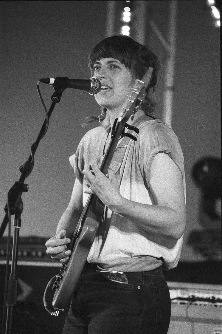

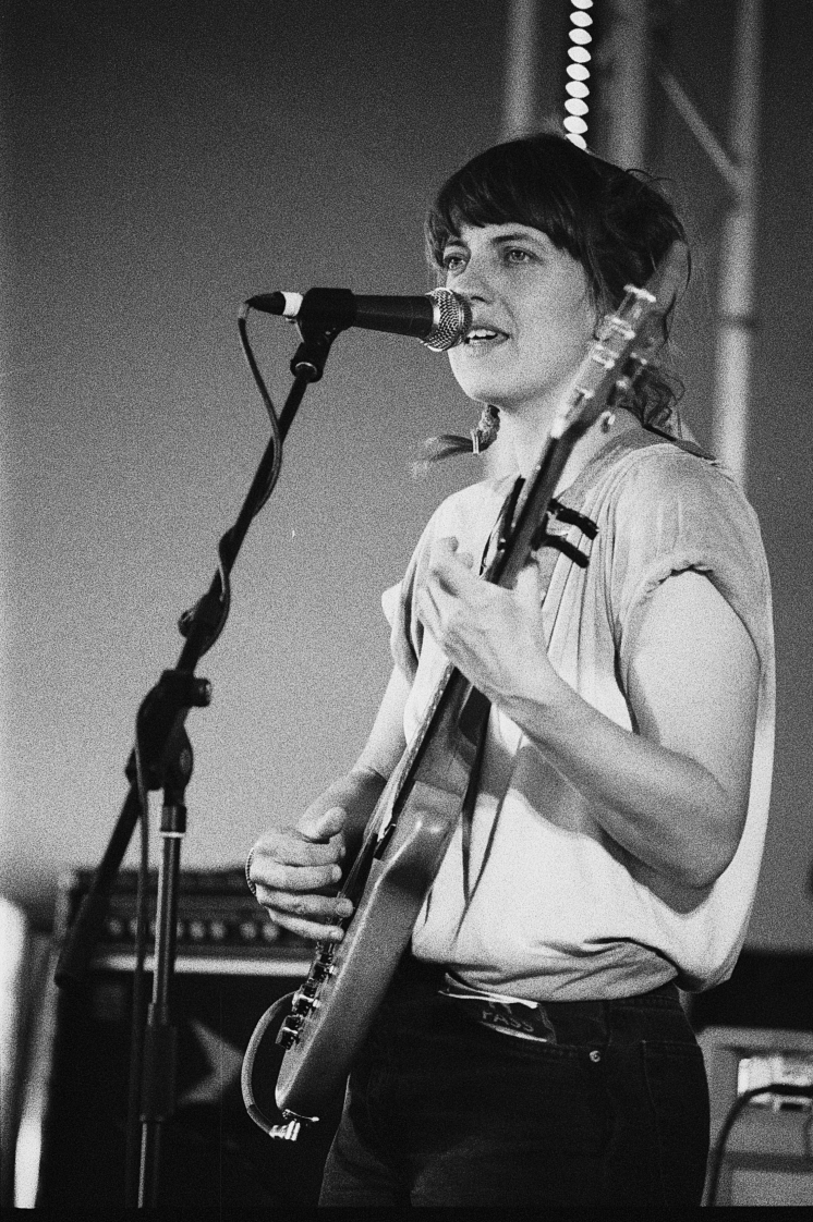

thought you might be interested in these results. I usually shoot Ilford Delta 3200 at concerts but was interested to give Kodak P3200 a go. I had some Delta 3200 in my Nikon F3, so used that on the first set, then switched to P3200 and carried on. Both rolls were both exposed and developed at box speed in Microphen using Ilford's recommended times, 9 mins for Delta 3200 and 12 mins for P3200. I've selected two frames with similar compositions (all scanning settings were the same). The lighting, exposure etc etc were all the same. P3200 is at left, Delta 3200 at right. My feeling is that the grain on the Delta is finer, less pronounced, and that Delta can hang onto the highlights and still keep shadow detail but looks a little more 'muddy', P3200 has crisper grain and more punch but shadows block up. The P3200 got three more minutes in the soup mind you. Results are close but personally I think I slightly prefer the P3200 but it's likely differences could disappear in printing.
Interesting. The P3200 looks better to me, though, you can’t really make a judgment call on the tonalities and highlight shadow detail between the two unless they were both developed to the same contrast. Following the recommended time doesn’t necessarily mean the same contrast, for example, in XTOL, the recommended time for Ilford films results in a different contrast than the time for Kodak films. The difference is slight, but enough to make doing a tonal comparison less than ideal. I know Ilford says their time results in a “normal” contrast for Ilford films, though they don’t specify what normal is. I’d assume the ISO standard of 0.62, but without testing it, it’s hard to tell, the same goes for P3200, Ilford doesn’t really specify what you’re going to get contrast wise, which makes things like shadows blocking up or highlight retention kind of moot.
You can not develop Delta 3200 to match contrast of any film, because its characteristic curve is very concave, i.e. it has high contrast in weakly exposed areas and very weak contrast in strongly exposed areas. This weak contrast in strongly exposed areas will not go up with longer development times either. If your main subject matter is in the mid or highlight regions, you will have to print/postprocess to higher contrast. In this comparison the P3200 scan shot looks nicer because it has better contrast to match the scene, whereas Delta3200 scan shows much better shadow contrast.
If you increase Delta 3200 scan contrast to match the P3200 scan,

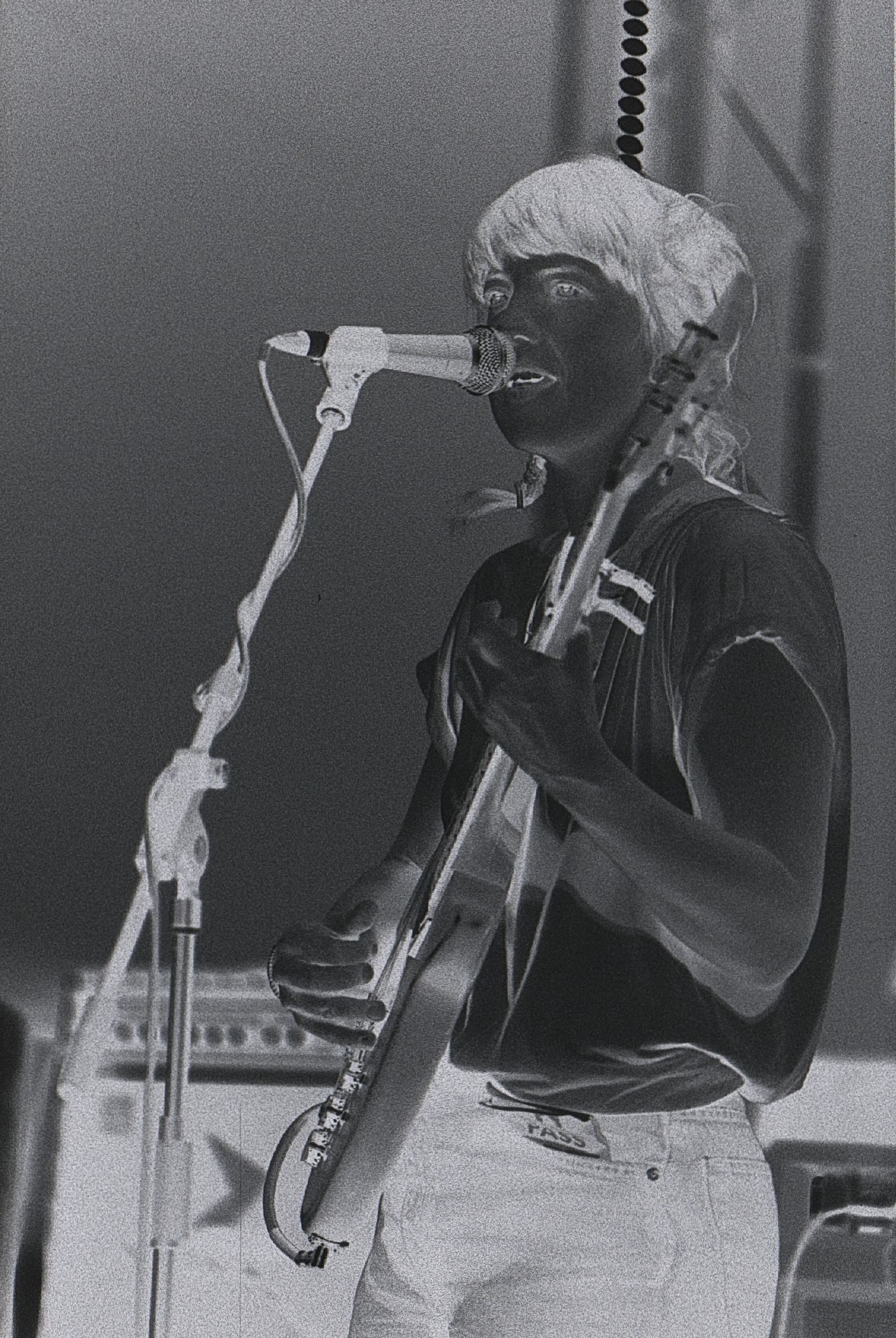

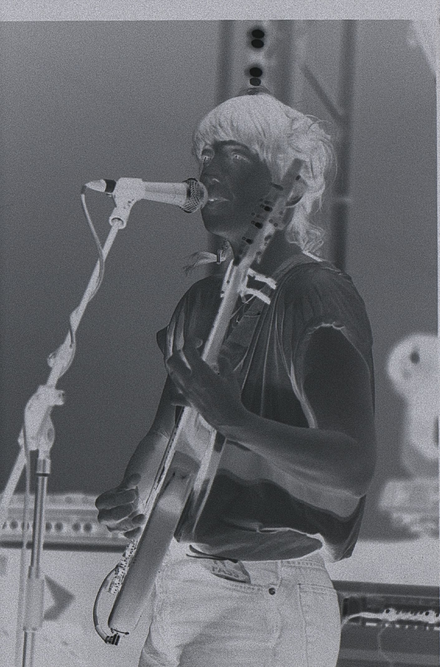

These are the same negs, as flat as I can get them (all sliders set to zero). I'm no expert in scanning mind you! Again, P3200 at left, Delta 3200 at right. To my eyes, not a great deal of difference, Delta seems to hold more detail in the shadows than P3200 at the recommended development times. Someone who is better at printing than I am may be able to make use of that, but from my experience, the P3200 looks easier to make a nice easy punchy print from. The P3200 seems to have more obvious grain though. Comparison side by side on the light box, the Delta looks a bit thin compared with my usual HP5+ and also against the P3200.
If I just invert and bring the black and white points in to the edges of the histogram, they look very similar to me. That may well reflect more on me though. I mean, they do look a bit different, as do the histograms but I suspect you could do a lot when printing.

Could you please post raw non-inverted scans of these two negatives? This would allow us to look at shadow detail. Since most of us would use either film in low light situations, half a stop more or less sensitivity would be a big deal.
