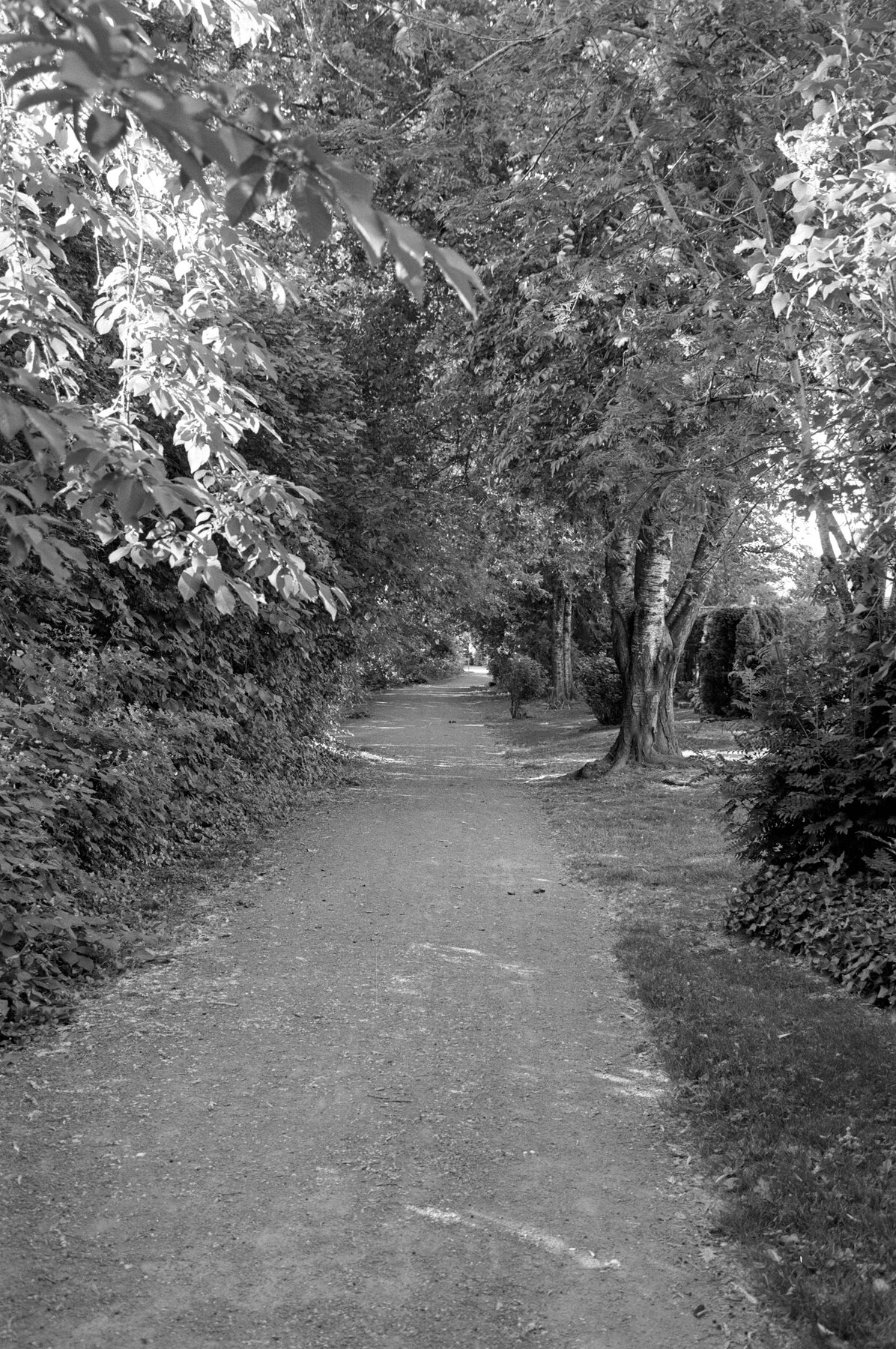

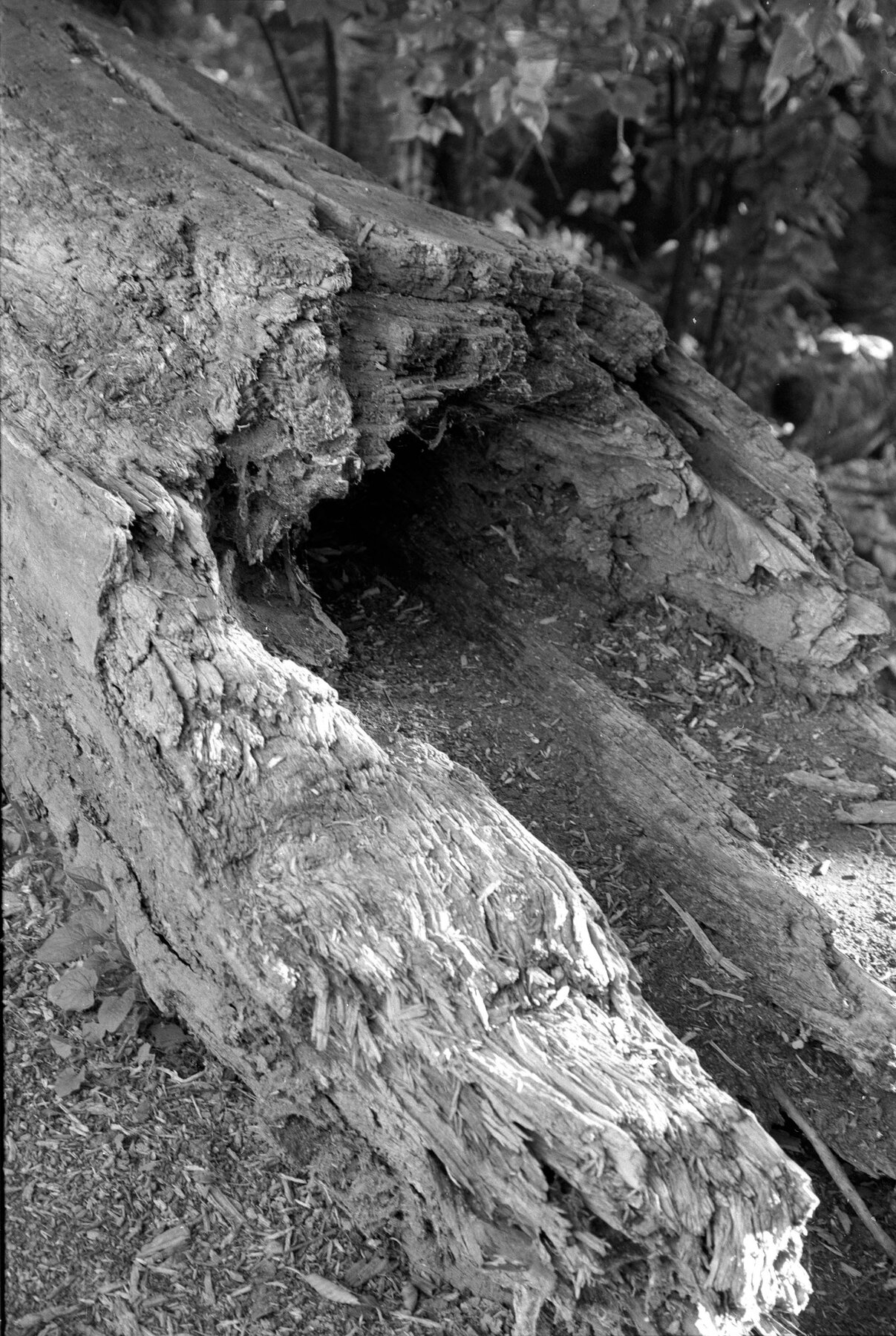

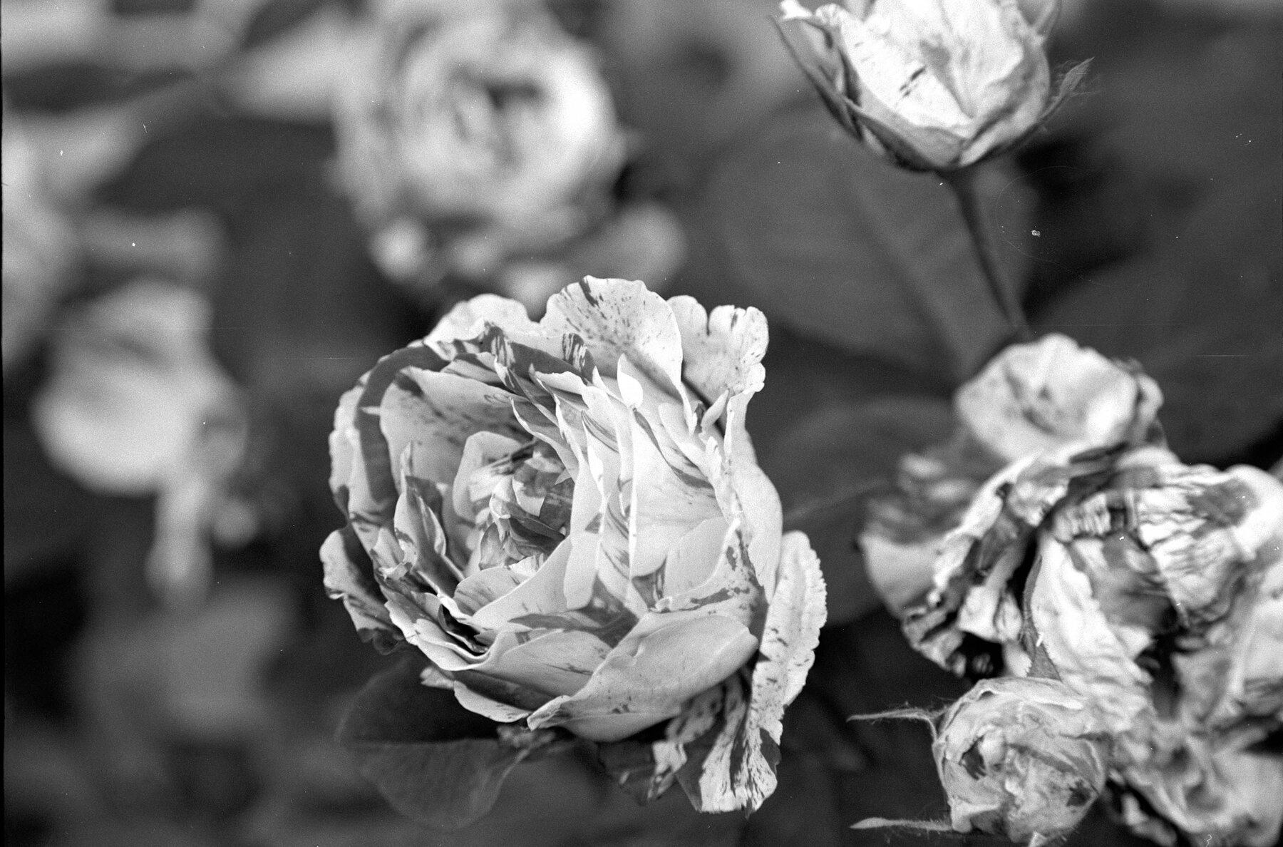

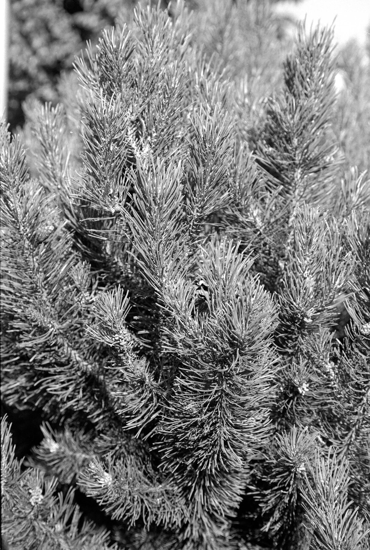

Well you guys were right. This film builds up contrast reel quick when over developed. I shot some shots already in high contrast lighting, and the highlights were blown out in some shots. Some shots looked good and the look reminded me of Delta 400 and Tri-X as far as contrast in concerned. But I think I over did it with this roll. Lesson learned. Next time I shoot some sheets of this, I'll develop as normal. It definately is a sharper film then TMAX 100, which Andy here mentioned. Some shots were quite nice, with not as flat a look as a normal roll would look like to me. But this film seems to still lack a lot of midtone definition compared to other films like Plus X and Efke 25. I'll play some more down the road with another roll. I still want to give this film a chance, but its not blowing me away either. Todays shots were better, if it weren't for the highlights being overcooked.
