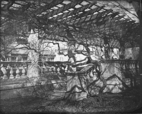

I've attached a few images from the workshop.
Mark

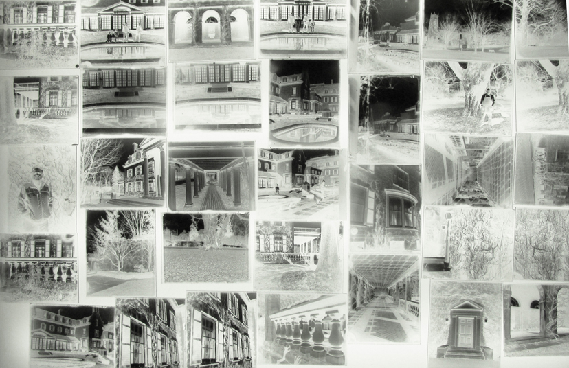

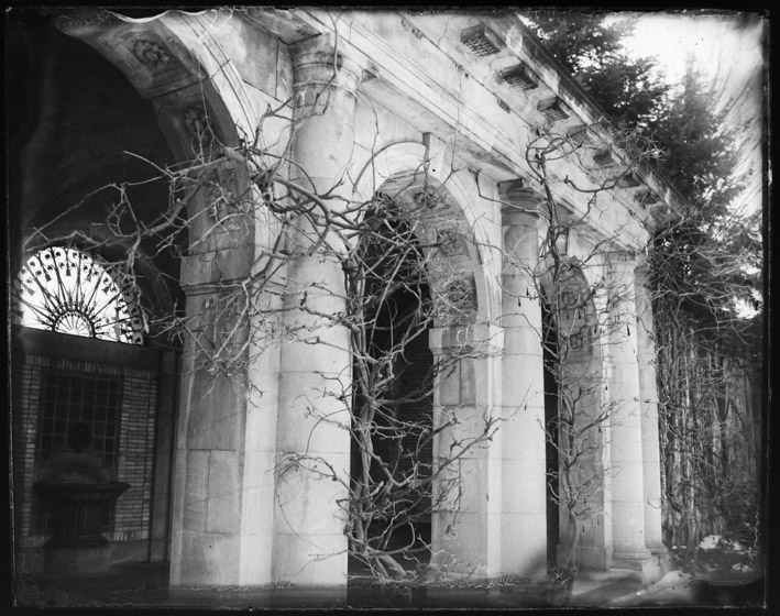

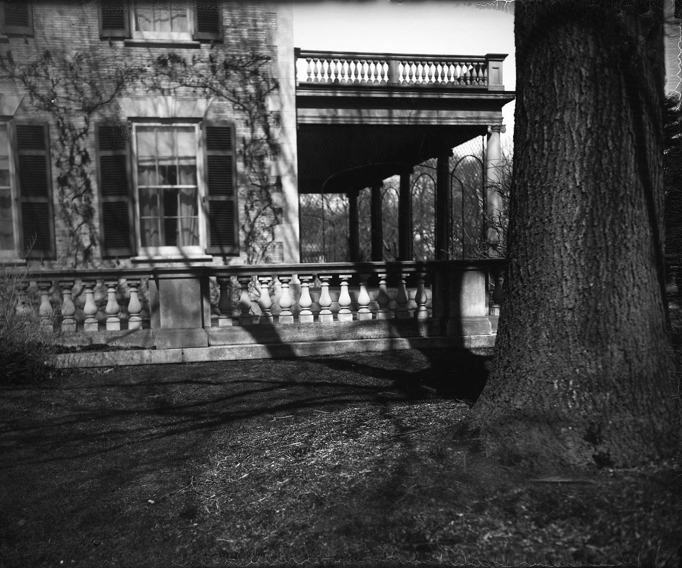

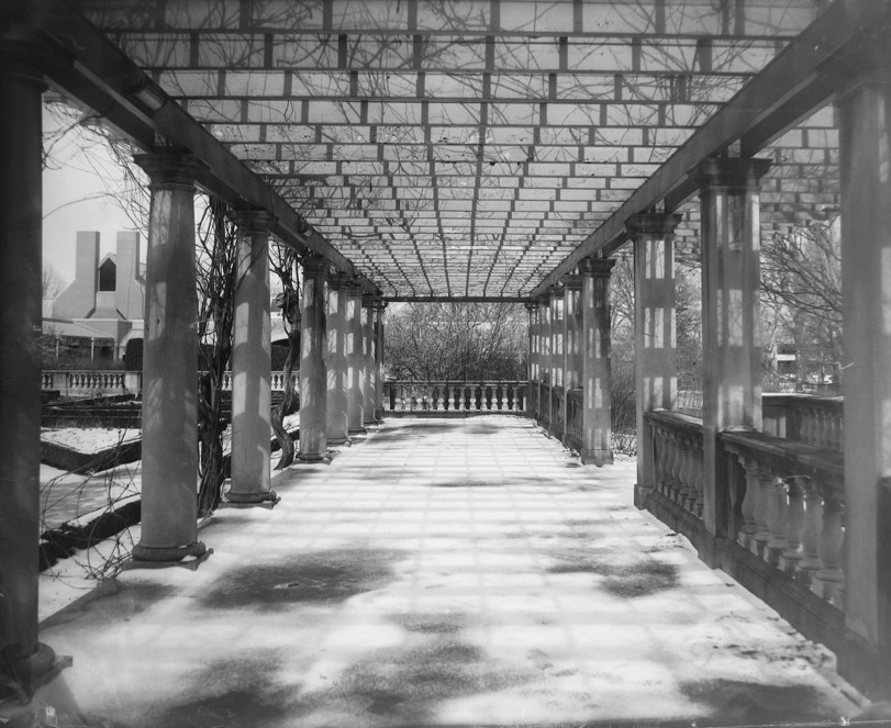

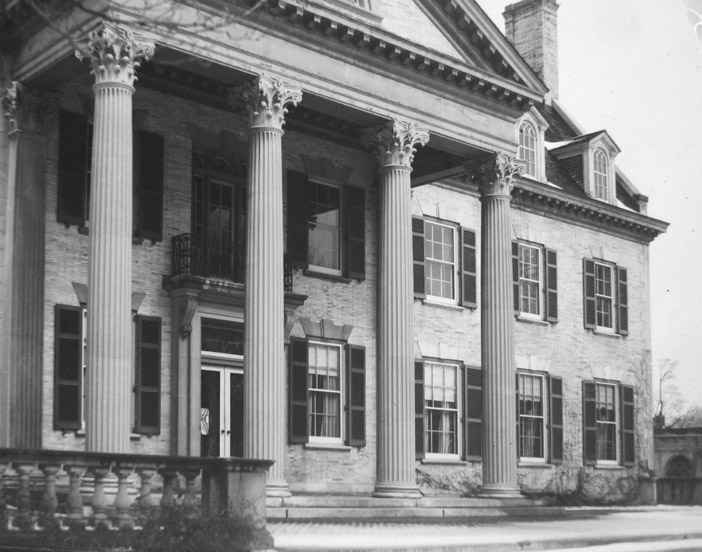

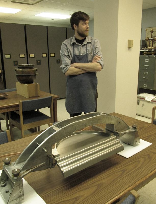

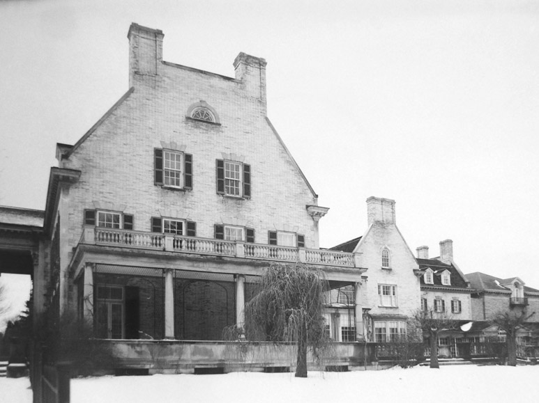

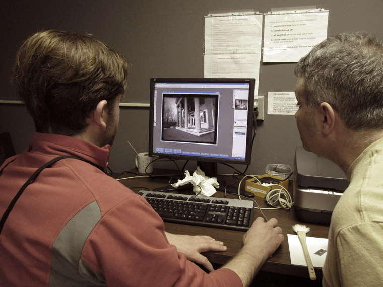

There is no excuse. If I can fly over from the UK and have a very enjoyable week, anyone can. It was a privilege to work with so many nice people in pleasant surroundings.
And of course at Eastman House which of course adds to the magic of the place. This is one of my attempts.

More Images from our Recent Emulsion Workshops
More pictures from our two recent bromide emulsion workshops. We had a real mix of crazy weather both weeks. Still, we made over 100 negatives and had some very nice test plates.
Mark
