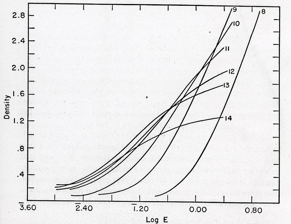

Addition times from 1' to 15' are possible for this emulsion, but difficult o do by hand. The contrast will be quite low at 15' if everything behaves as normal, and the speed will probably move about 1 stop, but it may appear to slow down due to the loss in contrast. Here is a typical curve of the usual senitometric change with addition times from 8 - 14 minutes with a given emulsion. You can see what happens to speed and density as well as contrast.
PE
Ron,
A longer addition time would produce a lower contrast, I understand that, but why would it increase speed? Is it because the grains formed first would have more opportunity to grow larger at the expense of the smaller grains than in a more monodisperse emulsion?
-- Jason
You get more speed for the same reason that you get lower contrast. You get a broader size / frequency distribution. There are more fine grains and more coarse grains. With a very fast addition, you get grains that are more nearly alike and they are smaller.
