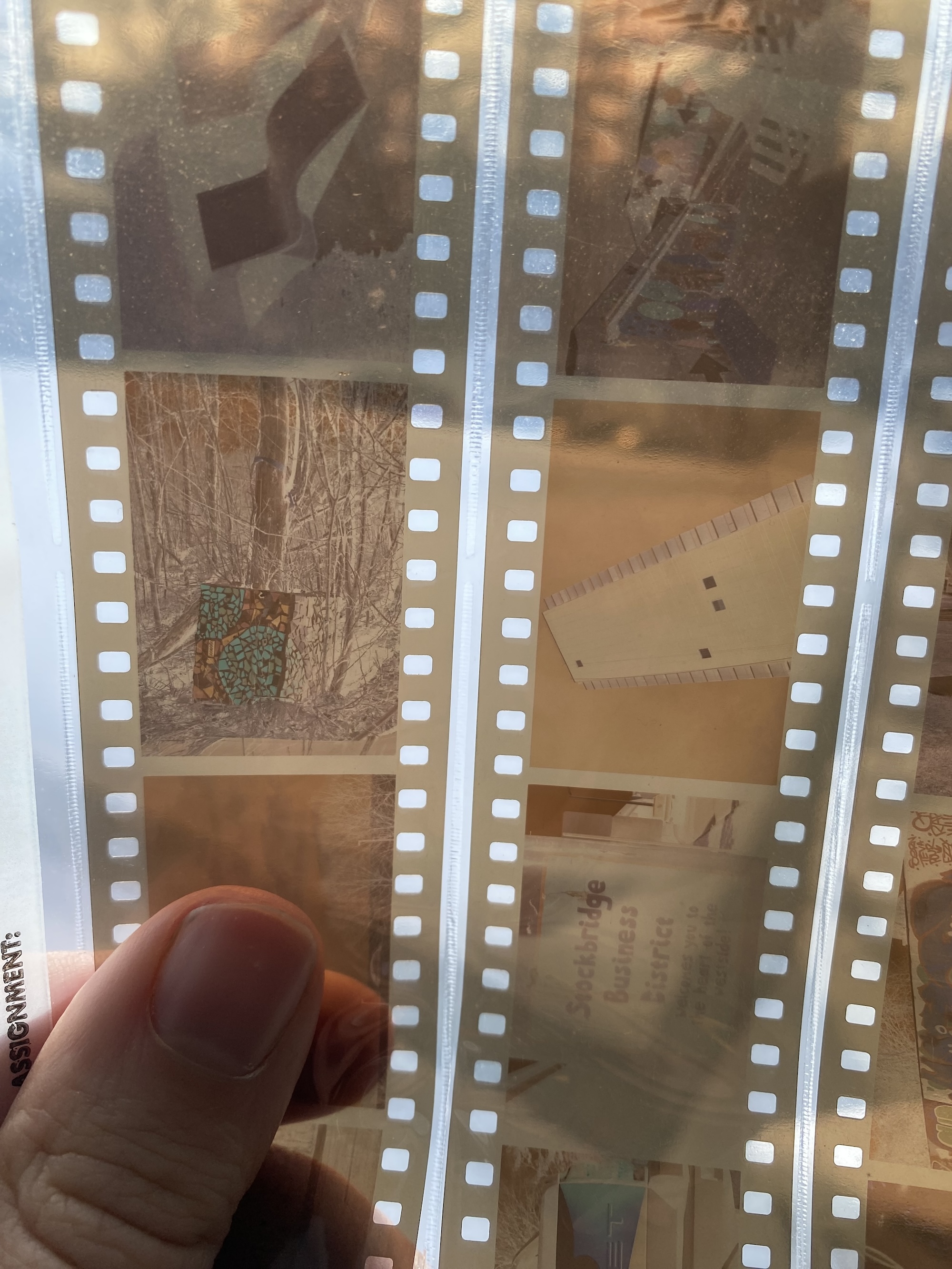

Does your NC400 negative look like the negative second from the left (NC500 is third from the left)?
Plain white paper or white glass or acrylic taped to a North facing clean window pain, will smooth out the viewing for most of the skylight day.
A wood lath section, it's top edge slightly beveled, with the lower side against the window side, held in place against the white sheet with double stick tape, can hold negatives and slides upright in position for hands free viewing.
IMO.
my NC looks a bit more green while the summer of 92 definitely looks a little more cyan

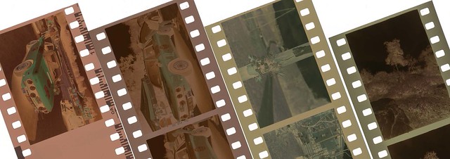

Such statements on the basis of the kind of scans we usually make at home are generally unreliable, unless you're scanning samples of both film side by side (e.g. on a flatbed) and performing the same color corrections on both (see e.g. @brbo's example of the 4 strips side by side). Also keep in mind that notions like "I scanned them using the same profile/same scanner settings" are a sure-fire way to get lost in the woods, since scanning software generally applies all manner of auto-corrections that will shift the color balance around without your being aware of it.
Judging color negative film on the basis of scans is an extremely slippery slope.
