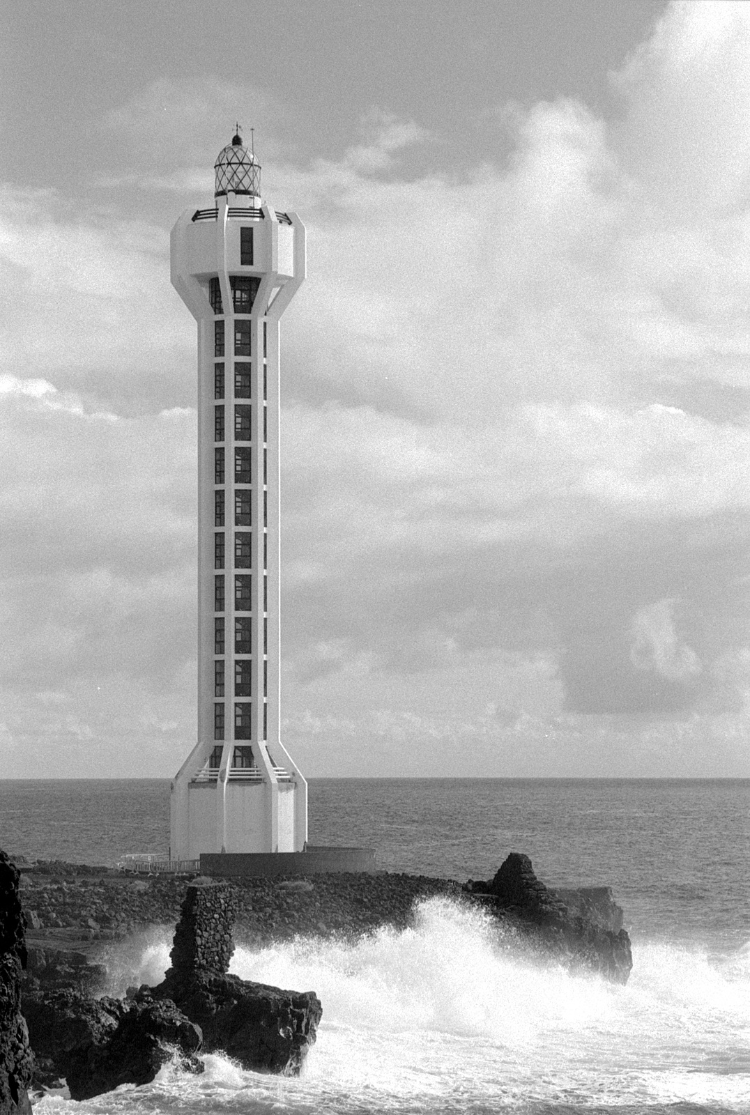

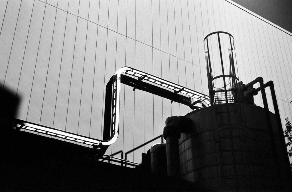

The sample images were taken at the island La Palma. Plustek Opticfilm 7300.
Pentax LX
Pentax SMC-M 2.8/100, orange filtre
Pentax LX
Pentax SMC-M 4/20, red filtre
