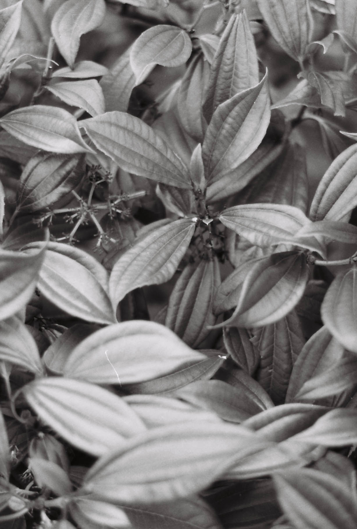

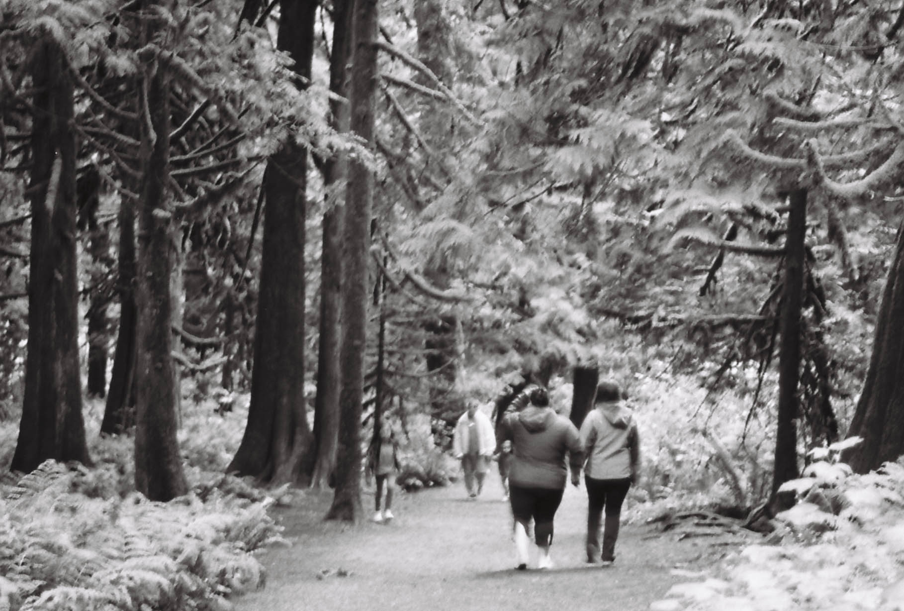

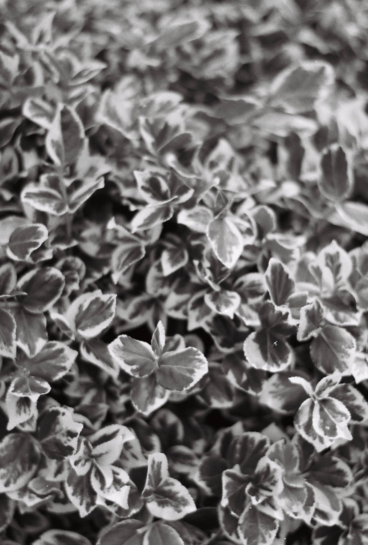

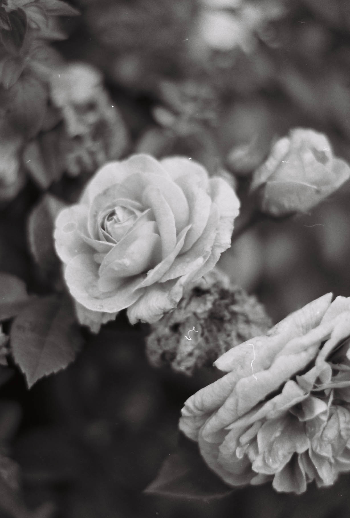

Well the results I got back for the 1 roll looks pretty darn good for a 30+ year old roll of film. The lab managed to deal with the curl, as it came back fine. I couldnt detect any fog on the roll. I shot it at box speed as well. Here are a couple shots.
8 rolls are for sale if anyone is interested.

Braxus, it might be my eyes or simply the scenes you have taken but none of the scans (of negs or prints?) seem as sharp in focus terms as I would have expected.The silvery-white foliage in the forest shot give it an almost IR which I would not have expected either
As I said it might be my deteriorating eyesight as pentaxpete has made no comment to the same effect
Well the one in the forest the light was low, so the shutter speed was really slow. It blurred as a result. Also the scans were low rez, so I wouldnt expect eye popping sharpness from them either. On the other ones, low depth of field resulted in loss of sharpness there. I dont know if there are better samples I could show, but it still shows the film as usable.

The resulting photos look good. It's said that low speed films fog more slowly over time than medium and fast speed films, and this is good evidence of that. In the 90's I got one year expired Plus-X in 120 from a friend, and those rolls had developed a slight but even fog. My guess is that they had been improperly stored (heat).
Are those yellow or red roses? They look lighter than what red roses would look on pan film.

BraxusThanks for the explanation on the scans. It always worries me when I see something in a scan that no-one else seems to pick up on. I am glad that in this case it wasn't my eyes:D

The tonality on the scans is good but yes, definitely soft. I don't think that's a low rez issue but could be a scanner issue. Seems like a lot of stuff on the negs as well. This is always a potential problem when sending film out, it can often only be as good as the operator that day and/or whether all is well w/ their chemicals. Looking at some Lomography examples, it's not supposed to give soft pics, but is low contrast judging from what they show.
