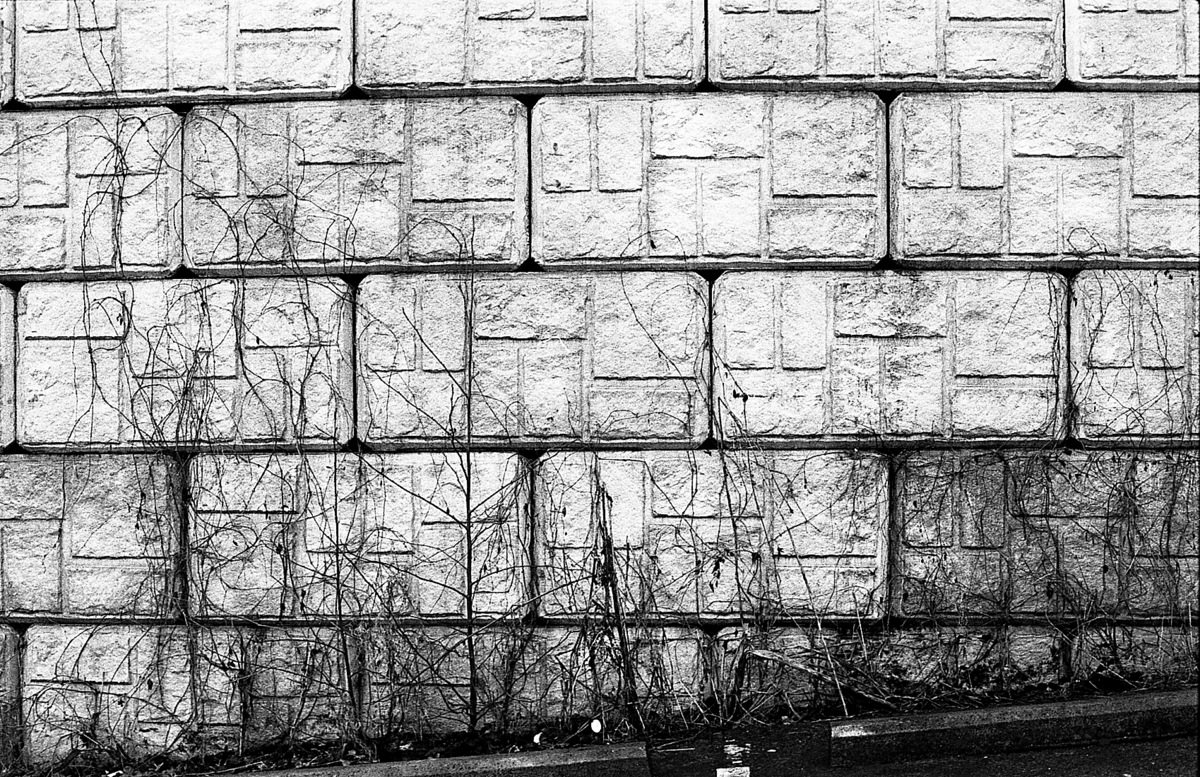

I did my first film run with new ORWO UN-54 developed in Agfa Rodinal 1:50.

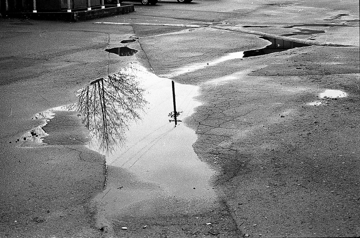

Hello all. My first roll of ORWO UN-54 film (EI 80) Developed it with the recipe from Goran. (Who also lent me 2 rolls). The N74 is in the camera now.

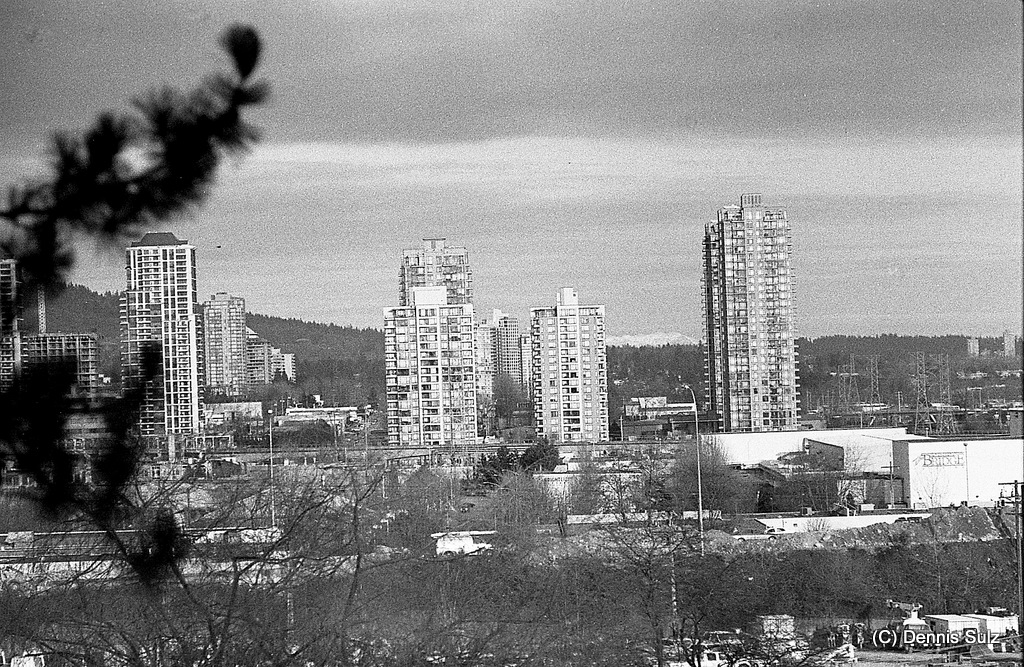

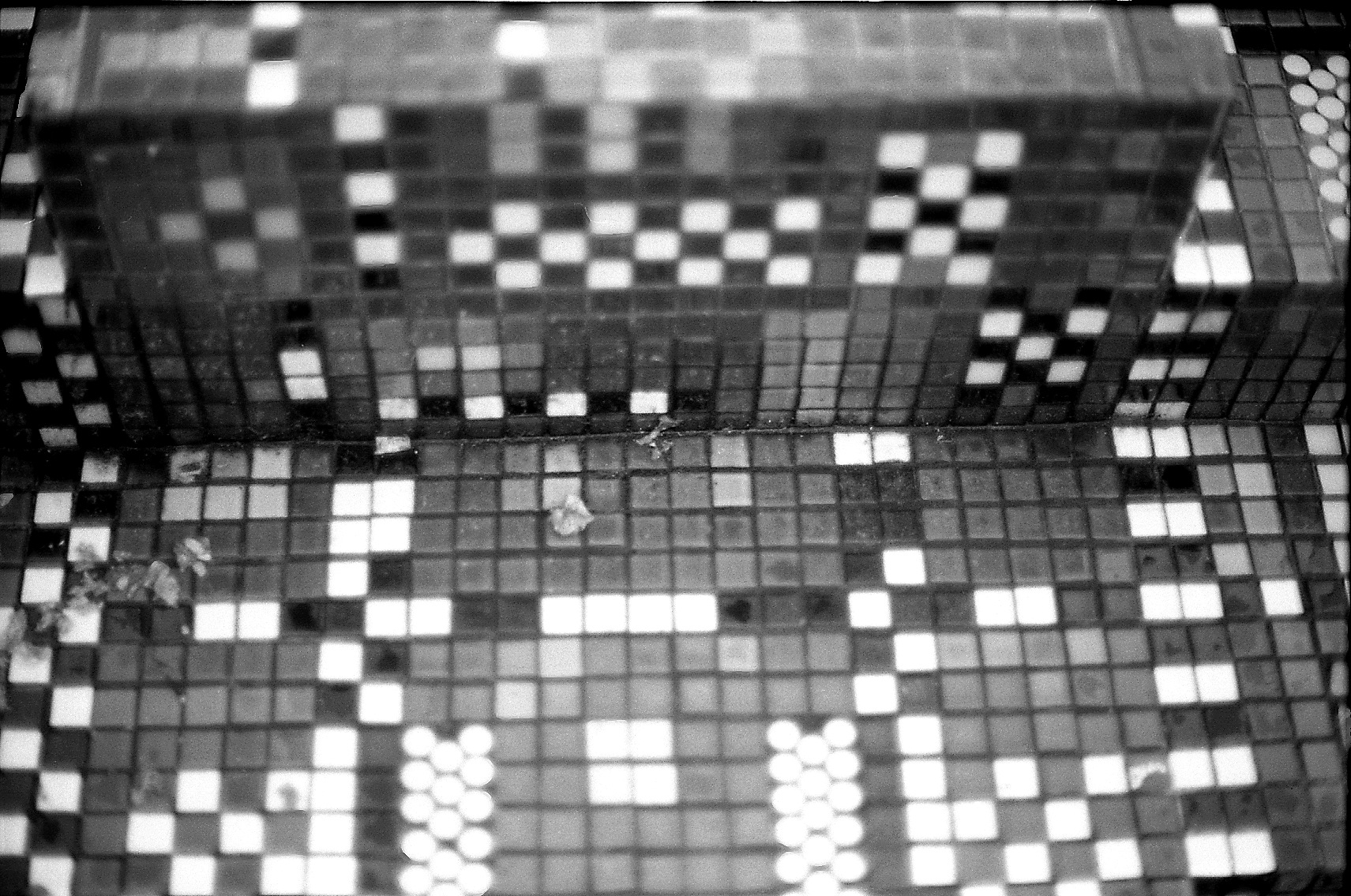

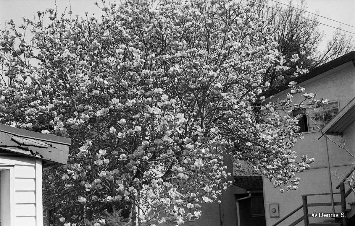

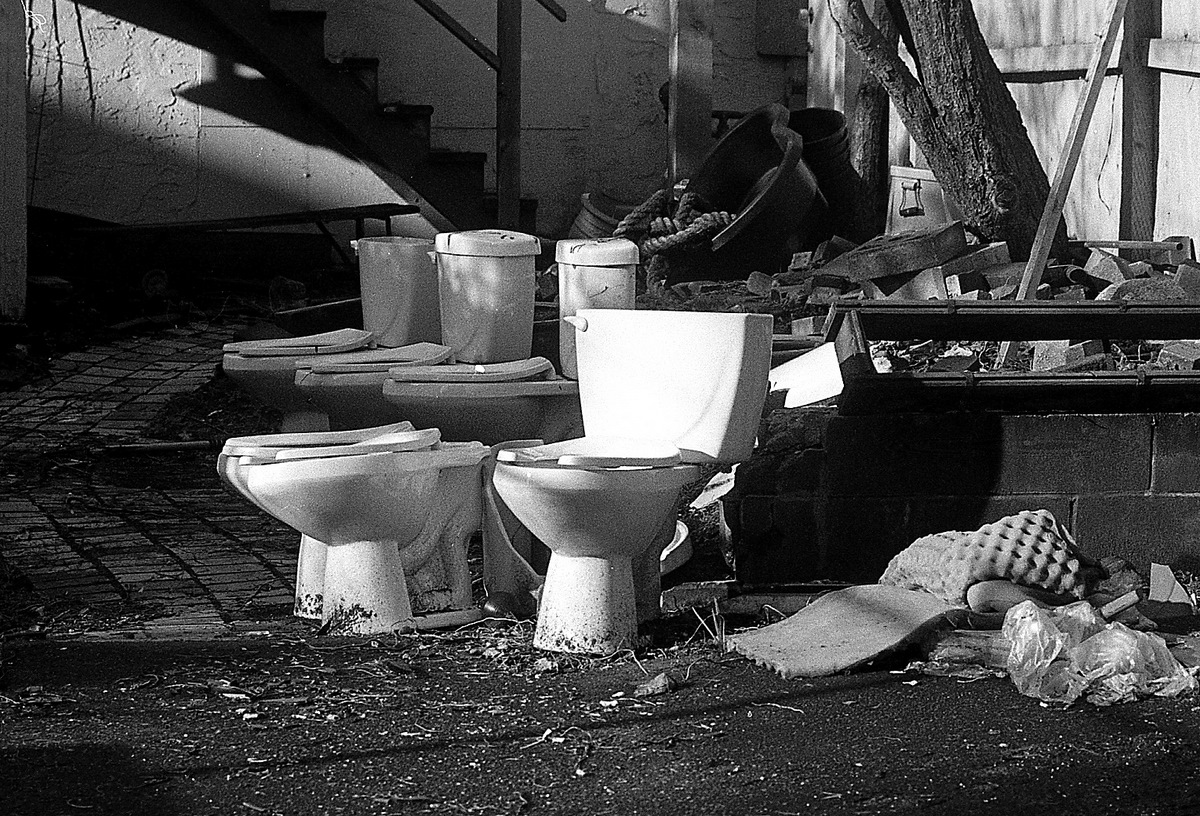

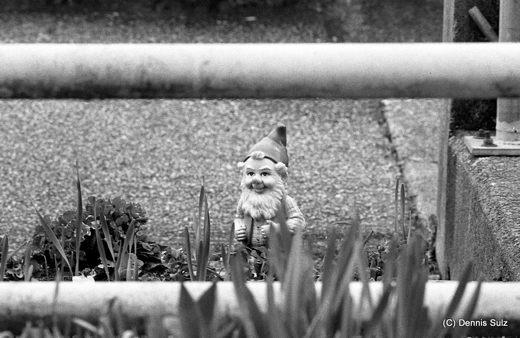

Finished the ORWO 74. I developed it with Xtol 1-3 but not too thrilled with that recipe. Like to have done it with Rodinal and expect the grain. gorbas.. How old was that film ? It seemed a bit fogged but the Xtol might have been a bit aged. It was the last of a 5L batch .:D

Dennis, all film Tom A., you and me used come from the same 2 - 100' rolls. One of Un-54 and one N-74. They were send to me by ORWO NA and I assume they are fresh. I didn't noticed any fog issues,as well as Tom. I never tried Xtol 1:3. Its kind of crazy to test brand new emulsion in "questionable" developer. I can see way to high contrast on your pictures, but I'm not sure is it from negative or post-processing?? Also negative exposure for was on shorter side to. Keep shooting!

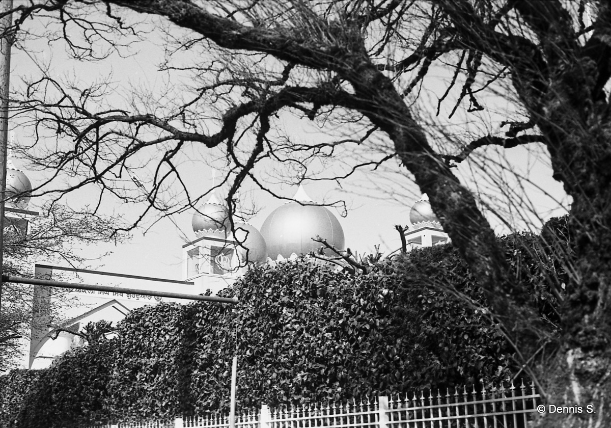

Hello again Goran. I guess I did not do my research enough when I looked through the ORWO site and found your recipe for Rodinal 1-50 for 13 minutes. Or as Canadian say "Blazinal". The next time as my only option now. Also a great picture of Science World.

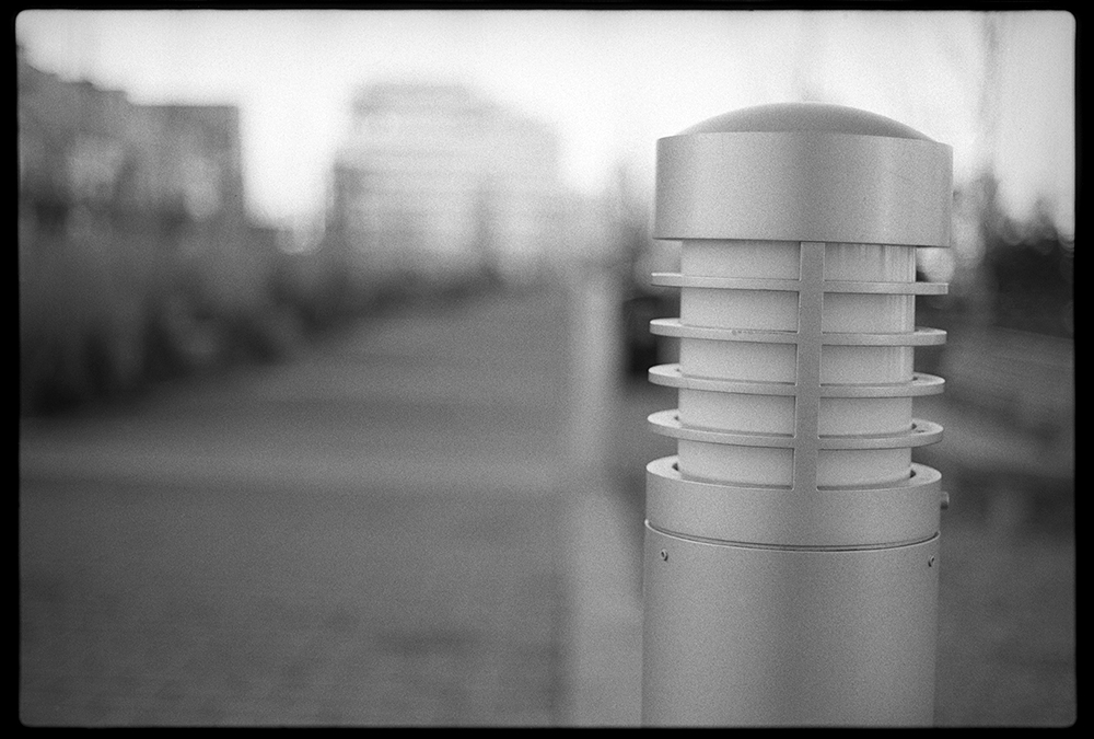

I just developed and scanned by first rolls of NP74 and UN54.
NP74 has attitude, may have been using slightly dead Xtol but it's very grindy, but I love it.
UN54 wow, just wow, I developed in PMK Pyro (since my Xtol was slightly dead), and just wow, so much dimensionality in the film.
Tech Details:
NP74 - Nikon F4 - AF-S Nikkor 14-24mm 1:2.8G - ORWO NP74 @ ASA-400 Developed in Xtol (1+1) 13:00 @ 20C
UN54 - Nikon F4 - AF Nikkor 35mm 1:2D - ORWO UN54 @ ASA-100 Developed in Photographer's Formulary PMK Pyro (1+2+100) 13:00 @ 21C

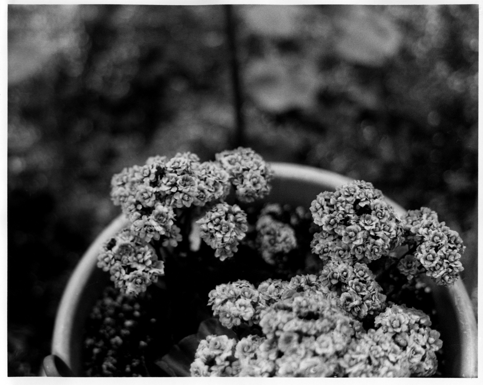

Having fantastic results from UN-54 in Pyrocat HD /wth Glycol.
Great combination. I sure like the outcome of the negatives. Printing them is a pleasure. I have a few rolls of Orwo N-74 but can not find a time or dilution using Pyrocat HD. Has anyone used it with pleasing results or is it just a waste of my time and film testing it. ?
This is a print of the Pyrocat N-54 negatives using Studio VII VC/RC.
