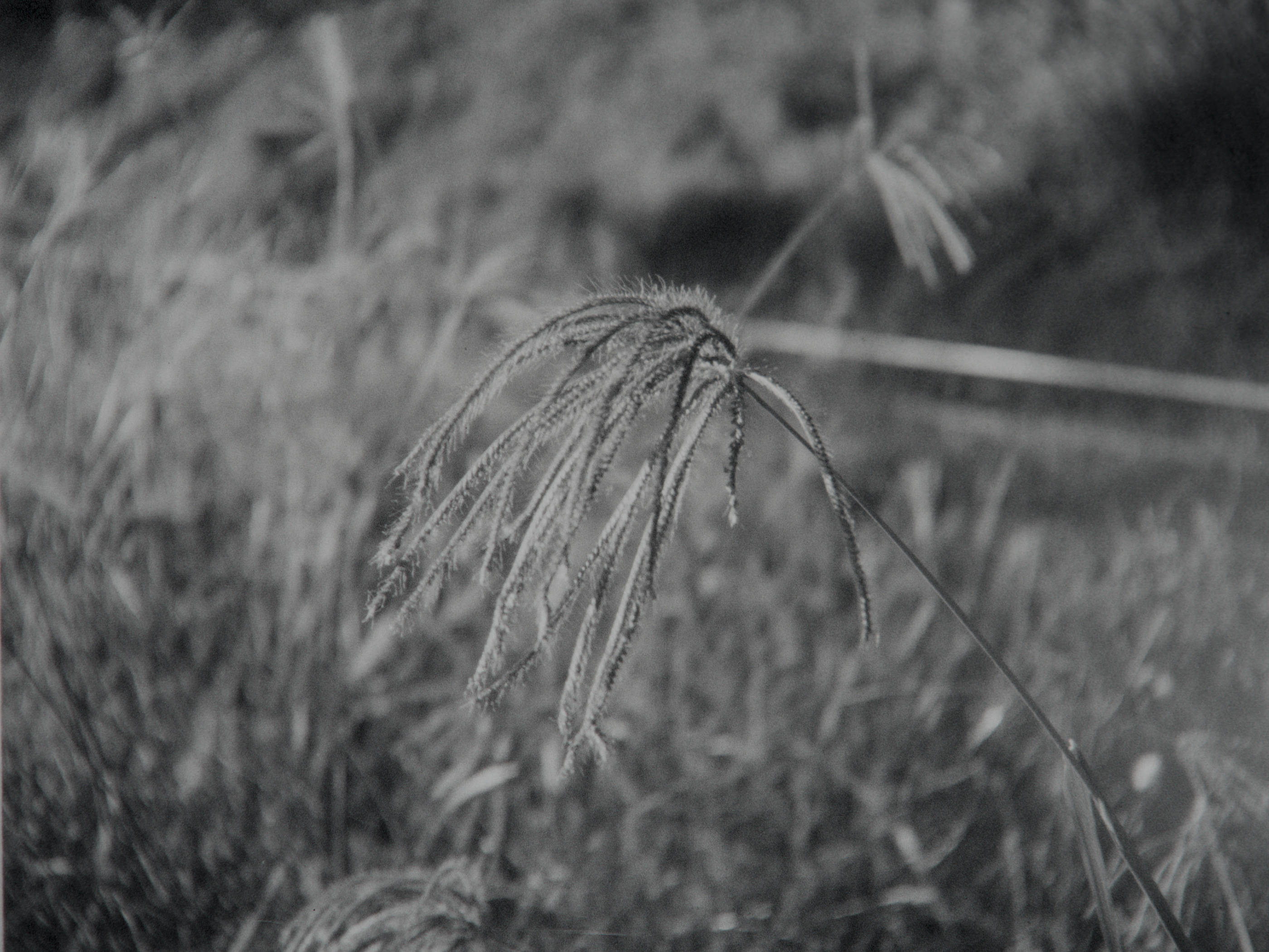

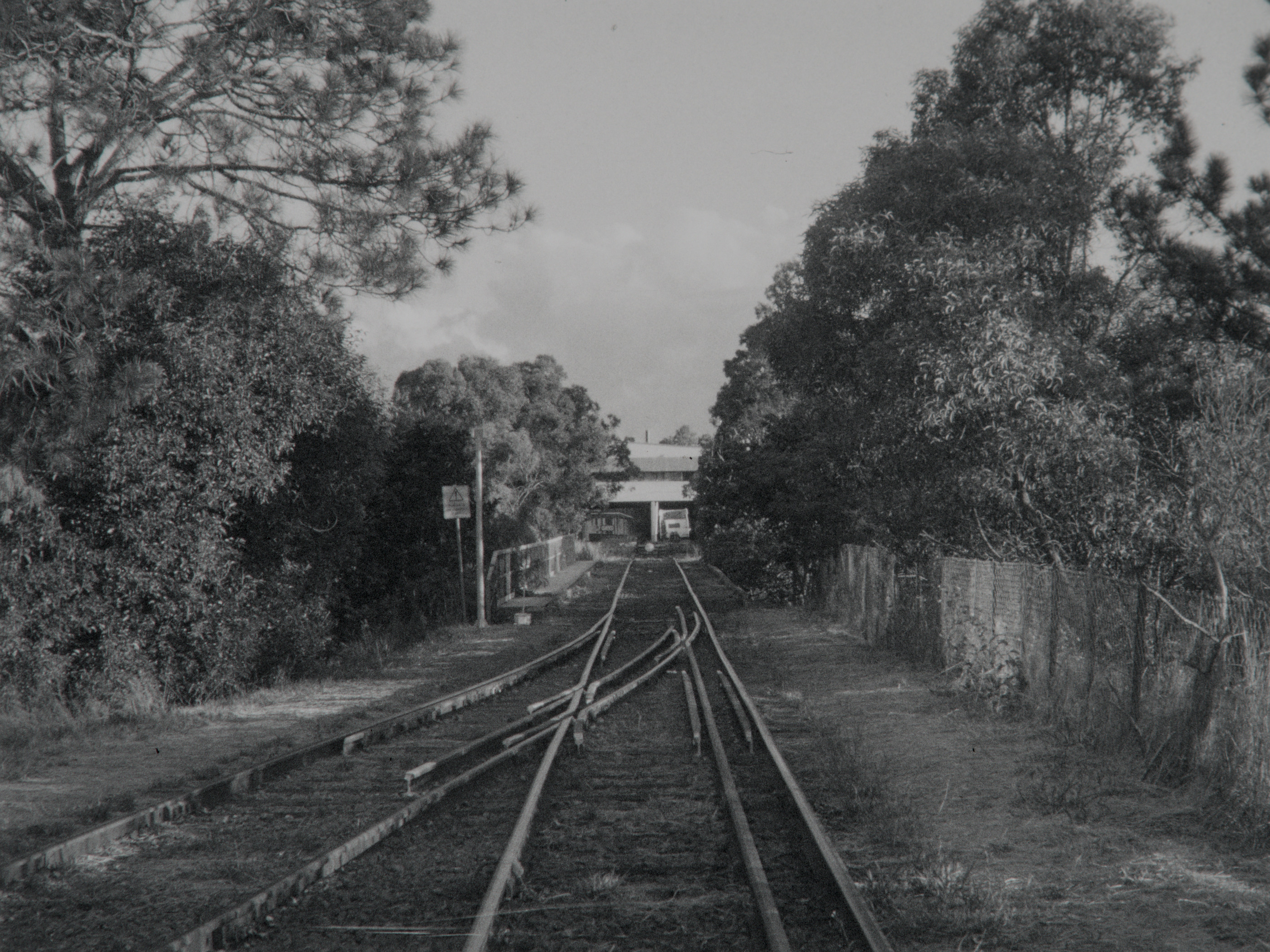

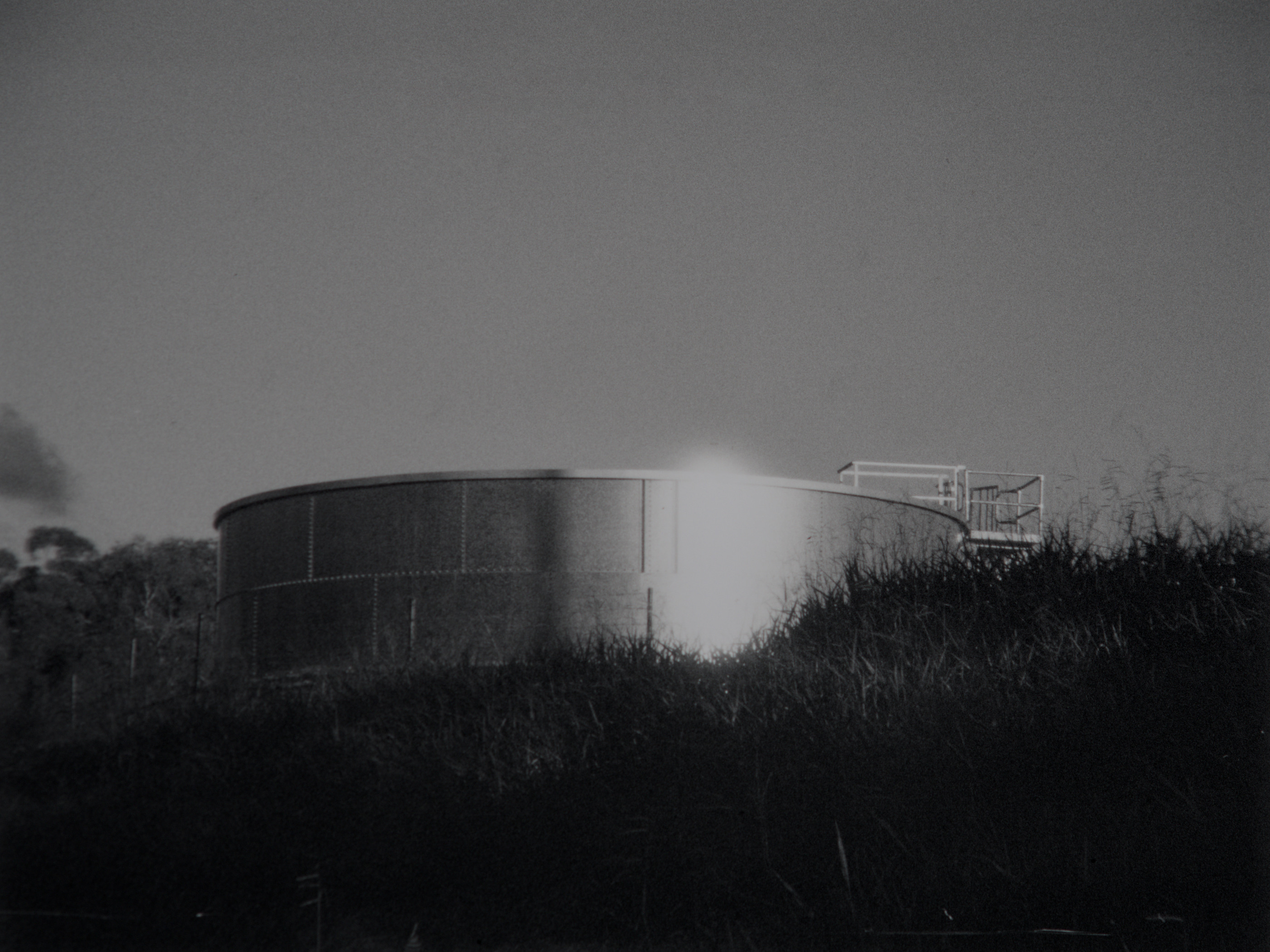

Noticing the "made in the czech republic" mark on the Orca 110 box, I went out and shot with the 20-40mm lens on my Pentax Auto 110
I processed the film exactly to the instructions in the Foma Reversal Kit, with no deviation besides using a hardening fixer for the final step

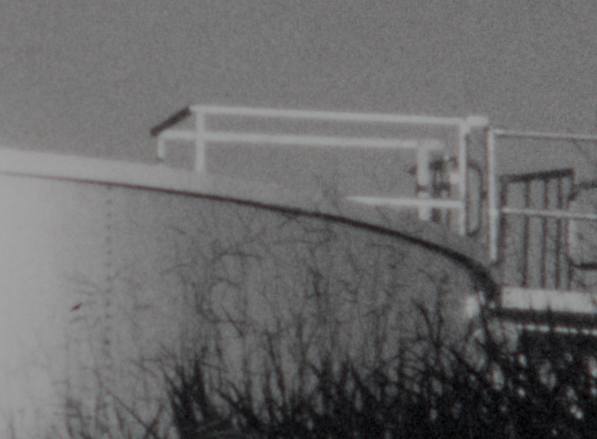

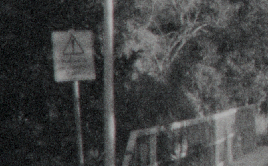

Here are scans, and then 100% crops, because I was really impressed at the resolving power of the zoom, and the film!
The results are so nice, I almost prefer it to the negative results I've gotten, seeing such tiny reversal film is magical.
Try it out for yourself!
Nice work! Positives can give some of the finest results when you get the exposure right.

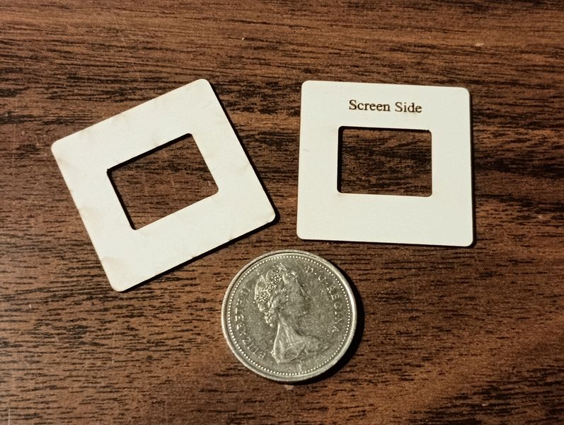

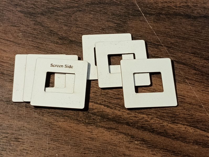

Now all you need are slide mounts to fit the pocket Carousel...
LOL
Your scans are not revealing the true detail on those negatives. I see chromatic aberration typical of a flatbed scan.
This means there is even more detail in those negs.
