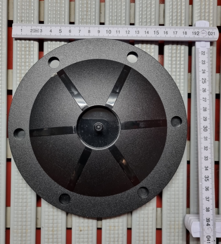

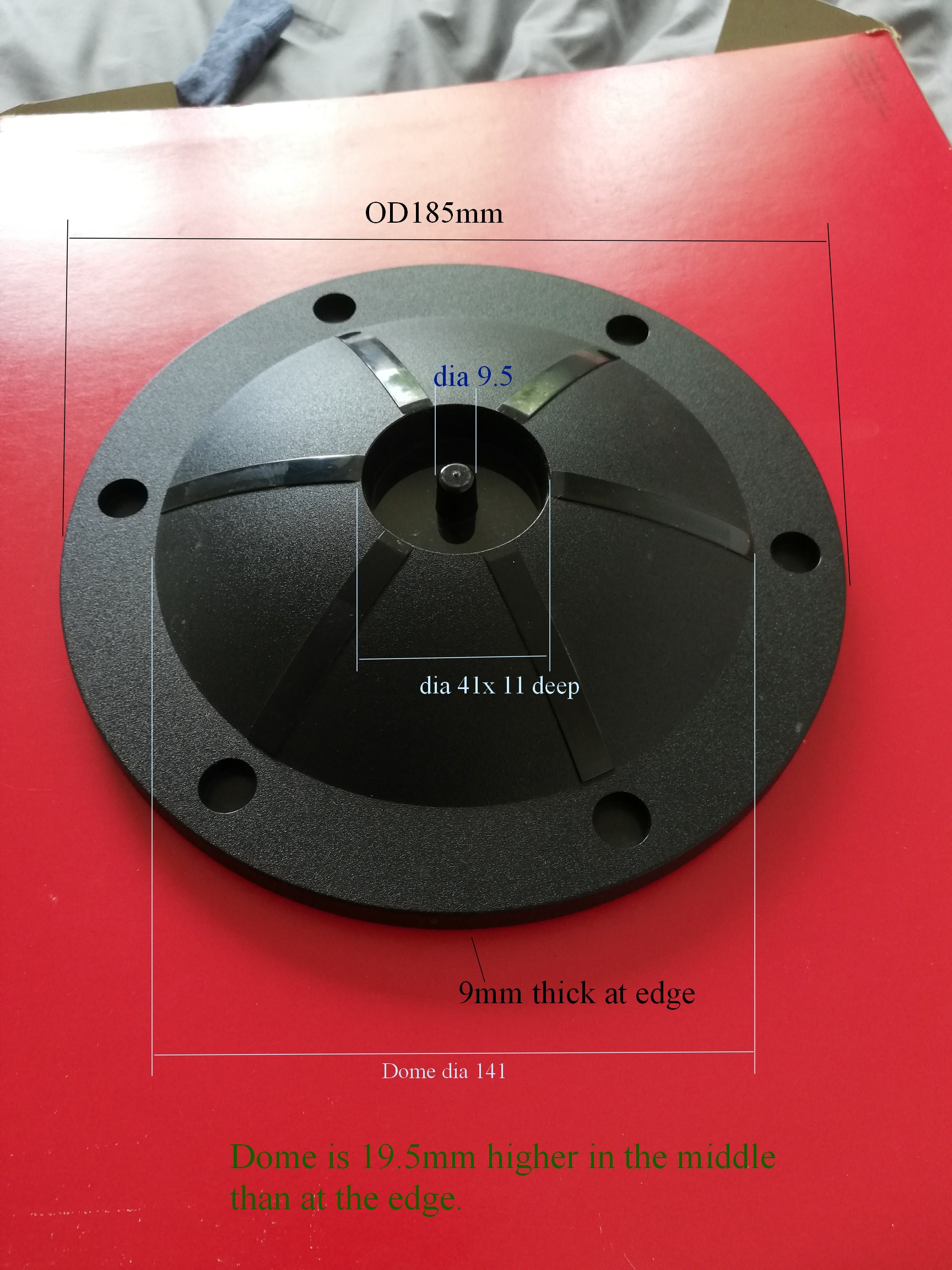

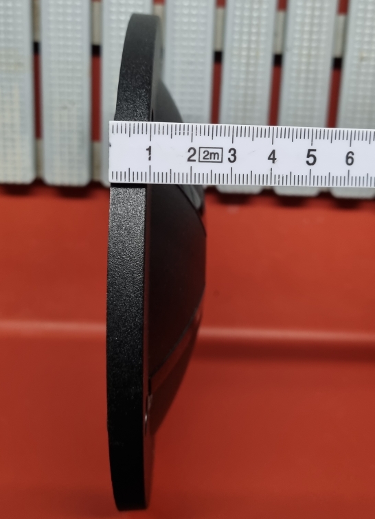

Does anyone have an Orbital processor with the manual base? I just got one but without the base. It gets a bit tiring rotating it by hand for 15 mins :smile:
If someone gives me the dimensions, I can probably 3-D print one.

Here are the dimensions, but remember the resulting tilting angle is designed for the original amount of chemicals.
