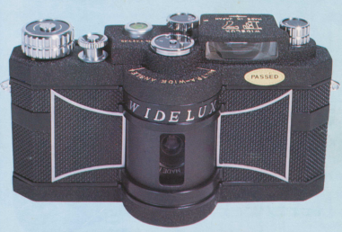

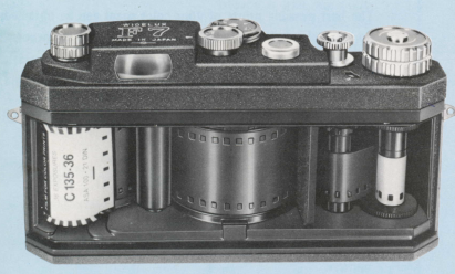

I'm confused. You seem to be describing two different camera designs.
  • sweeping camera: the lens is on the axis of the [|film] cylinder, right in front of the film
  • anamorphic cylinder camera: the film is also along a cylinder, but the lens is (as you state) along the axis of the cylinder, above the film; completely different from first one
From the Widelux manual (buktus.org)
from: http://ericconstantineau.com/photo/review_anya_en.html
"anamorphic cylinder camera (...) have lens at the top of the cylinder" as per your statement

My confusion just thickens, like @OAPOli
Maybe I'm thick? I still don't know which of the two kinds of cameras pictured in my post above you are planning to design. Possibly some hybrid, but which one?

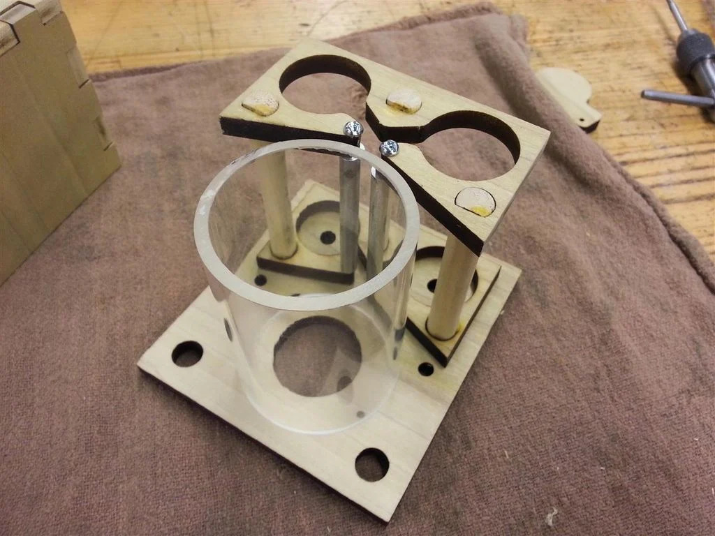

Hello Bernard,
these are anamorphic pinhole cameras. I replace pinhole with enlarger lens.
As you see film is rolled on rails or glass tubes - I prefer rails-
Let me tell you what am I doing.
Lets look at glass tube , there is film around it , I put a second black tube inside of glass tube. This second tube have long slit on it and it rotates with motor.
When slit starts and stops , it uses few seconds and this is time sweeping

Hello Bernard,
