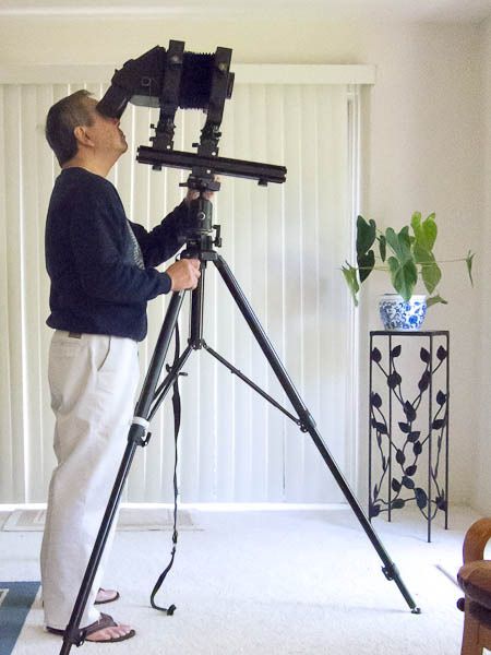

I have the Horseman binocular FOLDING hood for my Horseman monorail. I love mine, but...A disadvantage that you need to keep in mind are the situations in which you must set the camera position higher, and now you have to have a step ladder to climb up to be able to look down into the binocular viewer!

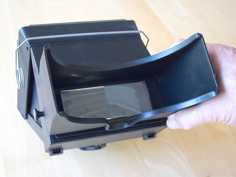

Here's a photo of my Horseman folding binocular reflex finder, collapsed
then open and ready for use, shown in the downward looking view for a camera at relatively low level (unless you are on a ladder)
then positioned as if the camera were aimed downward
then shown with me looking upward for focusing when the camera is up high
