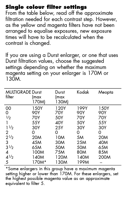

Multicontrast papers can be exposed in different ways, using
-) plain filter in filter-tray
-) optical grade filter below lens in swiveling holder
-) mixing chamber head dedicated for these papers
-) mixing chamber head dedicated for colour papers, but using a filter table
You seemingly intend to use a colour papers head. Here you either can use
-) optical grade filters under the lens (Ilford offers a special holder for these) witgh head art white-light setting
-) the color head for filtration, employing the Opemus (Meopta) settings at the table you find here: https://www.ilfordphoto.com/wp/wp-content/uploads/2017/03/Contrast-control-for-Ilford-Multigrade.pdf

The course I’m on is quite specific in some parts of the brief and they require I use filters.. or demonstrate I have done. For example I may use a grade 2 or 3 for parts of the image. How does a grade 2 or 3 on the Ilford papers correlate to the magenta, etc on the Opemus enlarger? For example what would a grade 2 be equivalent to on the Opemus? Keeping it simple I mean. Thanks :smile:
The Ilford link in AgX's post # 3 tells you which settings (Magenta and Yellow) to use on your color head in order to mimic the #2 filter and the #3 filter.
