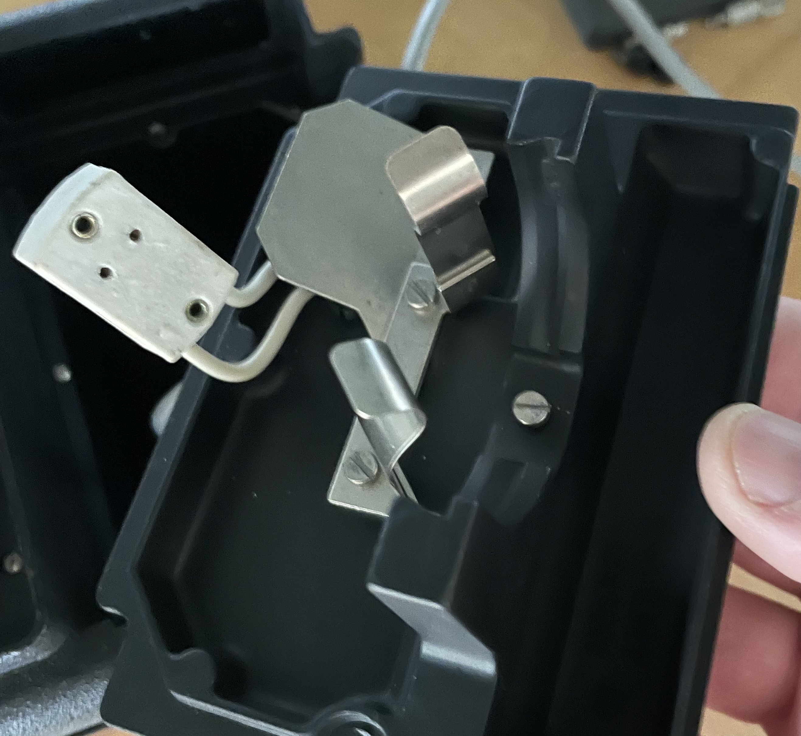

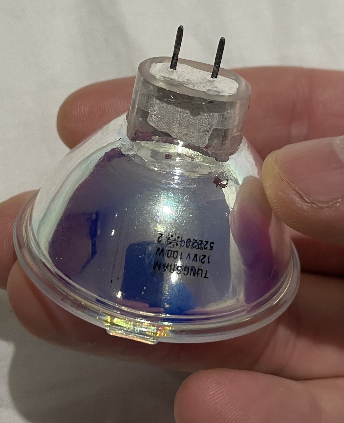

I finally got my enlarger set up and I think the bulb blew. Has anyone experienced anything like this? the chap I purchased it from doesn’t want to know and has stopped answering my messages. :sad:
It did work for around 15 mins, then just made a pop sound. I tried a new fuse and checked all
The parts and it seems fine. Does any one know where to buy these bulbs from?

That looks like an EFP bulb - which is used in a number of enlargers, including my LPL enlargers.
The contacts look quite worn, which may have contributed to the bulb blowing.
Here is a listing for a replacement: https://www.amazon.co.uk/231-EFP-100W-Effects-Lamp/dp/B000KH7S3U
One piece of advice backed by long term experience - buy two, not one. That way you have a bulb available when the next one goes, and you will be able to source a further replacement at your leisure.
When you put a new bulb in, check and clean the socket first.
You may wish to check the ceramic plug, which is a heat protection unit, these deteriorate as well and with the corrosion and pitting inside them, they can cause the lamp to blow.
It may look something like this.
iu
One can assume that used socket contacts look like the respective lamp pins.

I'll risk saying this and appearing to be condescending as you may be intending to do what I am about to suggest but in addition to a new bulb I'd seriously take the advice of the others' posts and change the ceramic holder. As was said its insides will already be like the prongs on the bulb you showed and will shorten the bulb's life as you have really only replaced half of what you need to. If you cannot find a new ceramic holder then at least until you can find one try and clean the insides of the with a sewing needle or better still with a jeweller's round file whose action files the inside and removes some of the blackened material caused by the inevitable arcing that occurs over the many times the lamp switched on and off

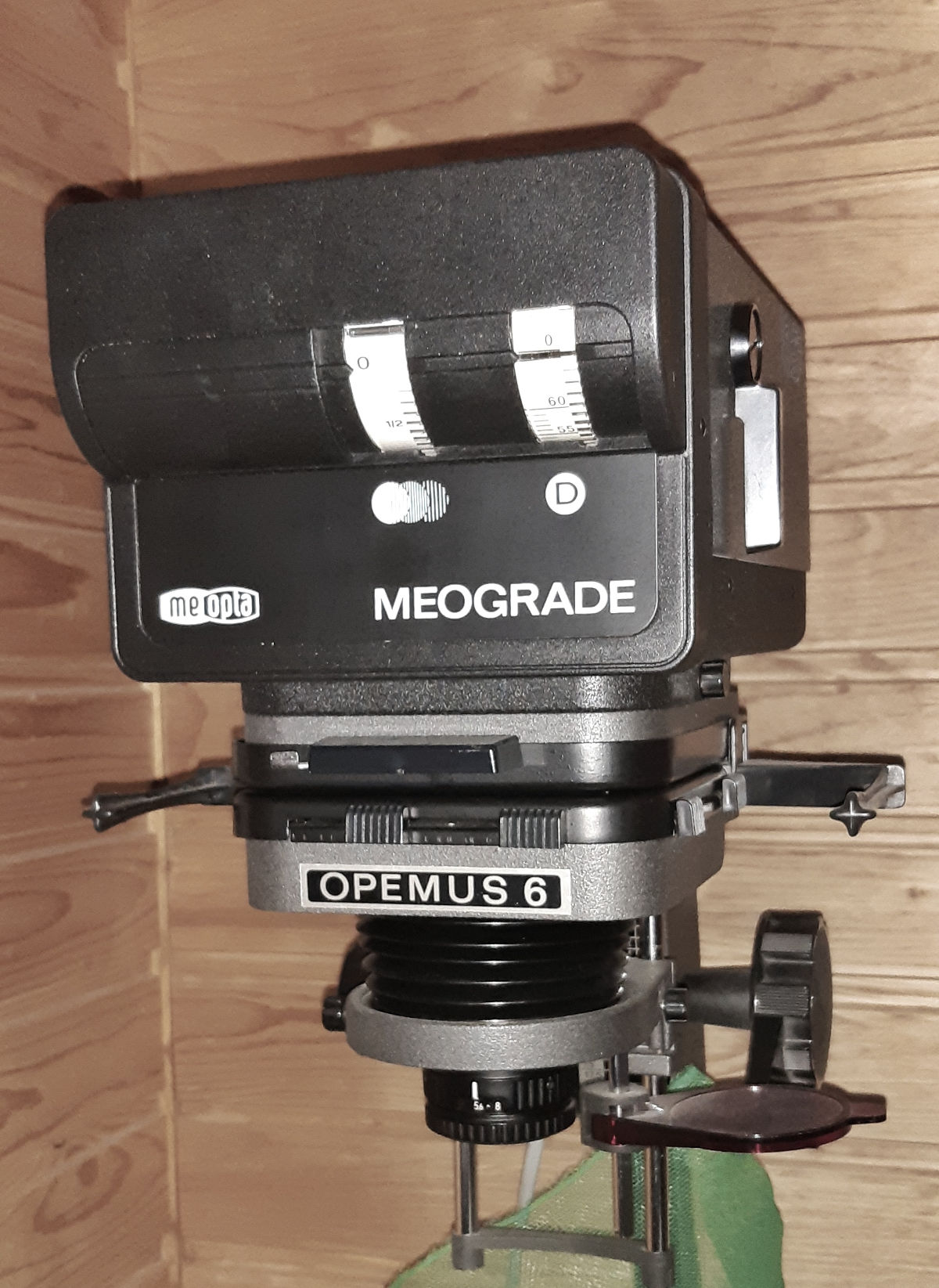

It may be of interest Meopta did offer a separate multigrade head besides colour head, namely Meograde. I did manage decades with multigrade filters in the box, though...
