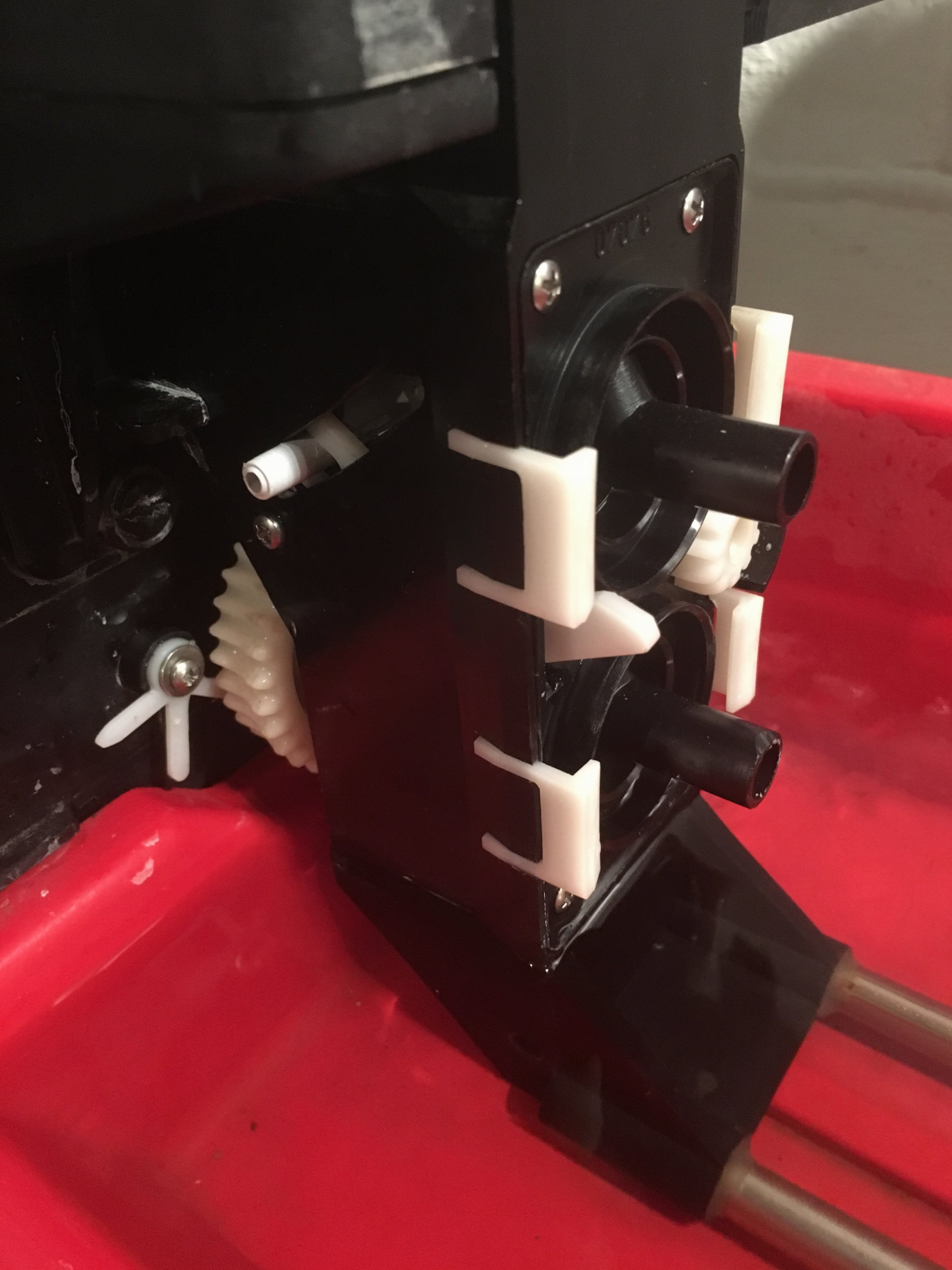

Hi guys, I always use two way and for some reason my Jobo is stuck on one way and I don't know how to fix it. Can anyone tell me how to switch it back?
Thanks!

As I recall there is a white plastic pronged lever near the base of the cog attachment. You slide that one way for back and forth movement and the opposite way for continuous movement. It has been a long time so I am not certain.

Here is a picture of my Jobo. When I pull the two white pins on the side (which I have to use a lot of pressure to move) it moves the white lever sticking out on the right of the picture (near the cog attachement) but that just changes whether I use the upper attachment or the lower (for different size drums), it doesn't change speed. I moved the triple prong piece on the left of the picture behind the lift, and nothing really happened either. Any help would be appreciated as I'm trying to develop some 8x10 film tonight as a test before a shoot with the same camera tomorrow. Thanks! IMG_0090.JPG

The switch is the 3-pronged white thing on the lower left of the photo.
These are the instructions from the Jobo CPP instruction manual:
Reversal Switch
This mechanism controls the automatic reversal of rotation during processing. It will reverse rotation direction every two revolutions. Turn the fingers away from the magnet coupling (or cog gear, if using JOBO Lift) to provide rotation in one direction only. (Almost all processes are best done with reversal of rotation.)

If you watch the beginning of this video you will see the little switch going back and forth. The switch in the video is in the proper orientation for bi-directional rotation. As I recall, you need to rotate this switch to its opposite orientation for single direction rotation.

Unfortunately I think somethings broken. The three prong switch still switches back and forth directions when I move it manually, but when I put it in the cog, it just pushes it to the side without changing directions (I have tried this in both directions and nothing changes.) Also the motor no longer seems to have an effect on the speed. It just goes one speed :SLOOOOOWWWW.
:sad: Time to send to CATLABS I guess?

If you are processing large format film in Jobo Expert drums and doing black and white only, then I suggest you get a Beseler or Unicolor roller base. Much easier in the end and quite controllable. Takes up minimal space as well and much less expensive.
I use http://www.darkroomdoctor.com/ Dave and Norma Smith. Great people for Jobo processors and parts. I highly recommend them.

FYI, I've recently contacted Dave Smith and he informed me that he has "retired" from JOBO repairs.
:sad: Hopefully he will still give repair advise and sell Jobo parts and tanks. He and his wife have been wonderful to me on Jobo question and parts as well as Omega enlarger parts.
