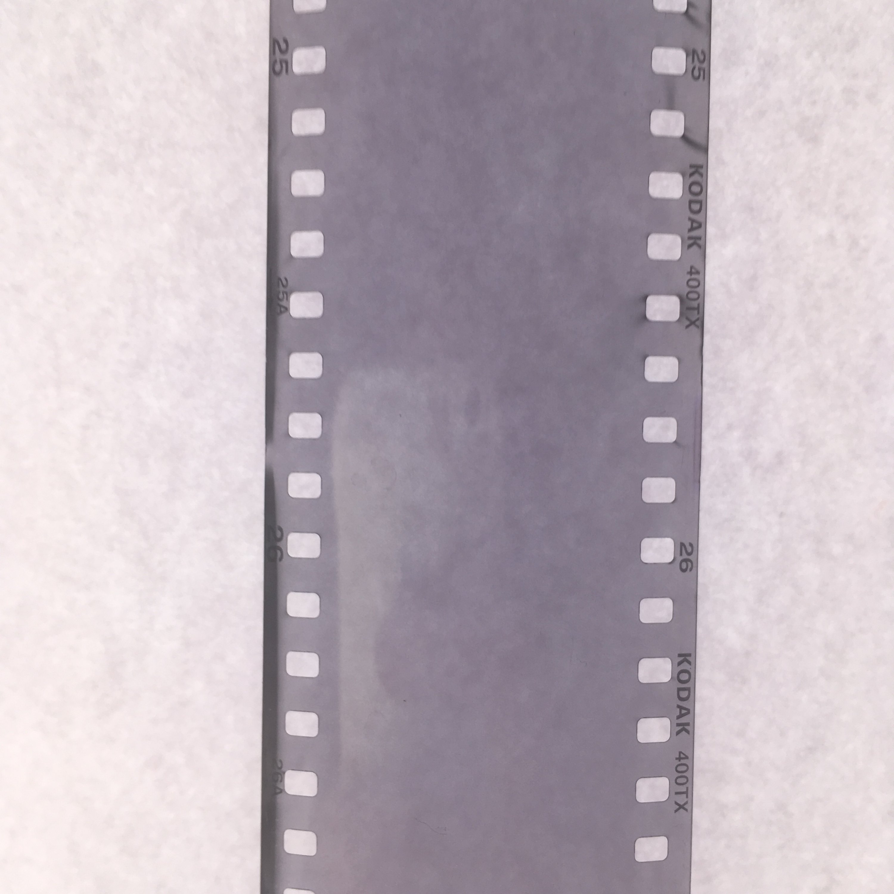

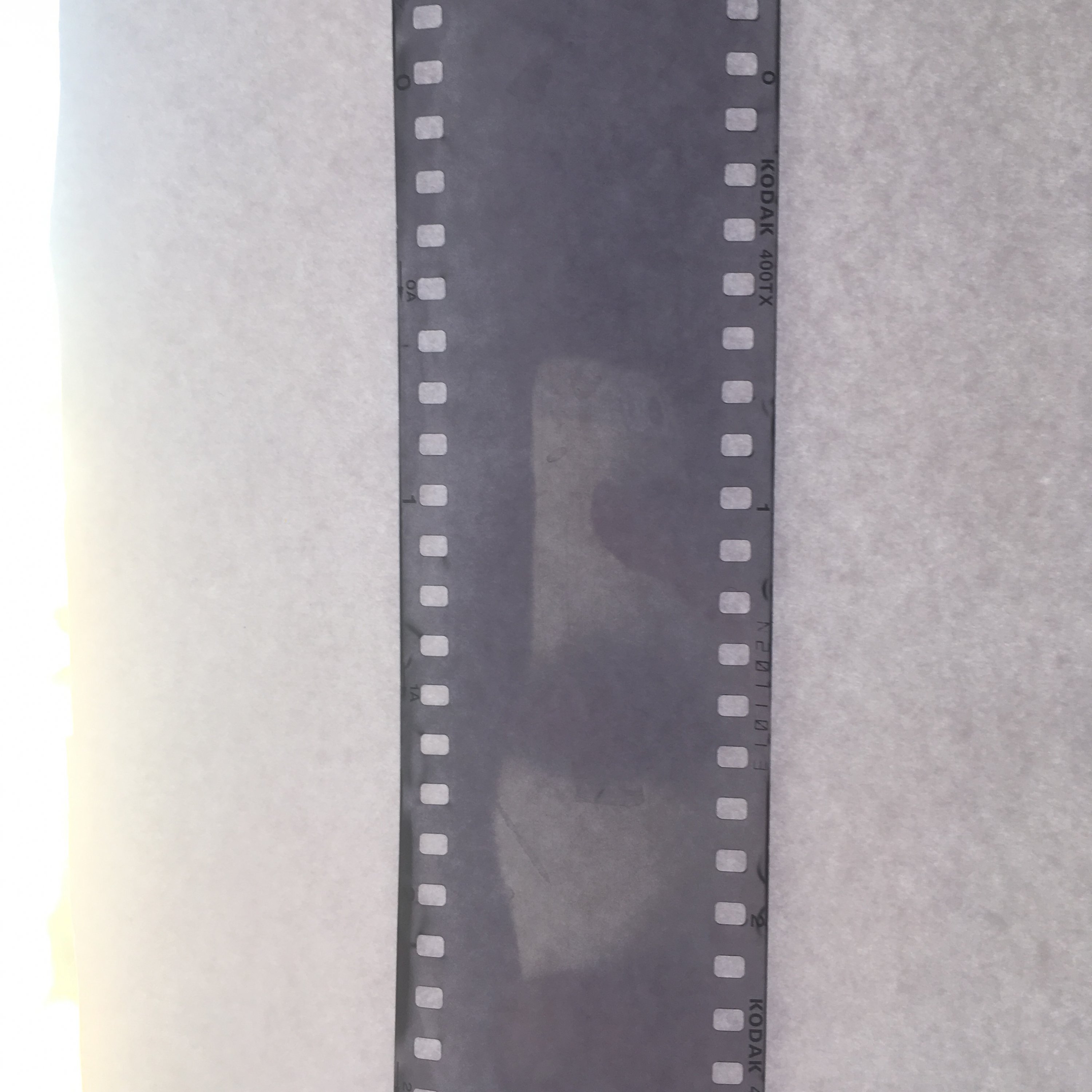

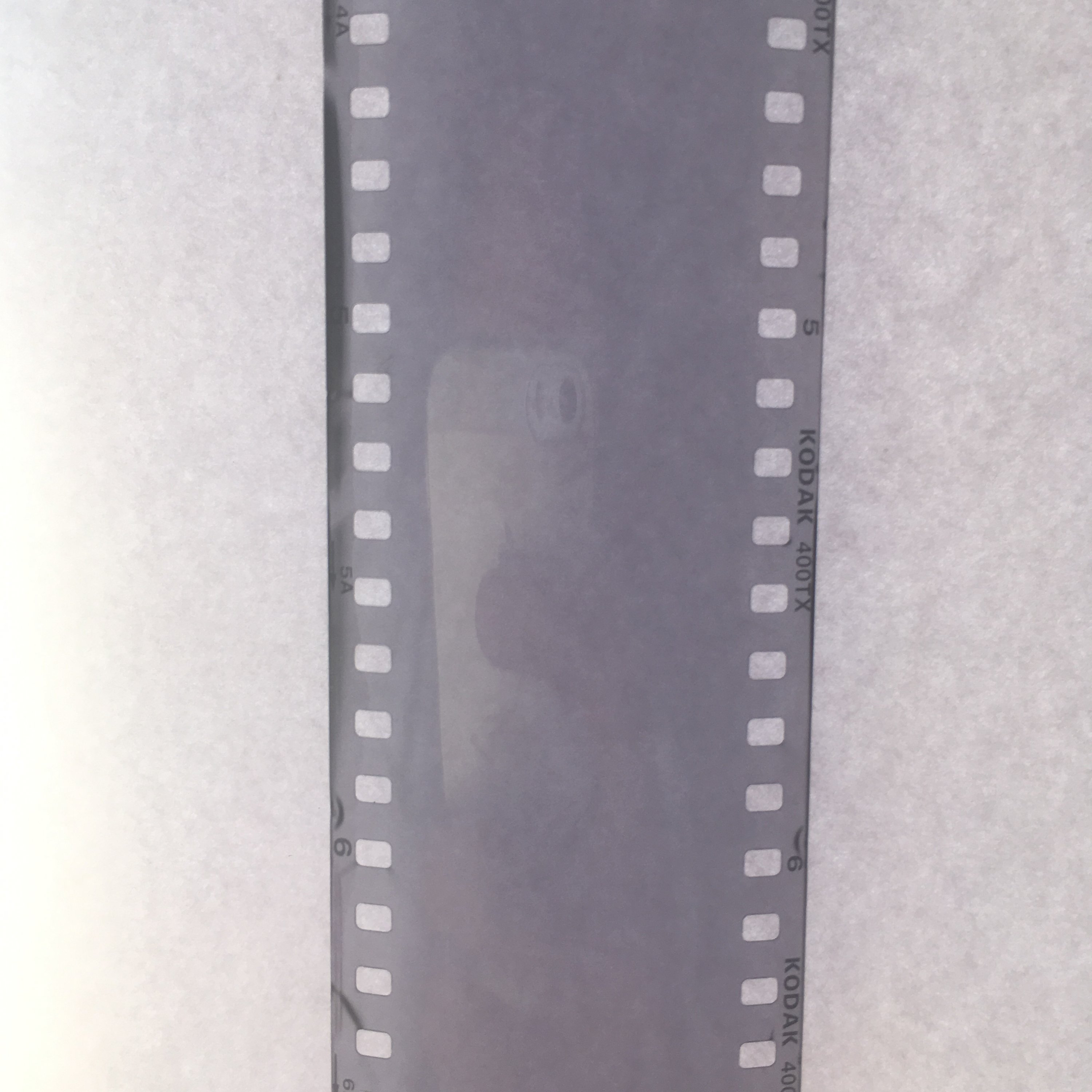

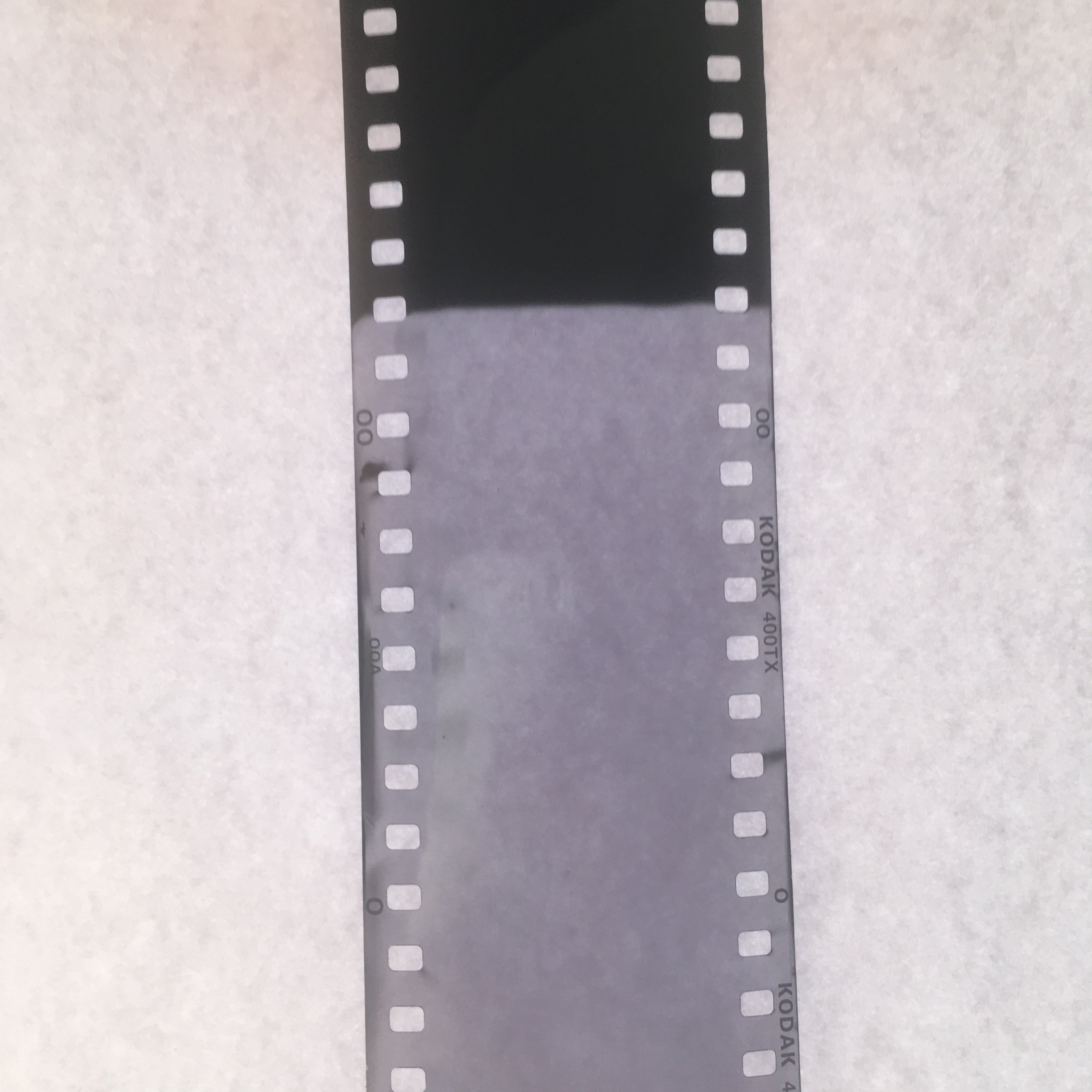

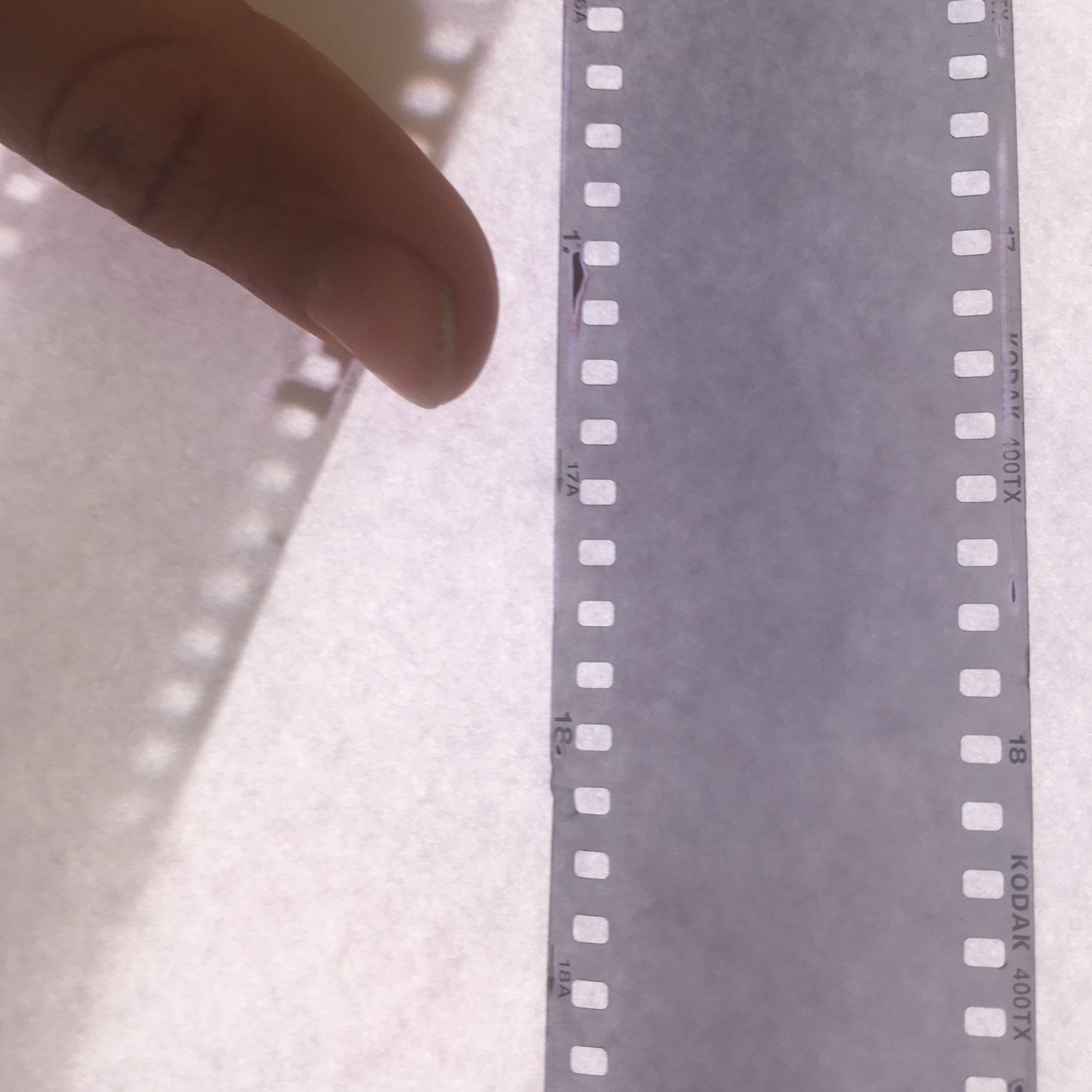

Here is the second roll that was ruined in the second bunch.

Were all these rolls taken with the same camera? Are these rolls the same, or a mixture of different films?
What model camera or cameras were you using?
I have a number of old cameras, and a few of then are very difficult to load. I have since learned how to detect whether or not the film advances, but that is due to improperly loading the film and shooting multiple blank rolls.
Based on your photos, the "blank" rolls were properly developed. This appears to be a camera loading issue or lens cap left in place. Most of us have done this at some time,

The 4th picture shows what you get when camera isn't loaded correctly. You see the black at the very beginning of the roll. This black is the film that was exposed from the film tab sticking out of the cassette. You can see the film numbers that are clearly developed on the film, this shows it not a developer problem. One final observation, you see frame numbers starting at 00, this shows that the film never wound out of the cassette, not sure what type of camera you are using. Best to wind a couple frames before you close the back of the camera.
All the other problems are from bad reel winding. You need to practice a lot on loading the steel reels. Make sure they are not bent. The easiest reels to load are made by Hewes in England, these are beautiful, but a bit expensive.

These rolls were taken with the same Nikon FM-2, using Kodak Tri-x 400 rolls. It's odd, but possible!

An excellent and correct analysis. The photo labelled, r2-1.jpg tells the whole story. Not even frame 00 was exposed - likely, the film never made it out of the canister. The black leader and edge markings tell us that the developer was not the fault.
