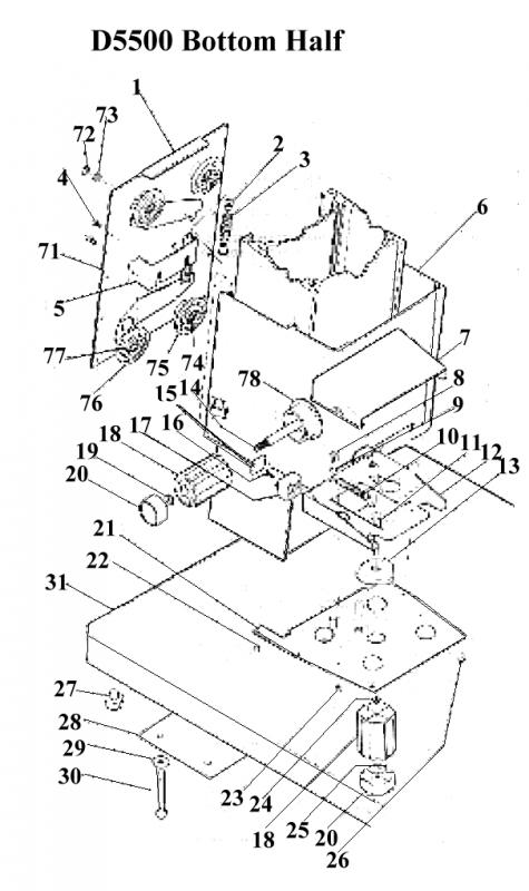

I have seen threads about how to replace the rubber rollers in an Omega D-5500, but I need help. First, I see in previous photos that the rod is threaded on the ends, but I can't see how the handles are attached. If I had a parts diagram it would definitely be a big help. Second, is there anything else I should know about? I'd really appreciate any help from anyone who has done this repair.

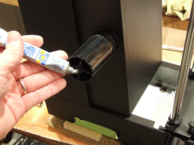

After the repair I put some anit-seize grease on the shaft so it comes apart easier in the future.

In terms of a parts diagram, this is the best on I have found:
Thanks to everyone for the help. To date I have ordered the replacement rollers from KLH (?) and am waiting for their delivery. So far, I have found that the end caps do indeed screw on. Mine were seized in place, the old different metals unite syndrome (brass and steel)! When I pulled the caps off, the press in fittings stayed on the shaft and were pretty much destroyed getting them off. I have ordered new ones, the minimum order being 25, so if anyone needs any, let me know. Otherwise they'll probably rot on my shelf. When they go back on, ic-racers comment about ant-seize is definitely warranted. I also ordered a gear puller like the one ic-racer has. I am a sucker for new and exciting cool toys! It is starting to make sense how everything goes, and as such the pics posted by ic-racer are making more sense. My next hurdle will be releasing the springs to remove the head from the post. I'm holding off hoping the replacement roller shaft will include more instructions. Any input on this will be appreciated. I admit that I am probably being overly cautious, but being retired on a fixed income, a new enlarger is not in the works, so I do not want to do something that cannot be repaired! Also, I have an Ilford 500 light source on it that I do like. Anyway, I will post more as things happen. Again, thanks to all who have taken time to reply with their helpful responses.

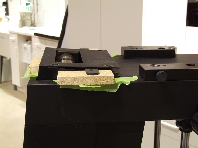

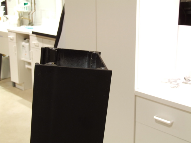

The springs stay attached to the head when the head is removed form the column. This is done by removing the top plate. I protect the top of the head from getting gouged by the top plate with some spacers as the springs are pretty strong.DSCF1753.jpg
