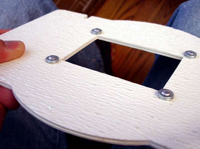

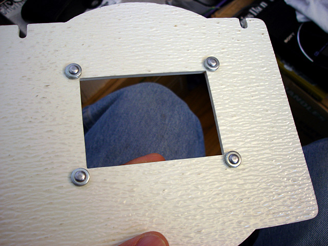

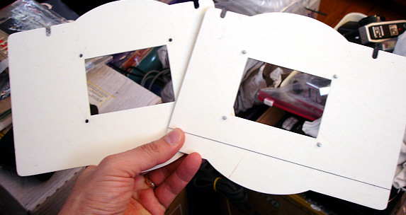

In the 1980s, when I was a college student, my brother was in construction and had a bunch of extra shower board material. I took two pieces, and – using an Omega 6x6 carrier as a template – made my own 6x9 carrier.
I think that I used a table saw to get cut the larger pieces and then a combination of hack saw, coping saw and drill press to get everything right.
I finished with some careful sanding and lots of measuring. A lot of sanding to removing rough edges, especially around the negative frame.
The locating pins are aluminum pins with two washers. I couldn't tell you what they are. They were in my dad's workshop. I filed down and sanded the tops of the pins so they wouldn't extend beyond the top of the mask.
It works very well. I'm not sure why I didn't paint one of them black. Maybe I'll do that soon.
