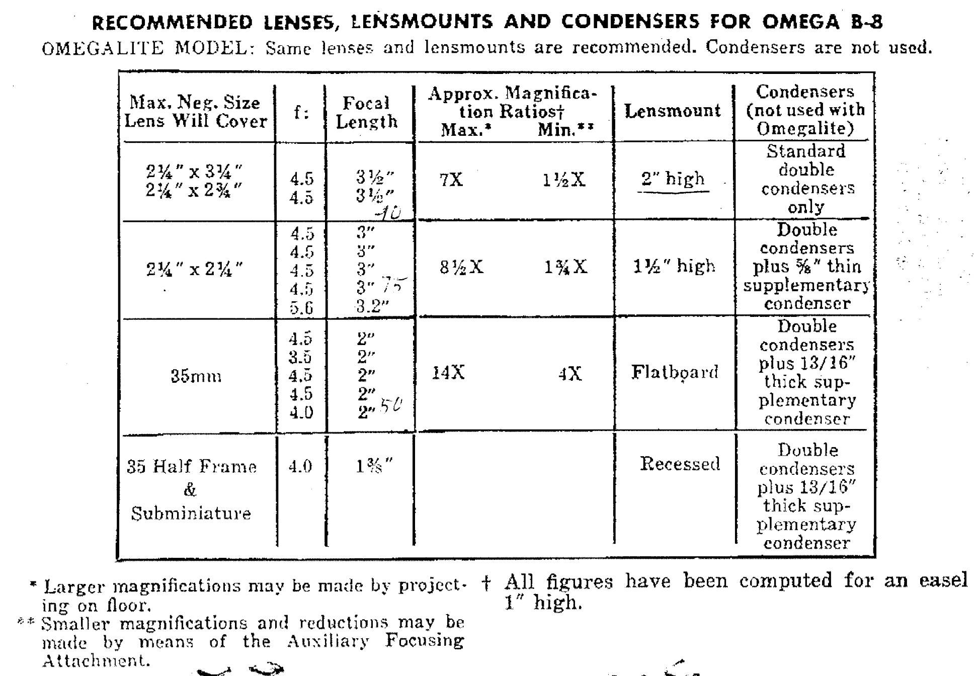

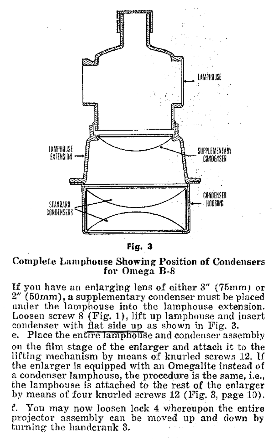

RE condensers:
Per this manual page:

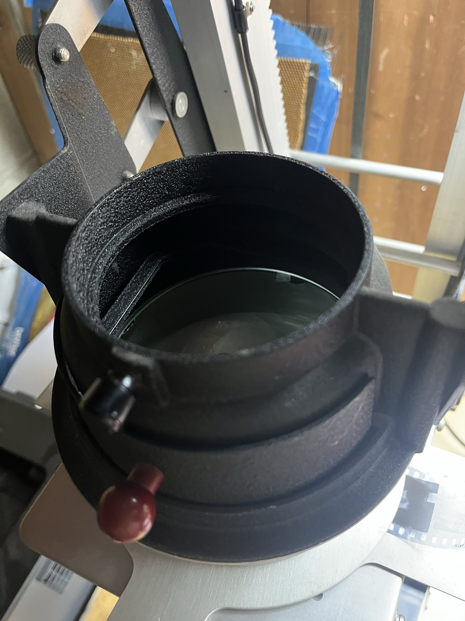

I believe I have only the standard condensers. Where it looks like a supplementary condenser should go (between the filter drawer and the lamphouse) - I got nuthin
As @MattKing says above, compatibility goes downward. So condensors that fit a longer lens and larger film format will also cover for a shorter lens and smaller format.
The manual suggests that using the enlarger without any supplementary condensers is appropriate for the largest negative sizes, so maybe it's fine and I'll just loose some brightness when printing smaller formats?

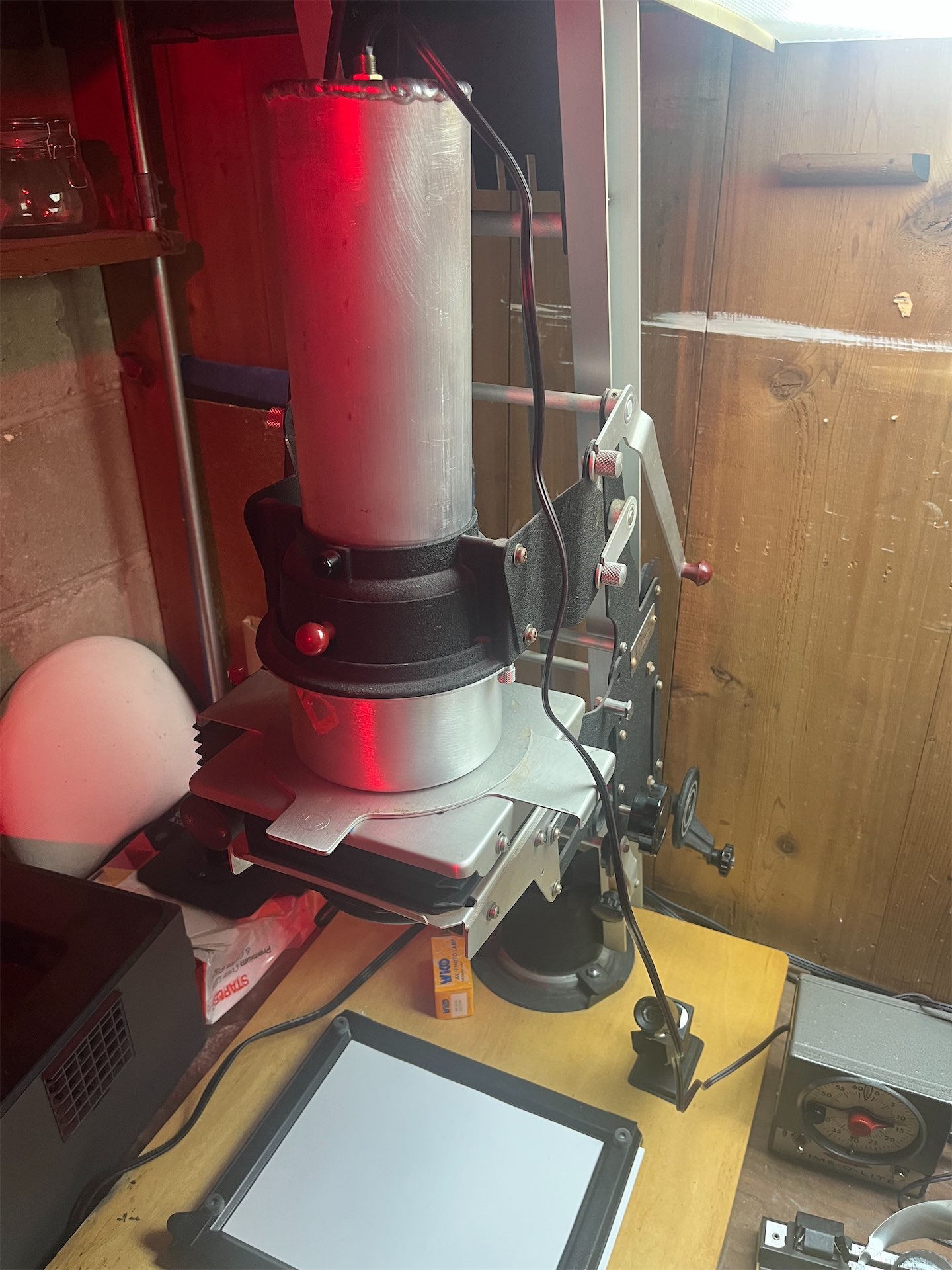

Update:
Still haven't built a VC head yet, but I did make a new lamphouse so I could put in an ultrabright LED bulb and swapped out the condenser for a diffuser. Still need to get around to making some prints but eyeballing it things seem decent, illumination is even and brightness is not awful.
Writeup on my website: https://hospadaruk.org/camera/omega_b8/2025/02/18/omega-b8-diffuser.html

Printing update: printed first pics on the new setup and times seem within the realm of sanity. A thin negative printed in about 12 sec and a well exposed neg printed in about 30 (actually 60 because I printed it with a #4 filter, but the uncompensated time was 30). These were 4x5 prints from a 35mm negative with an 80mm enlarging lens at f/5.6. Paper is arista RC pearl multigrade.
These are actually my first darkroom prints in about 20 years so I truly have no idea if these kind of times are particularly slow/fast?
Also seems worth noting, the bulb I'm using right now is a GE ultrabright soft white LED ~3000 lumen bulb (200w incandescent equiv). Contrast maybe seemed a little low unfiltered (only saw a couple test strips, also - haven't printed in 20 years so tbh no idea), but definitely things looked a lot better/pretty good with the #4. I think the negative was probably not super high contrast to start with - pretty sure it was from an overcast fall day.
Also Also - not really related to the enlarger, but just wanted to note that I'm using a red LED bulb as a safelight and that is working GREAT (not specifically marketed as a safelight - mine is branded "luxrite"). Saw some differing opinions online about whether or not that was going to work/be safe and I can confirm that it works great. MUCH brighter than the old red incandescent I had that it replaced.
