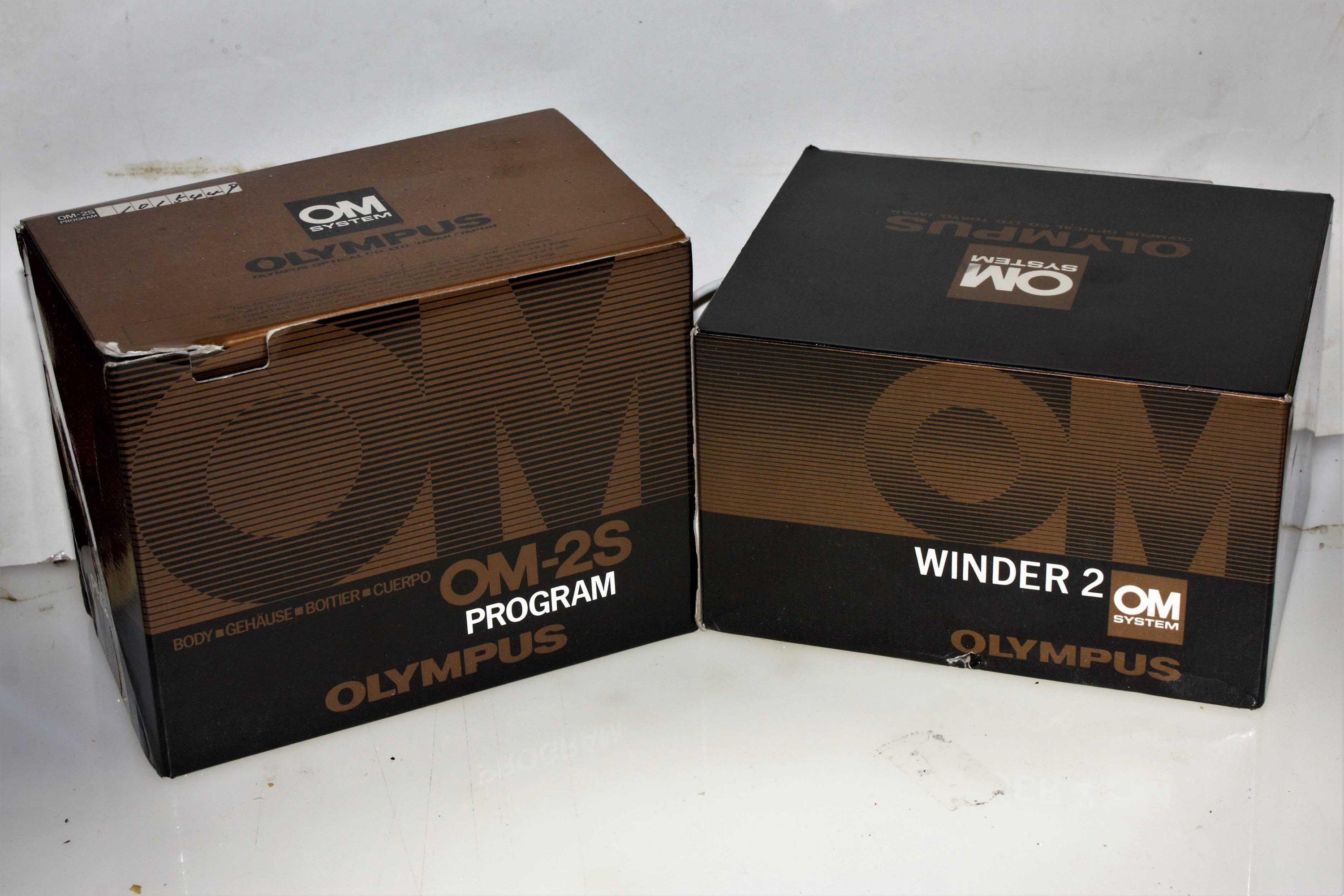

A "gift " to me from me Dec 2018. Batteries have been in for a full 13 mnths. Glad it was NOT one of those with the drain problem. Also have an OM 1 & OM 10
