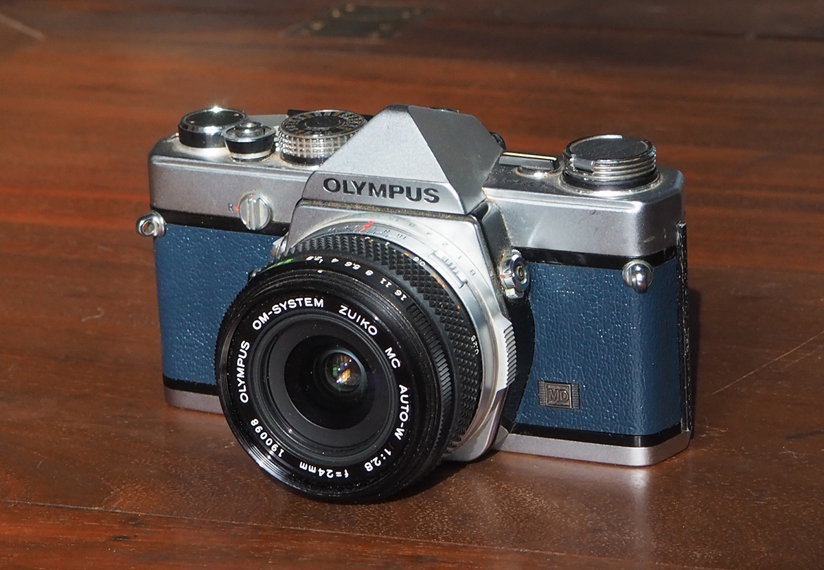

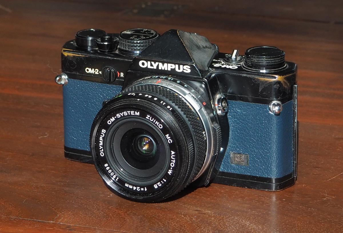

My Black OM-2n was my main film body, even after the canon/nikon AF bodies emerged. I had a OM-4, didn't like the viewfinder nearly as much as the 2n. I still have the same OM-2n and it works perfect as does a OM-1 I bought ages ago. The only thing I've done is replaced the door seals and replaced the leather with some dark blue colored leather. I like the way it looks, especially the black one. Clearly it's seen a lot of use, but is still a fantastic camera!
