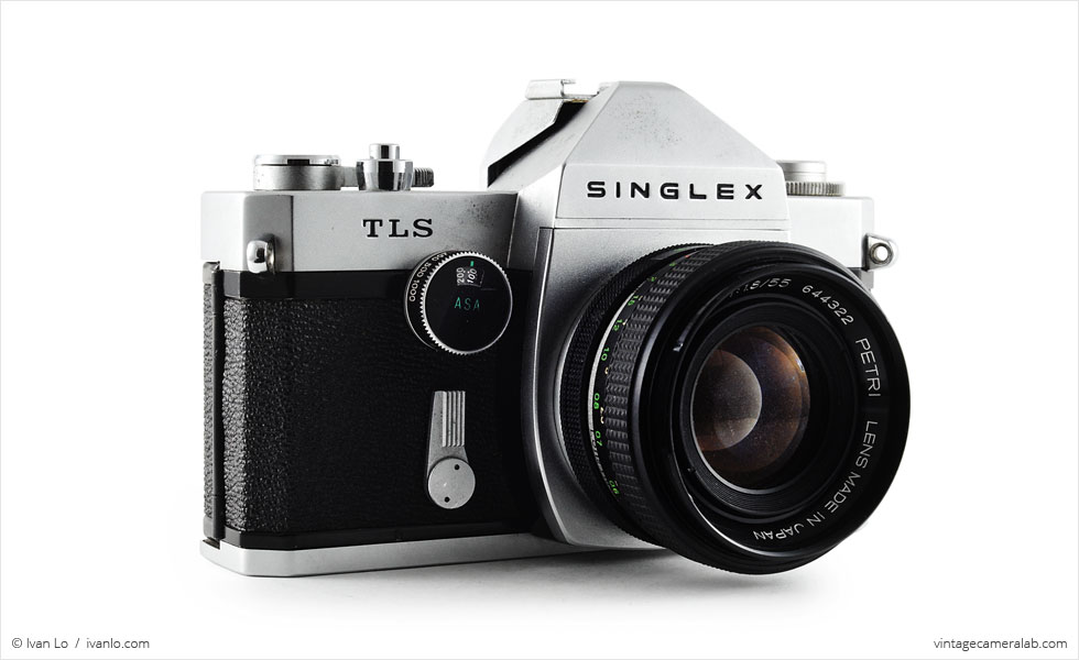

- On the Ricoh Singlex TL, the solution was to put the shutter speed dial on the front standard of the camera.
