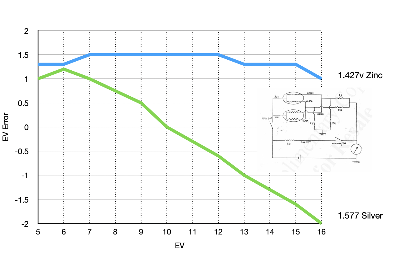

The OM-1 metering circuit is non-linear when the voltage is incorrect.
This will give you the results that a broken clock gives you, except as it will be right at only one light level, it will be half as right as the clock.

Is it really THAT nonlinear. Not being snarky, just genuinely curious what your testing has shown.
Many meter circuits are balanced bridge designs that mostly shouldn't care a lot about a little overvoltage. (Undervoltage can be an issue because it can run the diodes in the bridge into a kind of nonlinear part of their transfer curve.)
And all meters using a CdS cell are somewhat nonlinear across bright to dark because of the cell itself.
But we're talking about an 11% voltage difference. That notionally falls within the "for all practical purposes no big deal" category if you adjust accordingly.
I would note that I have not actually examined the OM-1 metering circuit and there are certainly ways to design such a thing as to be highly sensitive to minor voltage variations.
I would also note that I have personally recalibrated LunaPros for higher voltage and they worked pretty well thereafter in both the high- and low sensitivity ranges, but of course the LPs were never perfectly linear in the first place.
I also have an M5 that DAG recalibrated for new batteries and meter is pretty much bang on, at least so far as I have used it.

Findings from an OM-1 I repaired and the schematic for those that don't know what we are talking about.
Interesting. Since - other than the CdS cells, everything is a resistor (which are linear in behavior), the only explanation I can think of would be that the cells themselves are extremely voltage sensitive. Not something I've seen in other meters, but your graph tells the story.
Thanks for sharing this.

Findings from an OM-1 I repaired and the schematic for those that don't know what we are talking about. View attachment 380400
I don't have an OM-1 so I don't know but changing shutter speed, apeture and film speed what moves? The needle of the galvanometer moves or the + and - sign scale moves? If the gavanometer moves then there much be at least 1 variable resistor that moves by those settings. I don't see no such things in the diagram.
Decades ago, while mercuric oxide batteries were still available, I did a test with my OM-1n using mercury cell and alkaline cell. I discovered that the amount of error in the meter reading caused with the 1.5V alkaline in place of the 1.35V mercury cell was DIFFERENT at different LIGHT LEVELS. ...no single adjustment would work for a given battery Voltage (assuming the alkaline cell Voltage for the day was constant) when the light levels in which you were shooting was varying continuously. I bought an MR-9 in view of that observation.
