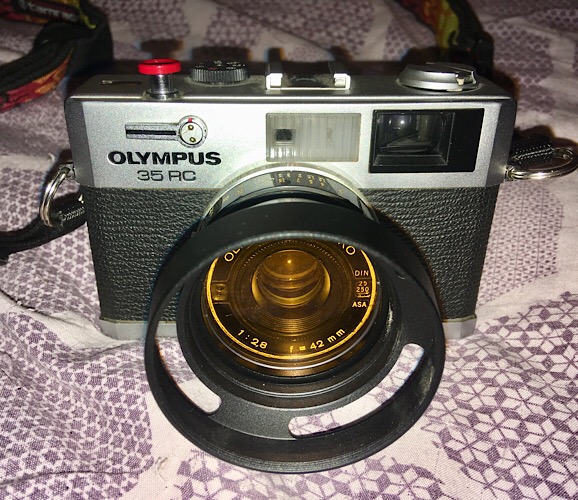

They are great little cameras but with one stupid flaw if you use filters or lens hoods. The filter size is 43.5mm, almost unobtainable.
So here is what I did. I looked on ebay for a 43.5mm to 43mm step-down ring, a few bucks from China. It fits fine and does not block the meter window. Now all my 43mm filters and lens accessories will fit my RC and 43mm is 10X easier to find than 43.5mm. Just FYI.
I also ordered a short metal lens hood for mine at the same time. Looks really neat, provides some protection for the lens and was also inexpensive.

My little Oly.
