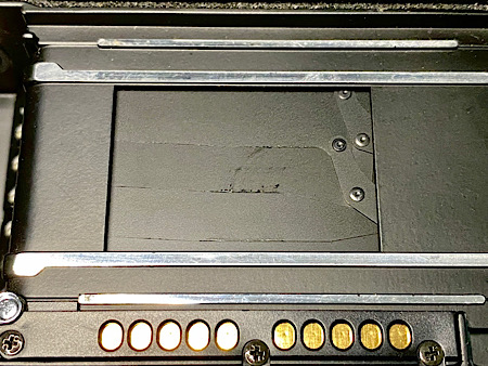

The shutter curtains of a Minolta 9000 can be temporarily freed from sticky residue. If you're lucky, this fix will last for a long time and only the shortest shutter speed will be affected.
But removing and cleaning the shutter is also a possible long-term solution, even if it's tricky and a lot of work.
If the shortest exposure time no longer works, you can switch to less sensitive film. Or simply overexpose negative film by one or two stops. This is not ideal, but it can be managed.

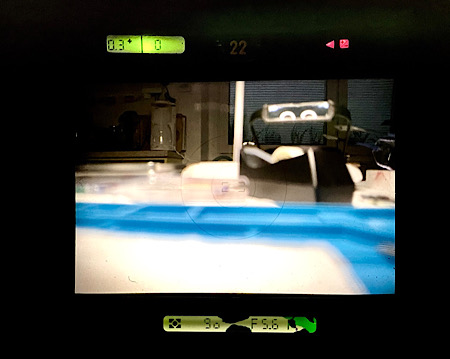

A damaged but still readable LCD in a DP-20 viewfinder for the Nikon F4.
An LCD with black spots may no longer show all the values, but the camera still works.

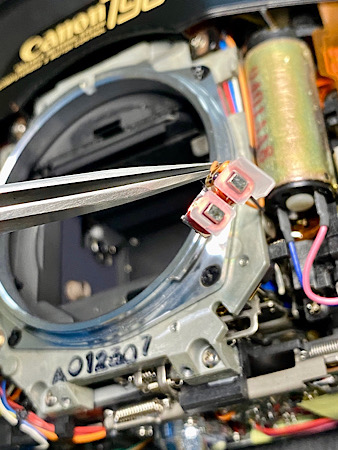

The mirror magnet of a Canon T90 can be removed and cleaned if necessary. Then the shutter works again.
