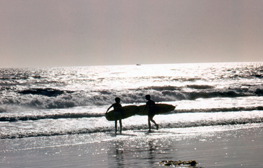

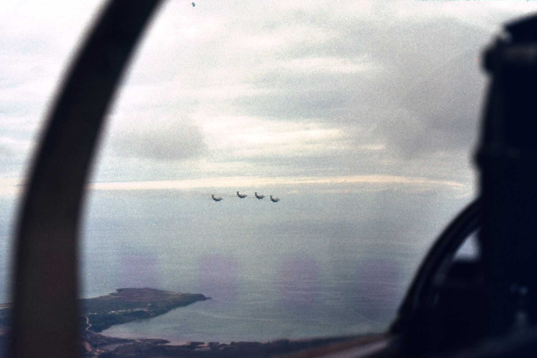

You may be interested in these then.
The both shots were taken in 1961 on Ektachrome film. The third example was corrected by the same means that I applied to the OP example. It is simply a color balance change and a slight increase in contrast.

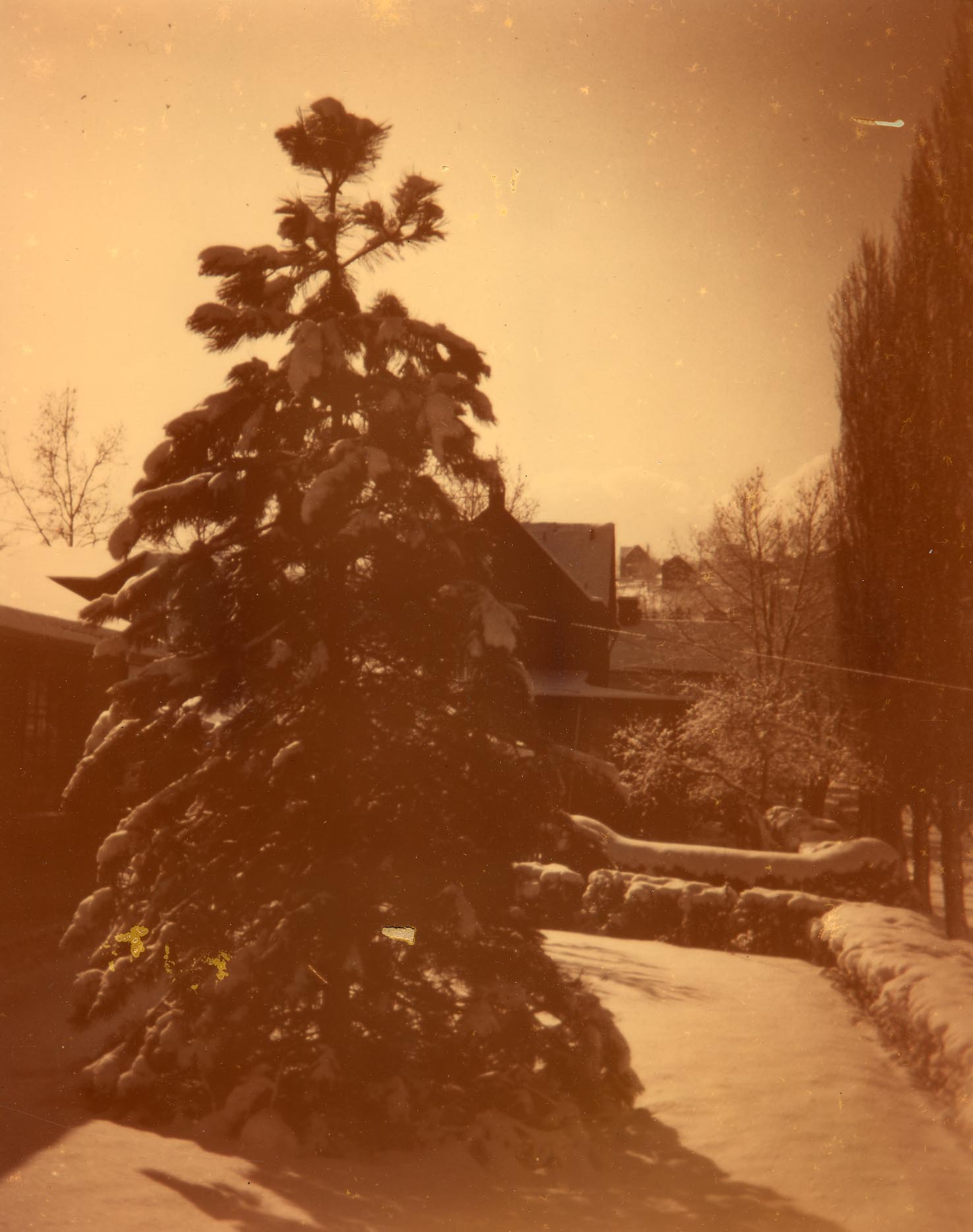

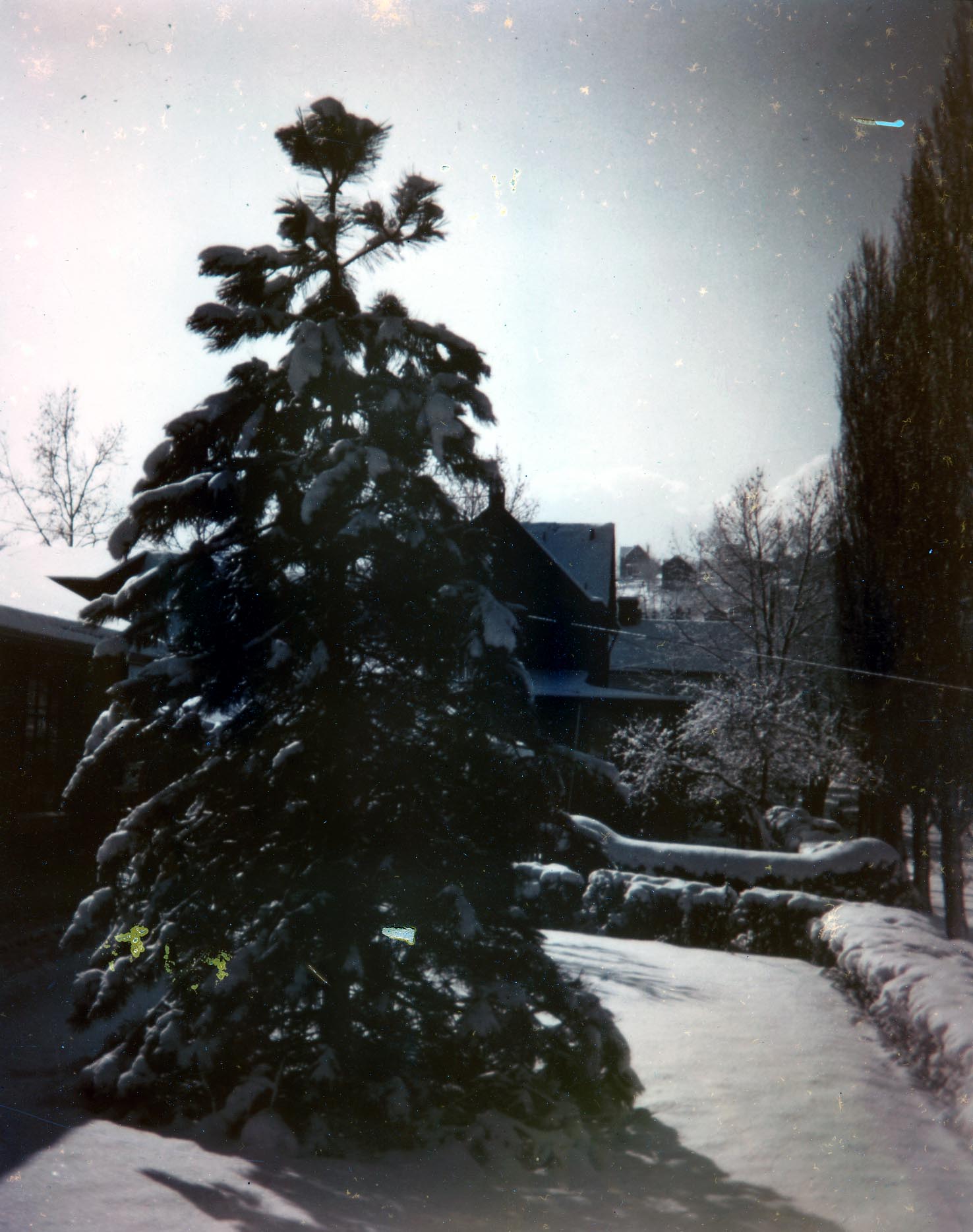

Ok, that said, the Pine picture is from an Anscochrome original from between 1950 and 1955 and printed on Printon at that same time. The color of the transparency was very muted with a brownish dmax, and the Printon print further reduced the saturation and contrast. Over 50 years of keeping did the rest. Treating it just as I did the OPs picture, I could do nothing more than remove the cast. It still looks like a B&W print. However, there is a clue to identifying this photo. In the upper right there is a scratch. It is very slightly off color to the eye and the scan shows just a hint of color. Enhancing the color enhances the color of the scratch which is the bottom layer, or the cyan layer. I have included both here for comparison.

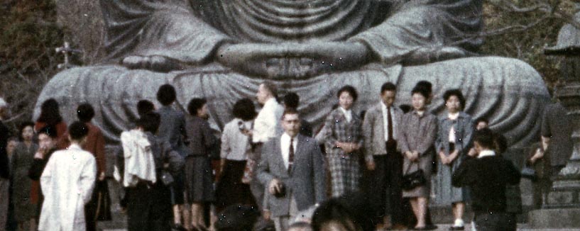

The Daibutsu photo was taken on unmasked Sakura film in 1959 and printed at that time on an unknown color paper. The print has faded so badly that only red and green are easily seen. Restoration in PS gives a reasonable color photo.

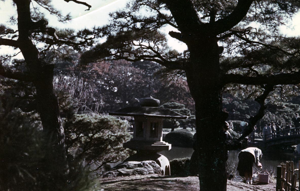

The park scene was at Shinjuku Koen, 1959 on Sakura film and was printed on Oriental color paper. The print was mostly red and green. Restoration does not do very much for this but does show some differentiation in color.
I was unable to add color to any B&W photo unless it was a solid color cast either by scanning or by manipulation after the scan. If some color was present, or if color differences existed, regardless of the original type (color or B&W) then the color came through and could be enhanced. This reinforced my original feelings, but cannot prove that the OP has a color photo. This method actually revealed the cyan color of the scratch in the pine photo in spite of it looking like a B&W print. The scanner was more sensitive than my eye to this very slight color change and enhancement revealed it totally.
The three other pictures that I posted, of the surfers and the two flying home photos show that color can resemble B&W and that restoration of a badly faded photo does work to some extent.
