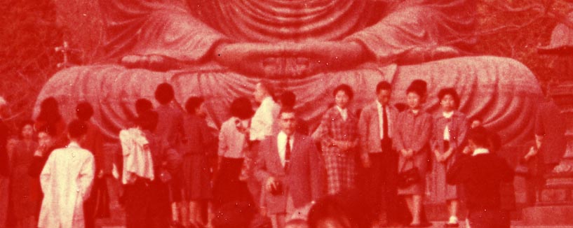

As the OP "Willie Jan" has told us the original doesn't have the blue in the sky or highlights there's nothing whatsoever to indicate the original was colour.
It is all reddish. Your are right that it looks blue in the highlights here. Looks like some change has been made after upload.... The original is white in the highlights.
Sometimes JPEG compression caused colour artifacts.

Your interpretation is way too optimistic.
What you have managed to do in PS is to colourize the image. Differences in colour in the result are a result of contrast and differences in densities of the colour in the original, and do not differentiate between parts in the original - would it have been an original colour photo - that would/show show different colours.
The right colours aren't in the right places either: both the original and your version show (the same) colours in (the same) places were they make no sense at all.
I have tried to analyze the original, compare the "restored" version to the original, and still see no proof at all that it would have been a colour print, and not a colourized monochrome print.

Well, firstoff, Ian is avoiding one major issue. I would like to see some of his "colored" B&W. He claims to have some and I think it fair that he post one.
Now, on to the critiques. I agree with them all as being possible, except for the fact that there are several problems. The colorization, if it took place, is too well confined to the right places. Blue in the sky, autumnal colors in leaves and red in the shirt are clues especially when next to the red shirt is a white shirt.
When I try to colorize a B&W print using PS, it is quite dismal and the colors are quite random. And, in addition, I have seen faded color prints that resemble the one in the OP. Having looked at literally thousands of color prints that were faded almost to that point, I was struck by the resemblance among them all.
Now, back in the 30s there were many tri-color cameras in use and a variety of color processes being used to make prints. All of these methods were rather inferior to anything that we routinely see today, and in fact some of them closely resemble the original post after years of keeping.
I cannot say that this is a "fact" due to scanning artifacts and the condition of the original. All I can say is that I am pretty well sure that this is probably not a simple toned print nor any other simple process. But then, the defects all combined may be fooling me. I'll wait to see what Grant supplies. I suggest that some others give it a try too!

Err, I'm not avoiding any issues at all, my Grandparents wedding photo (group shot) is in the UK, as are the reddish coloured images I have on warm toned papers. I'm not going to try and recreate them (cheat) from a few thousand miles away in Photoshop :D Besides whichALL the 1920's - 50's & 60's Manuals/Data guides from Agfa, Gevaert, Ilford, Kodak etc describe how to obtain just these colours using certain developer/paper combinations.
I don't disagree that the JPEG image here may show some traces of colour but as Willie Jan told us all that his original print has white highlights not blue and that the JPEG he posted doesn't match the original then trying to read anything from that JPEG is just not valid.

If reading from this is not valid, then why even try to guess?
My point was that the coincidences were too great for me to just accept the simple solution. We will never know for sure without a microscopic analysis of the print.
Ian, I have manuals from the 40s, 50s, and 60s. I also have the Kodak books on Creative Darkroom Techniques. I'm aware of what can be done. I just wish to point out that this print resembles old color photos that I have seen in Kodak archives and a number of prints that I have produced after severe fading.

I have looked at the pic posted and your correction, PE, but really do not see your coincidences.
If you tweak, push, shuff or pull colour enough to, say, make the trees look a bit greenish, the entire picture will look greenish. Same with other colours.
If you examine the colour chanhhels, there is no significant difference anywhere in the image. In short: it's all very much the same colour. Everywhere.
So i really do think you are a bit too optimistic. I can't see it being anything but a tinted monochrome image (with a blueish cast in the highlights due to we don't know).

You may very well be right, or you may just be expressing an opinion as I have. My opinion only carries the weight of having viewed so many faded color photos from so many manufacturers but still no surety.
Please take a look again though. A scanner somehow "changed" the sky to blue in the OP. But it left the boy's shirt white. The man's shirt is red. This is meaningful to me. So, maybe it is optimism or maybe you are pessimistic, but the only fact that remains is that we do not know anything for sure.
Kodachrome existed in 1937 (having been introduced in 1935) as did Agfacolor neu. This might have been a print from one of them.

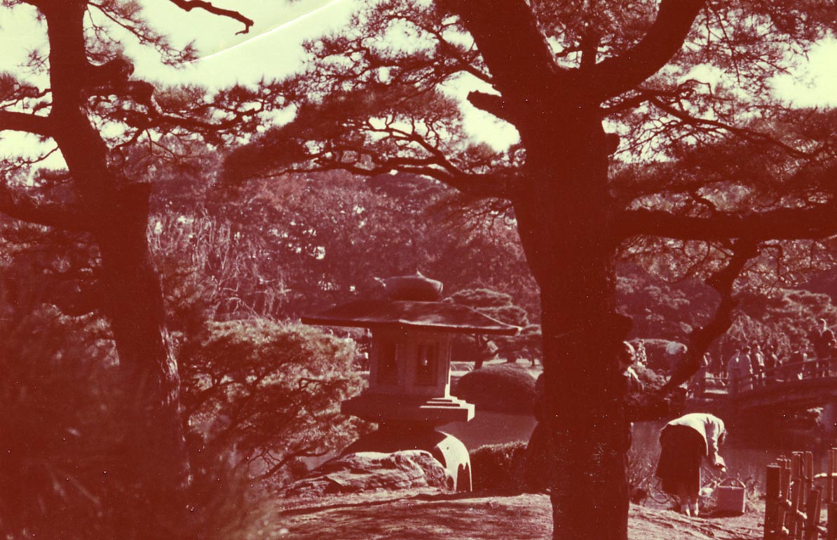

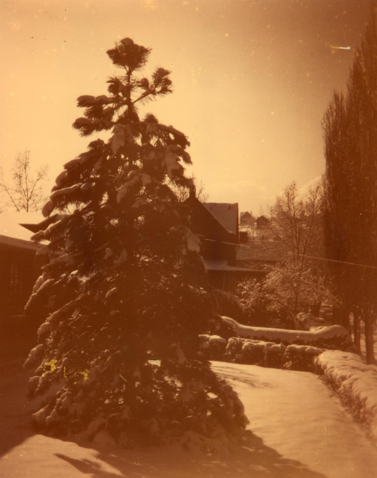

Comparisons
Guys;
I have prepared 3 comparisons of prints that are about 50 years old that you might want to judge. These are just scanned, no changes.
I have also consulted with a world expert and member of the ANSI committee on image stability on the OP. He has rendered an opinion.
Ok, here are 3 unaltered scans. Which are B&W and which are color?
I will post my experts opinon (anonymously) and the information after your comments.
PE

AgX
Apr 5, 2007
29,973
Germany
I made up my mind: #2 and #3 were originally true colour images.
railwayman3
Apr 5, 2008
2,816
I'm sure that No. 1 is B&W (maybe some kind of sepia toning) and that No 2 was definitely color. I'm unsure about No 3, but there are hints of color in the sky and unevenness in the tones of some area which might indicate a faded color print?

I am in no way an expert, but I like playing games, so what the heck. To my eyes all three of those could be (or could have been in the past, at any rate) color photos. If I was told that at least one of them was definitely monochrome, I guess I would have to pick number one as the b/w one, though I am really behind my initial guess.
