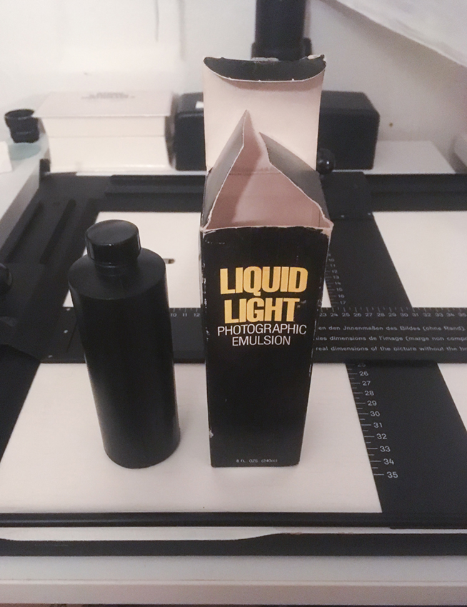

Hi, I just bought some darkroom equipment and got a bottle of Liquid Light photographic emulsion with the purchase. It has a date from 1994 on it. Is it worth a try or do I waste my time? Thanks.
I ve used some that old .. you might problems.
when i did, i had to precoat paper with gelatin because the gelatin was messed up ...
i've also used some that old and it was fine ... ( contrast boost )
I would not use it for anything important until you test it.
It could be ok (sort of ) and useless...
Thank you. I've just read another thread on the emulsion and it is perhaps just junk. I'll try it for fun some day.
