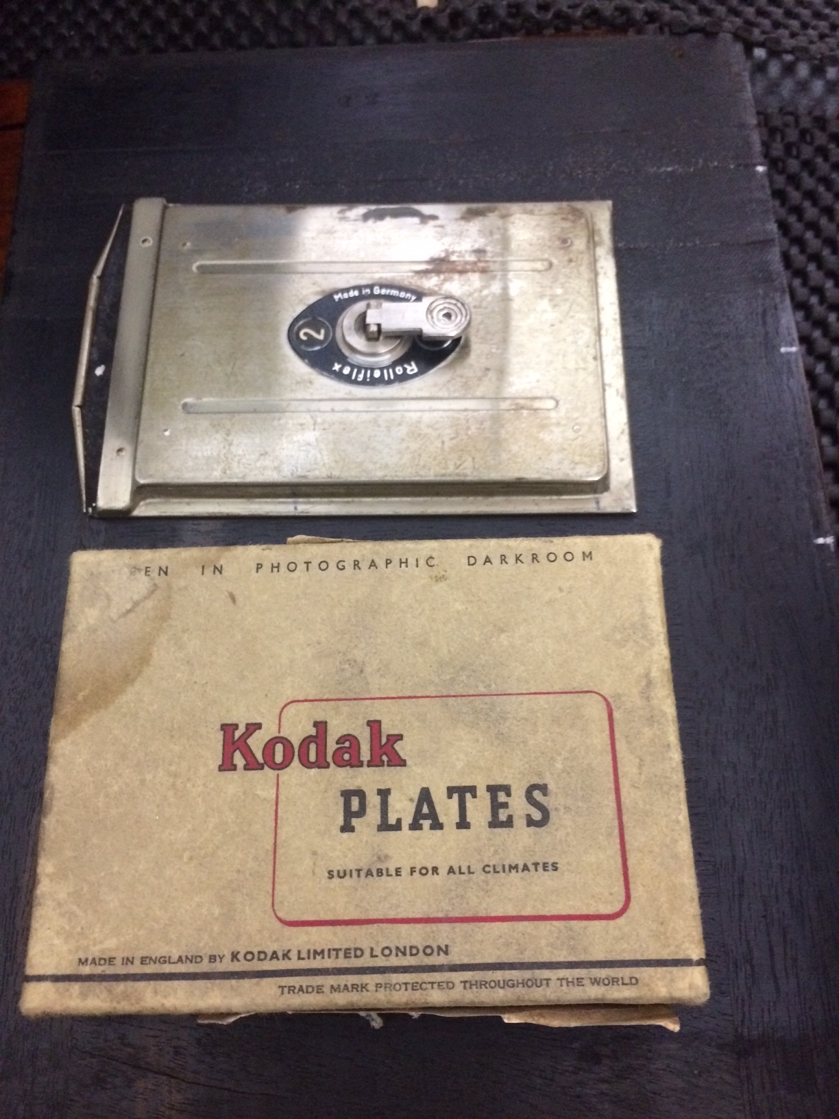

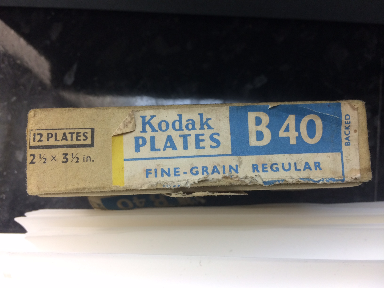

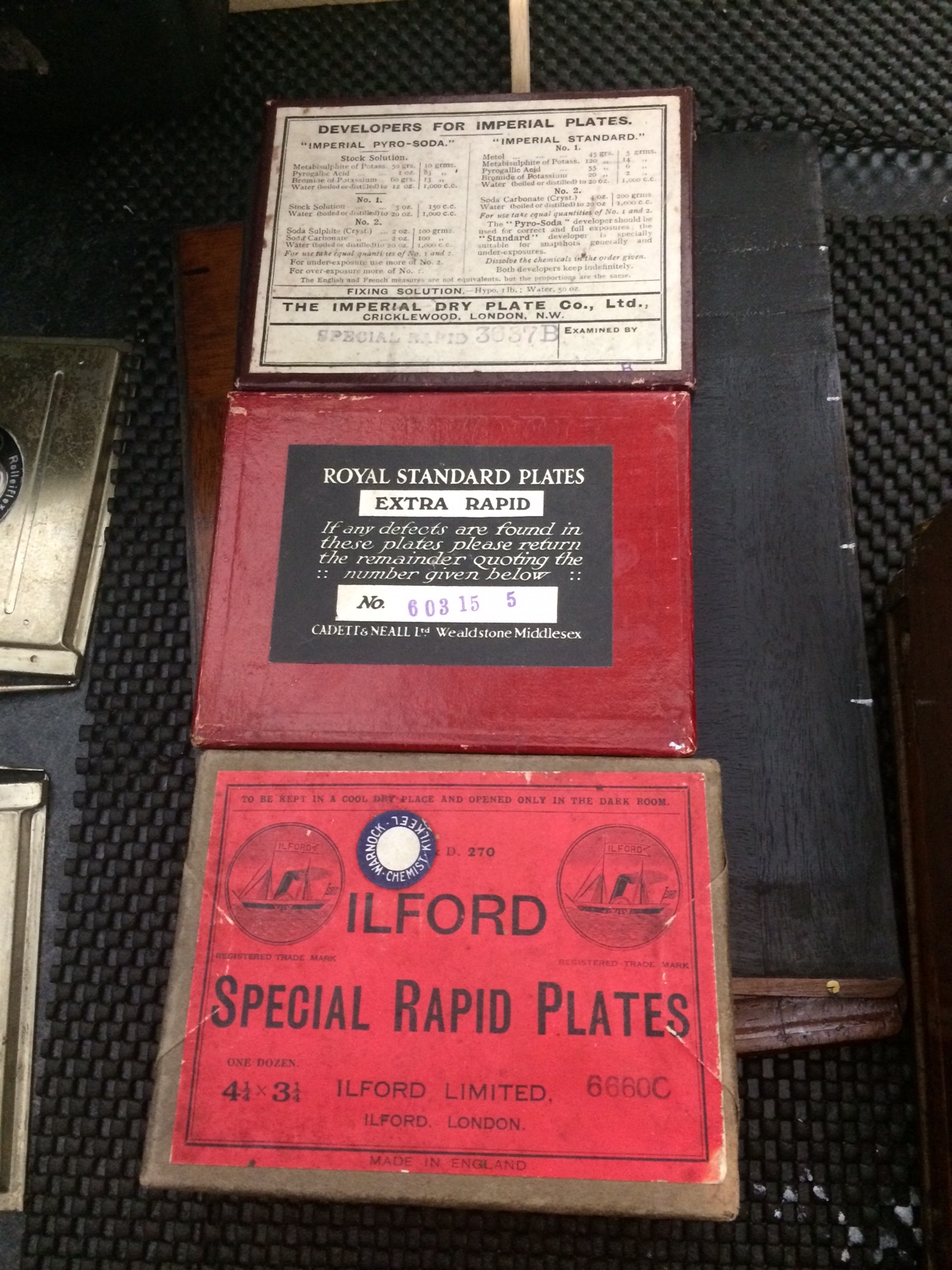

I am looking to do a session using the following plates (see attatched) I got from auction and thought I'd ask for any advice in using them in both the studio and outside.
Any advice in what best chemistry for developing, times of exposure and developments would be really useful as I'm a bit of a novice.
Also do you think i could use the kodak B40 plates in the rolleiflex holder?
Thanks

View attachment 185848 View attachment 185849 View attachment 185850
Hi,
yes they should fit in the Rolleiflex plate holders, those were made for 6.5 cm x 9 cm what is practically the same as 2.5" x 3.5".
I've used many (over 120 yet) pre 1945 plates for a microscope project (https://www.flickr.com/photos/136145166@N02/albums/72157686135321996. I was surprised how well they worked. :smile:
When I get unknown plates, my starting point is exposing a single plate at ISO 0 and developing 4 minutes (for fine grained plates) to 7 minutes (for ultra rapid plates or somesuch) in Rodinal 1:50 at 18°C in a tray.
Note that even plates of that age are sometimes panchromatic and have to be developed in the dark (not in red savelight).
Have fun
Jens

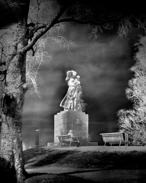

Love this work of yours it has as you say a lot of potential, manipulation should not be out of the question in my opinion.
I have taken the liberty of looking at the solarised image and fiddling with it out of curiosity...Manip_Crop.png

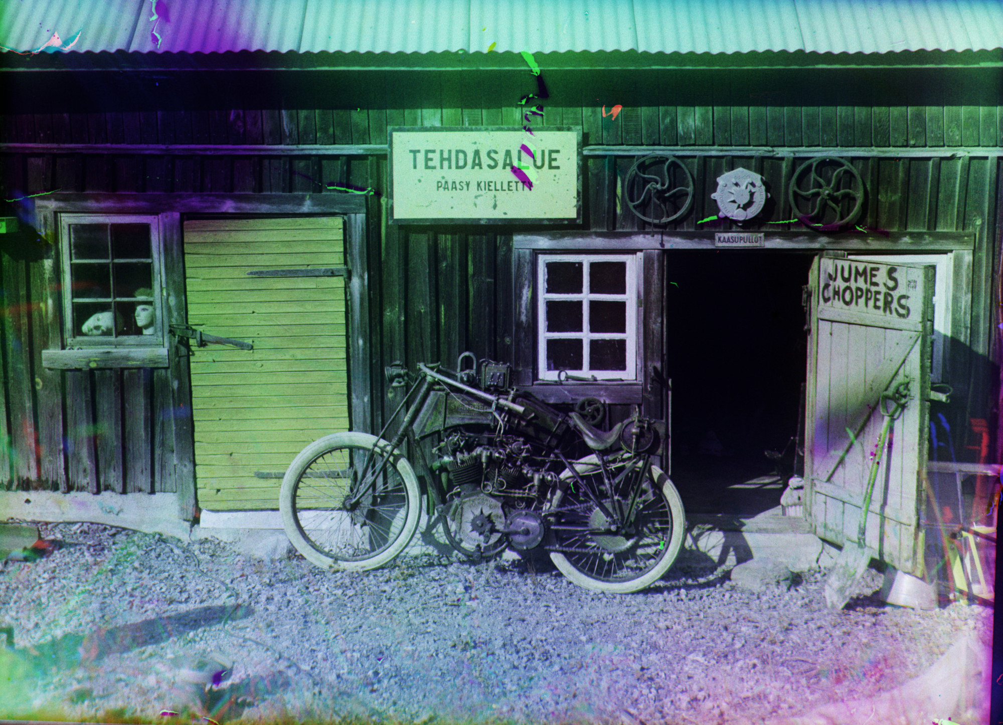

Yesterday I developed three glass plates which I used last summer. First is one of those quite old Mimosa plates, and the other little newer Agfa Ortho plate.
Interestingly the Mimosa plate worked much better than the ones before! There's not much fogging. Plates are packed on two different paper wrappings inside cardboard box, and now I have used seven of them. This plate is from second paper wrapping. I think that box has been opened and the paper wrapping on the top taken out from time to time, but plates below haven't had so much light over the years. I overexposed the plate as I did before, but this time it wouldn't have been necessary.
Only five Mimosa plates left. I want more!
