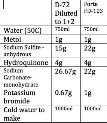

Ben, please do not worry much about Bromofort, but try to use it sooner than later.
There is comparison between D-72 (diluted 1+2) and Forte FD103
After all, not much difference. Will be nice to see prints developed in each of them side by side.
I'm sure some of our Great APUG Chemical gurus will tell us how big actual difference it is.
D-72 has 4.67g more of Sodium Carbonate
FD-103 has 7g more of Sodium Sulfite and 0.33g of Potassium bromide

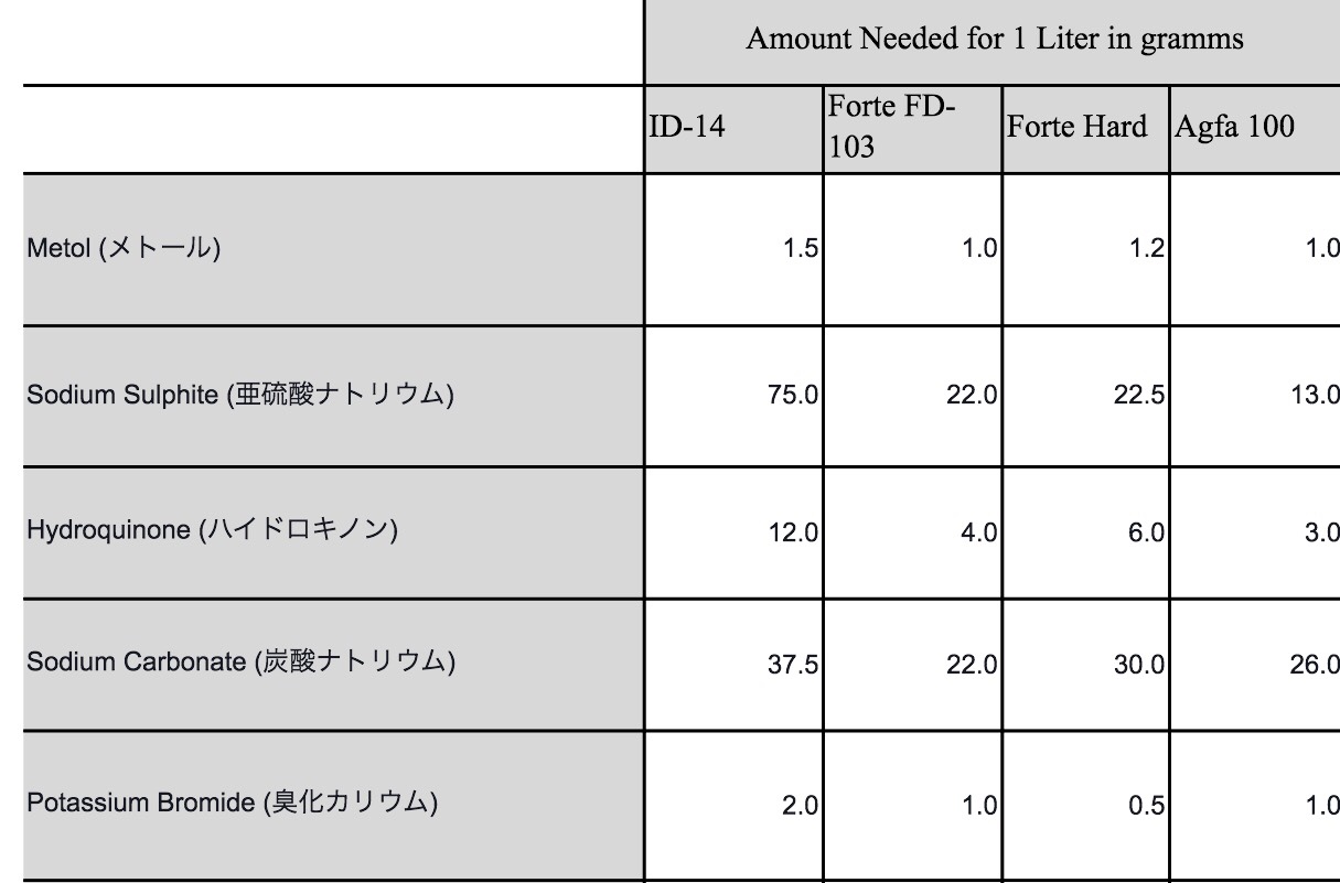

Hello,
D-72 is something I haven't tried yet but I did write up a few things and did some tests. I'll post my results later - basically I came to the conclusion that I see nothing much different that would make me use one developer over another. I just therefore stick to FD-103 and even some local Japanese liquid based when I am lazy :smile:. It's called Chugai.
See below my recipes.
Ben
Edit: forgot to mention that I did these tests in search for a hard developer as most of my paper are BSP (special) and that is pretty much grade 2 on a Variable contrast scale and I prefer grade 3 usually. What worked at the end was to develop my negatives to high contrast.

D-72 formula should be as close as possible to commercially available Kodak Dektol.
Well, that is very tough decision to give more developing time just to use existing paper, it can bit you back in few years down the road. Film Scanning definitively likes "softer" negatives. Ducking, before AntiDigital police finds me here.
Also your enlarger light source plays significant role in it.

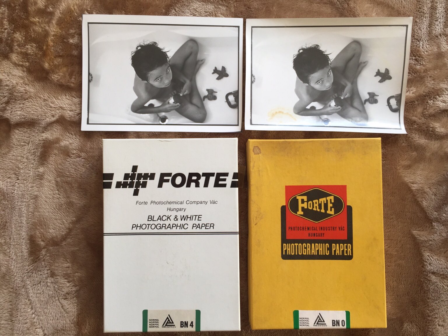

Back to the original topic - I have developed the same frame on the old And new(er) BN paper to see the difference.
Here the difference is not striking as it depends on the light that falls on the paper but wanted to picture them with the boxes.
You can see the yellow stain on the paper that came from the stuck bloc of sheets.
Here you can see the white of the papers. The left one is the modern paper and the right is the old one. Slightly yellowed.
Ben

Ben, back in the day I felt that switching from my then everyday positive developer ORWO N120 to Forte FD103 was right thing to do. It produced distinctly different results, it was way softer. In the last maybe 10 years I mainly use Ilford Bromophen, the same stuff as Kodak Dektol.
Beautiful thing in photography is that you are only responsible for your self (of course if you are not paid to produce pictures and you are working just for your own fun). If you are happy with your negatives, prints and scans, simply go for it. With testing you will find your own path. You are only one in charge. Settling just on one positive developer is great, one less variable in your chain.
Have great light!
PS top paper shows signs of fogging, looks more grey to me than yellow
