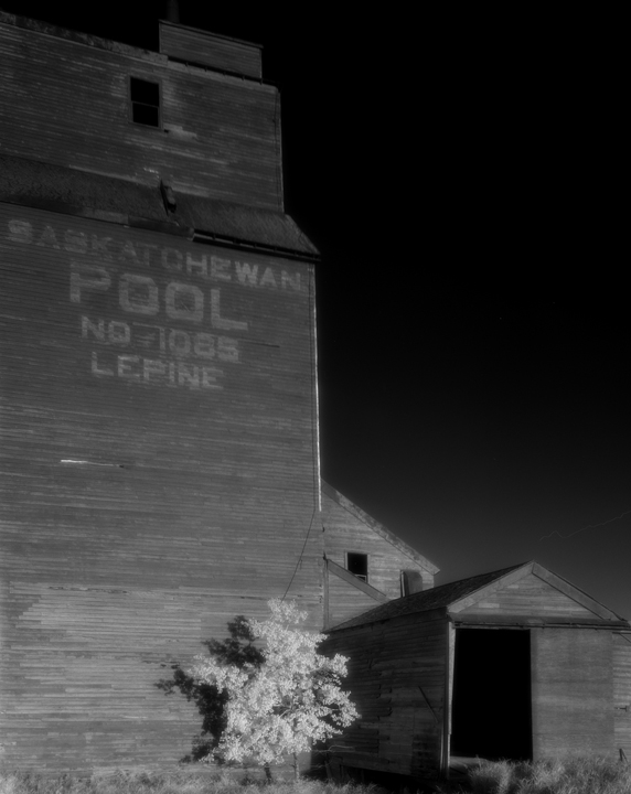

Vine Forest
Gelatin-silver photograph on Freestyle Private Reserve VC FB photographic paper exposed in contact with an 8x10 Efke IR820 infrared negative
from a Tachihara 810HD triple extension field view camera fitted with a Schneider Super Angulon 121mm f8 lens and a IR680 filter.
The film was about 20 years old and an actual film speed test showed the the infrared speed was E.I. = 0.15 ! That's slooow.
Final camera exposure was 20 minutes at f22.

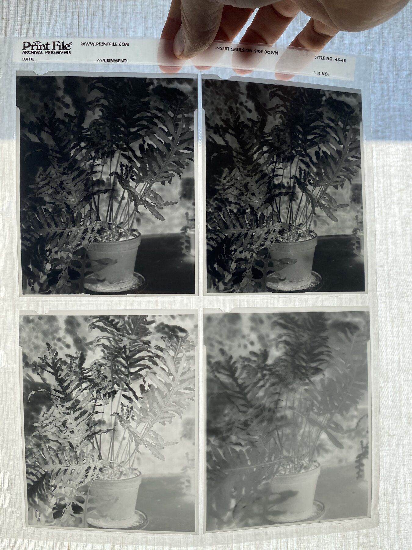

Attached is the last 4 sheets, my apologies but my partner has stolen my lightbox to do drawings for her MA so I’m reduced to using a window for illumination. They are:
No filter at ISO 25 | No filter at ISO 50
Red 25 filter at ISO 50 with a compensation of 1⅓ | R72 filter with a compensation of 8 stops

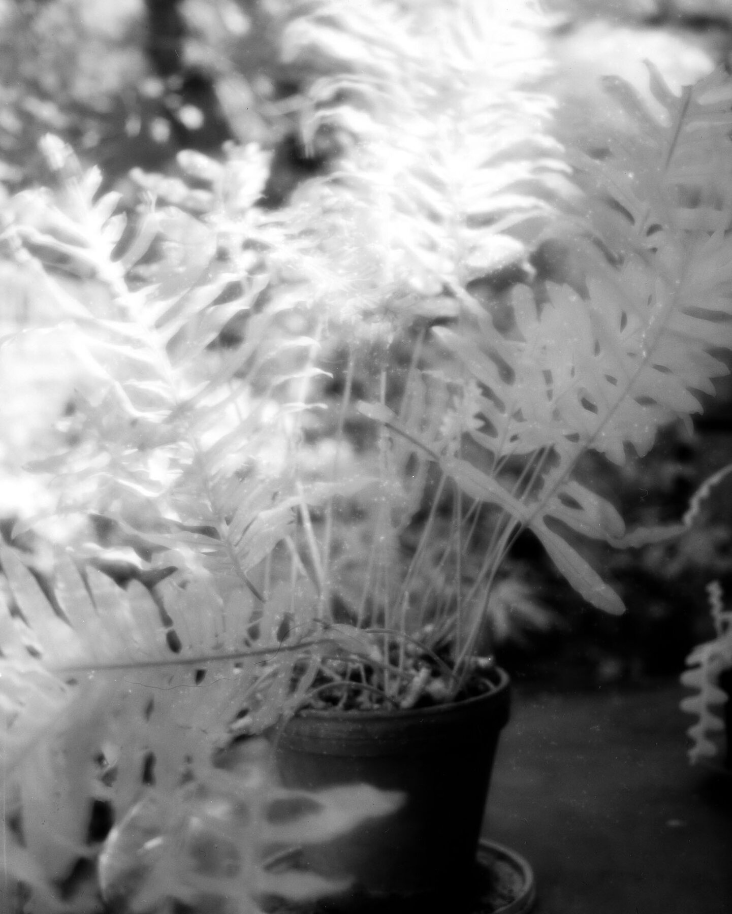

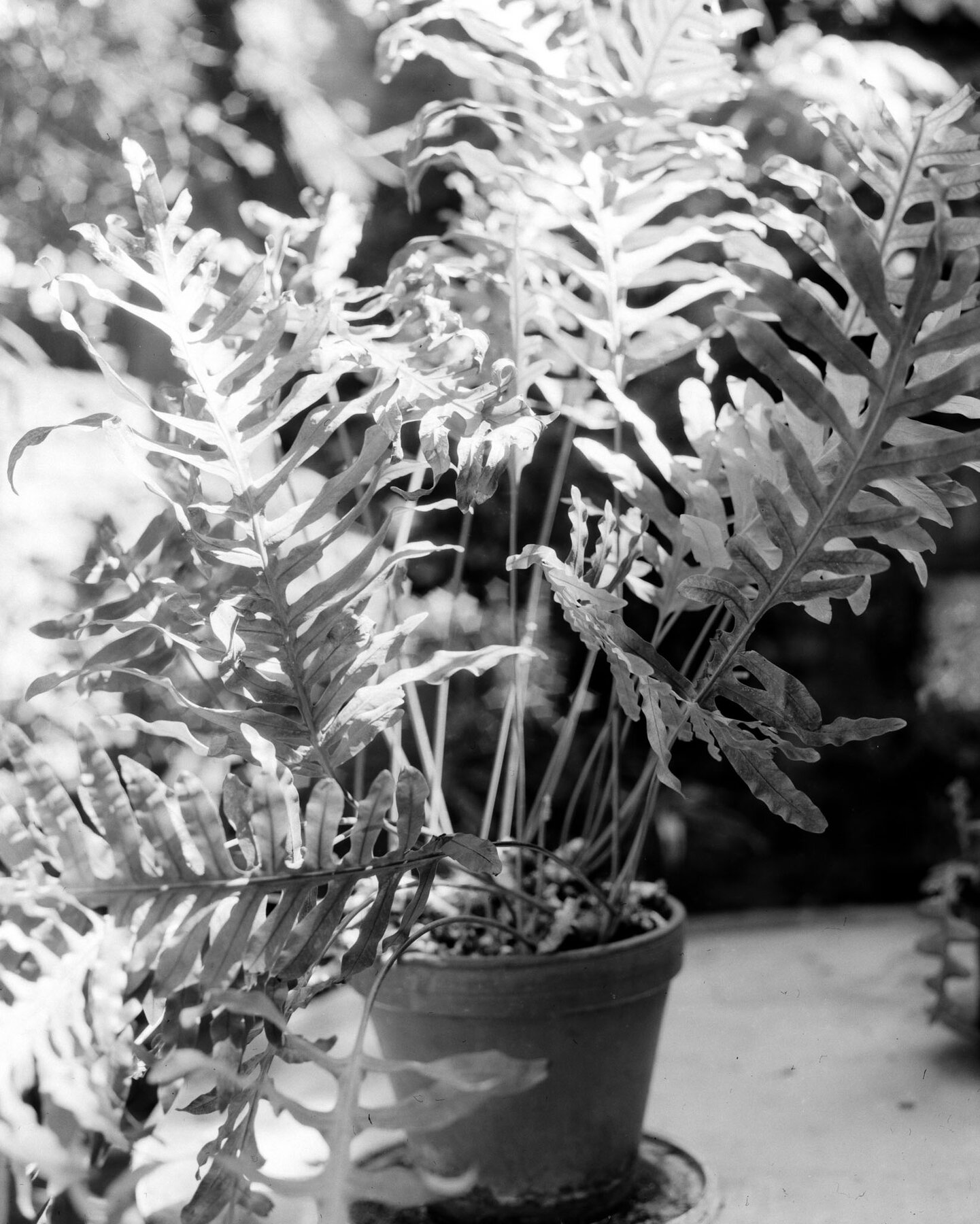

And here are the scans of the two that interest me, the no filter 25 & R72 (which was 8 seconds and had the wind start on me just as I hit the shutter):
I added ⅔ of a stop for bellows on the Sinar and an extra stop for the IR shot for reciprocity failure compensation, though that was included now that I think about it, so it was +7 for the filter and +1 on top of that to compensate.
In my eyes, your R72 photo is not bad both in terms of exposure and development.
All my IR negatives are thin as well. Typically I will try to maintain some details in the highlights: plant leaves in your photo. The rest of the photo might become darker, but that is ok with me. This generates more dramatic effects.
Yeah, your IR shot with the R72 doesn't look all that bad to me, either. You aren't going to get HIE-level density, at any rate.
I haven't shot much Efke (yet - I have about 20 rolls in the freezer) but this aligns with my Konica results, and those came out pretty well.
