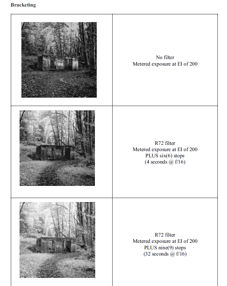

I've had no experience with that film itself - my experience is limited to Ilford SFX and one of the Rollei branded near IR sensitive films - but this excerpt from a presentation I did a few years ago might give you a good reference point for discussions:
There is always a healthy dose of educated guessing involved with IR sensitive film - because we really have no good ways of measuring how much IR is mixed in with the visible light we can see.
We can also do a lot at the presentation stage.
From a presentation I put together a few years ago, using Ilford SFX as an example:
