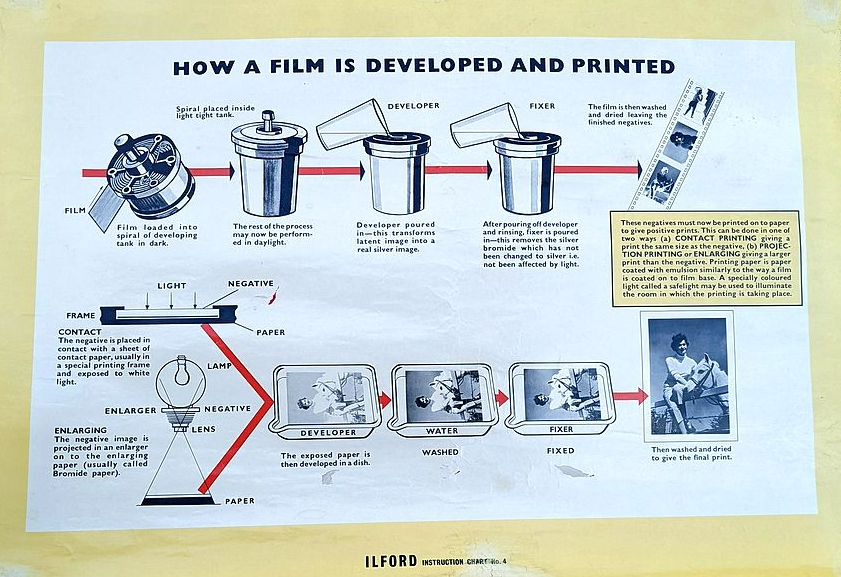

I'm thinking that that Ilford chart doesn't show an acid stop because all the vinegar in England was needed for the chips. :whistling:
And the pickled eggs sold in all our Pubs :D Chicken Tikka Masala from Indian takeaways is now more popular than fish and chips.

Oddly the "Kodak Reference Handbook 1", 1946, states for most films "rinse thoroughly in water", then fix, others it adds "or Kodak Stop Bath SB-3 (during hot weather), SB-3 is a Potassiun Chrome alum hardener. Kodak are recommending a stop bath with papers at this point but not for films, except the strong hardening bath in hot weather.
Part of the reason for the use of a stop bath with paper is the far greater carry over of developer alkali into the fixer if a water rinse is used, because at that time all papers were fibre based, a water rinse is sufficient with film.
