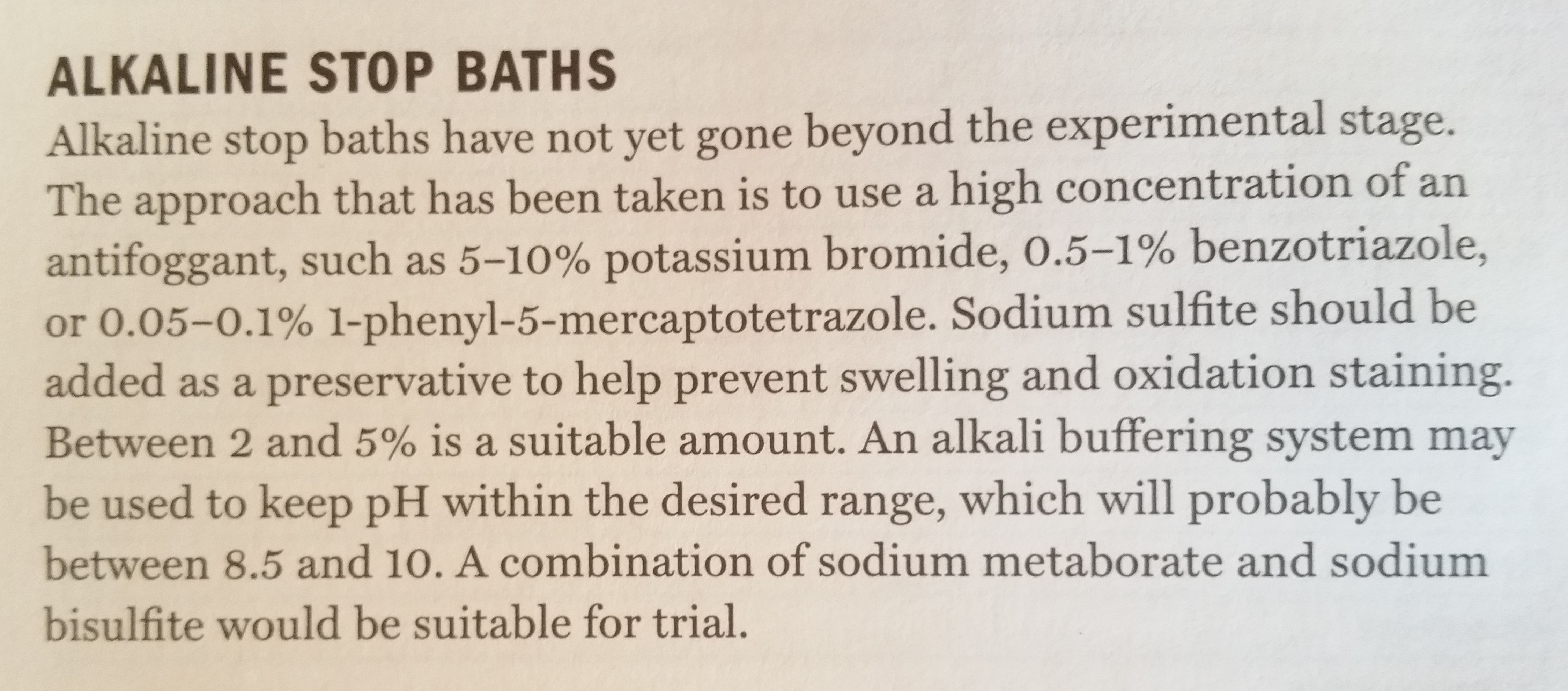

It's there on page 120. I'm away without scanning equipment. I can copy it for you in a few days.
I forgot I had a scanner in my pocket. The authors still don't say what the point is.

I forgot I had a scanner in my pocket. The authors still don't say what the point is.View attachment 316740
