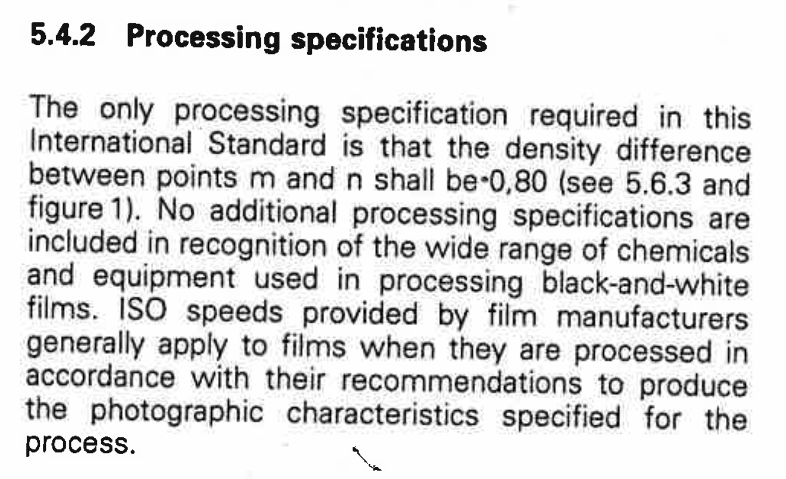

FYI: ISO speeds have a range of acceptability under the definition, depending on the manufacturer's specified conditions.

Exactly. Different CI specs give some level of variation in ISO speed for the same emulsion, but it generally has to be something the end user can achieve with a similar process. So, for instance, Copex Rapid has an ISO speed of some ridiculous figure (500?) in its normal use, where it's developed to a gamma well above 1, but if it were retested in a low contrast developer (such as is used to give "continuous tone" negatives for things like subminiature cameras) it would come out with an ISO speed between 50 and 80, at best.
Anon Ymous
Feb 7, 2008
3,661
Greece
Wait, apart from the specific density difference between these two points, isn't there a specific exposure difference between them, equal to 4,33 stops? I was under the impression that the developer used wasn't important, as long as the film achieved the claimed speed.
