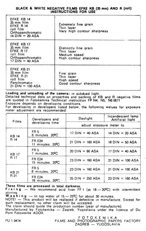

EFKE used to give a variety of EI's with their films when I first used them.
This is from the first rolls of Kb14 I used in the mid 1970's.
Ironically I shot Pl25 (old Pl14 Din name) at 50 EI alongside Tmax100 at 50 EI, and APX100 at box speed. and years later still use Pl25 alongside Delta 100
